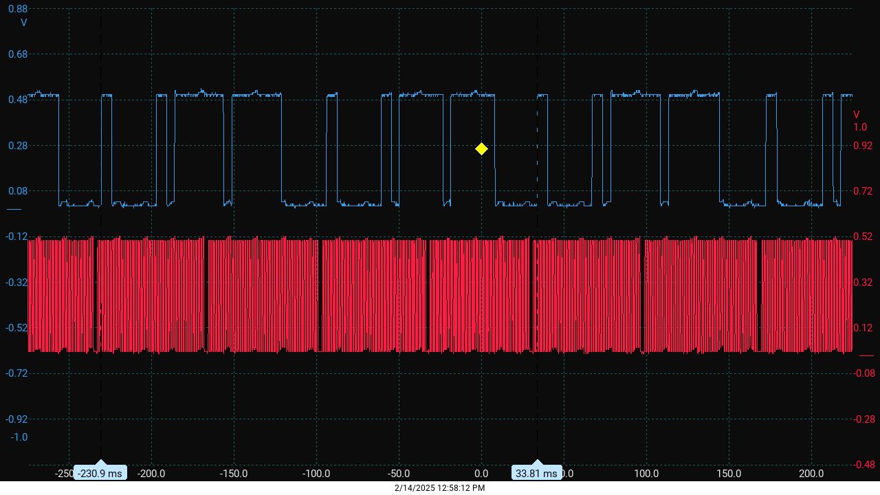

- I just pulled the cam crank signals on an o-scope and it looks good to me (but I'm not an expert)

The screenshot, is that when its messing up or when its running normally?
that’s normal running, I’m using a picoscope 2204A.
thanks
Now that you have a "known good" you need to scope it when it's running like crap and compare the two.
