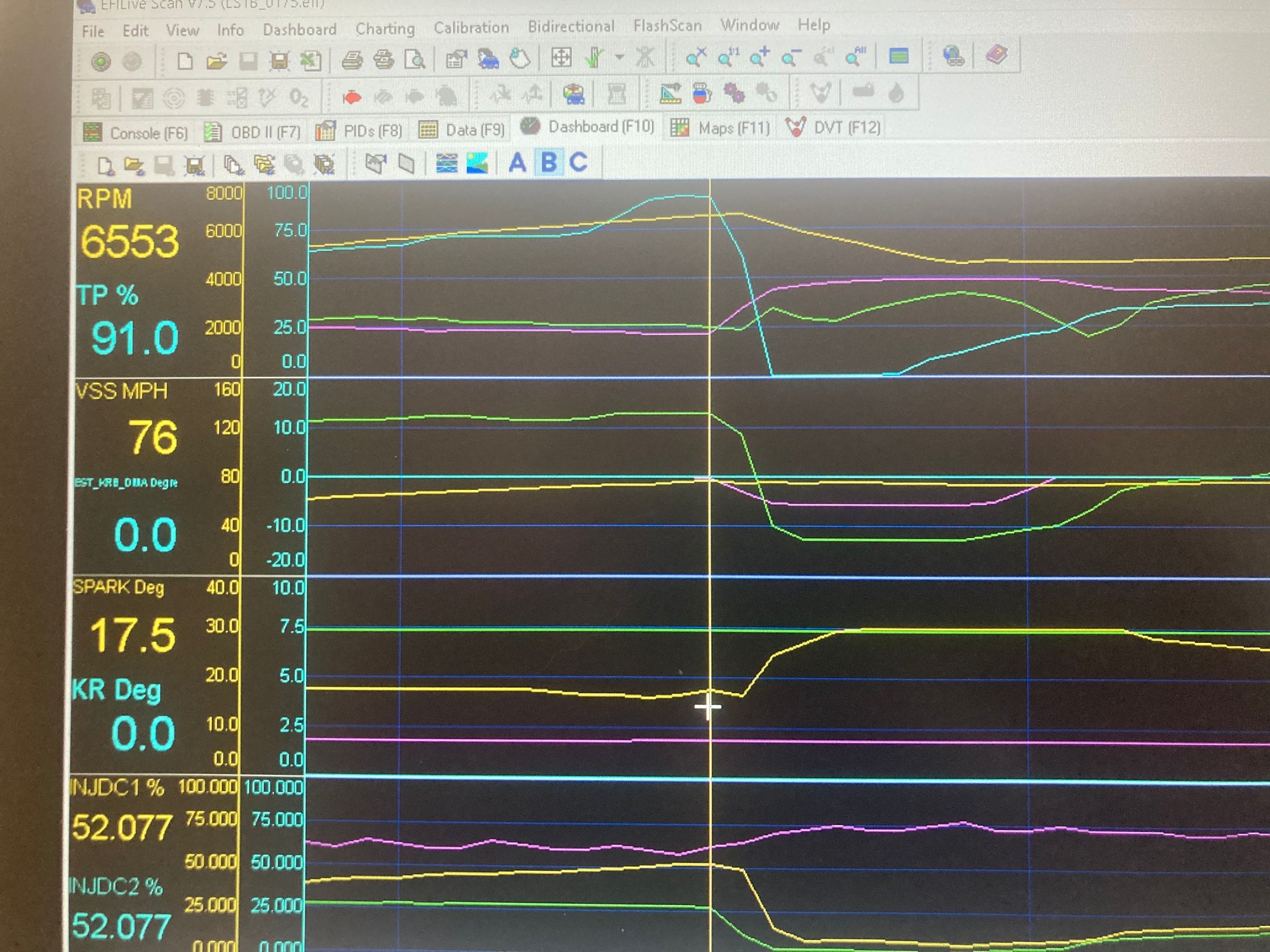

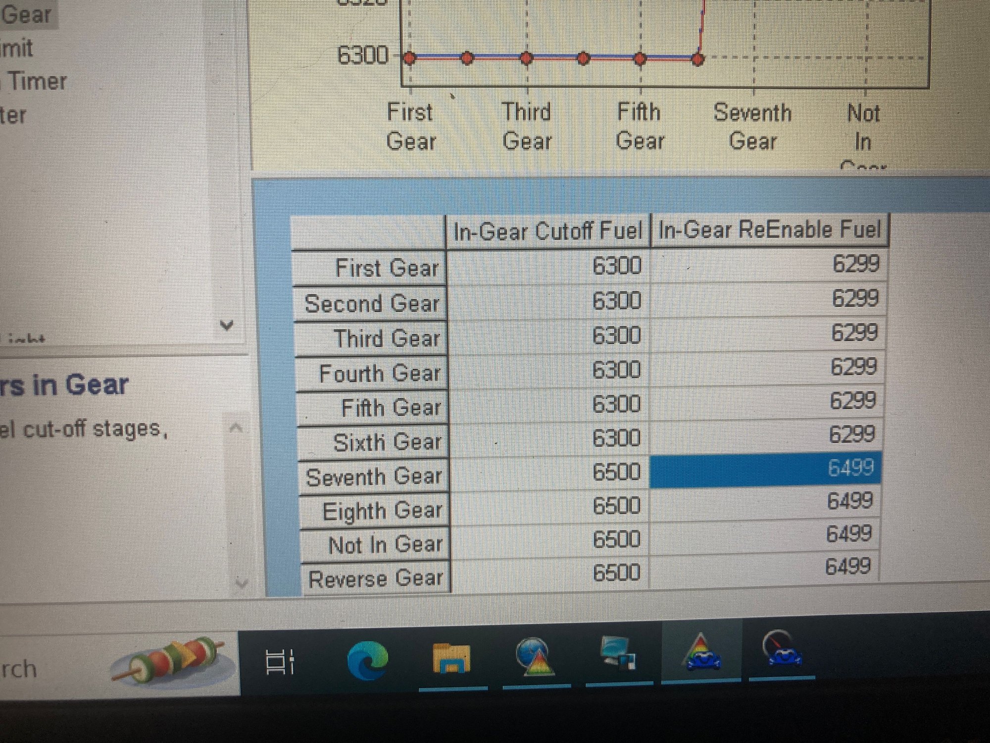

Just crapped myself, have stock cos3 pcm with cutoffs for fuel at 6300? I think it would have carried on going….any ideas?

Pretty sure it revved that high.....
it's 90mm Holley cable throttle body but shouldn't matter?
I'm ls1 turbo so some people don't like fuel cuts anyway? But it didn't happen.....
as a failsafe just dropped timing to 12 across board at 64000 ish, how low could I go?

The factory PCMs don't seem to react quickly enough to keep up with the rate of rpm change with a turbo motor. I have mine set for a 7000rpm limit, and have seen 7300 on the scanner before it cut off in first and second gear. That is with an Hptuners 2bar COS on a p59 pcm.

Interesting … I saw ~7600 once with my limiter set at 7200, and was not happy, given my SBE. No turbo here, but a healthy NA motor in a 2400 lb car probably gains revs just as quickly.

Fuel cut rev limiters really suck at fast response. Unfortunately, that is what the factory computers are stuck with for emissions reasons. There are custom OS options to get around this if you don't have to worry about your pcm playing nice with a bcm, but not everyone has that option.

I think someone modified a 12587603 image to work with boost and use dwell for spark cut. Most of the modifications are done in empty flash areas. It should still work with the BCM.

I just tried last night reducing the gear and p/n limits to 3000 then drove it slowly up to 3000, Bucked like a mule at 3000 rpm so it works....?

It depends entirely on which platform you are running. On my GTO I would lose at least 2 BCM functions if I switched from the correct 7604 OS to the BoostOS modified 7603. Username Phoenix, who compiled a 7604 xdf with an e85 flex patch tried the 7603 on his gto, so I tend to believe him about which incompatibilities he found.
