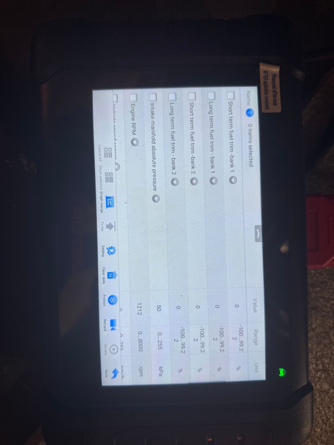

Started the truck last night and it fired off perfectly, zero hesitation (cold start, no prior starting attempts). Ran and idled great for about a minute. Then it choked and died, just like before. I checked my coolant sensor readings and confirmed the sensor is reading accurately - 15C cold reading and rose a couple degrees after running.
I've attached a couple pics of some data off my scan tool. Honestly not sure if any of it is useful, but grabbed the info just in case.

MAP sensor will make it dump fuel, verify that also.

If it runs fine for a bit then acts up and starts overfueling consistently then it's either a pcm/tune or sensor issue... almost sounds like as the pcm enters closed loop it reacting to a sensor that's faulty or programed incorrectly.
To verify O2 sensors are on the right side unplug one and look at the data
Verify map sensor reads near baro with key on engine off.
I wouldn't worry about fuel system holding prime as long as pressure is correct running
When I unplug one O2 at a time, what info am I looking for? What would indicate to me that the O2's are acting up? I'm pretty sure my map sensor (key on, engine off) reads around 100kPA but will confirm later today.

Unplugging the O2 sensor on one bank and seeing if the same side in the data stops reading will tell you if they are wired up to the correct sides
