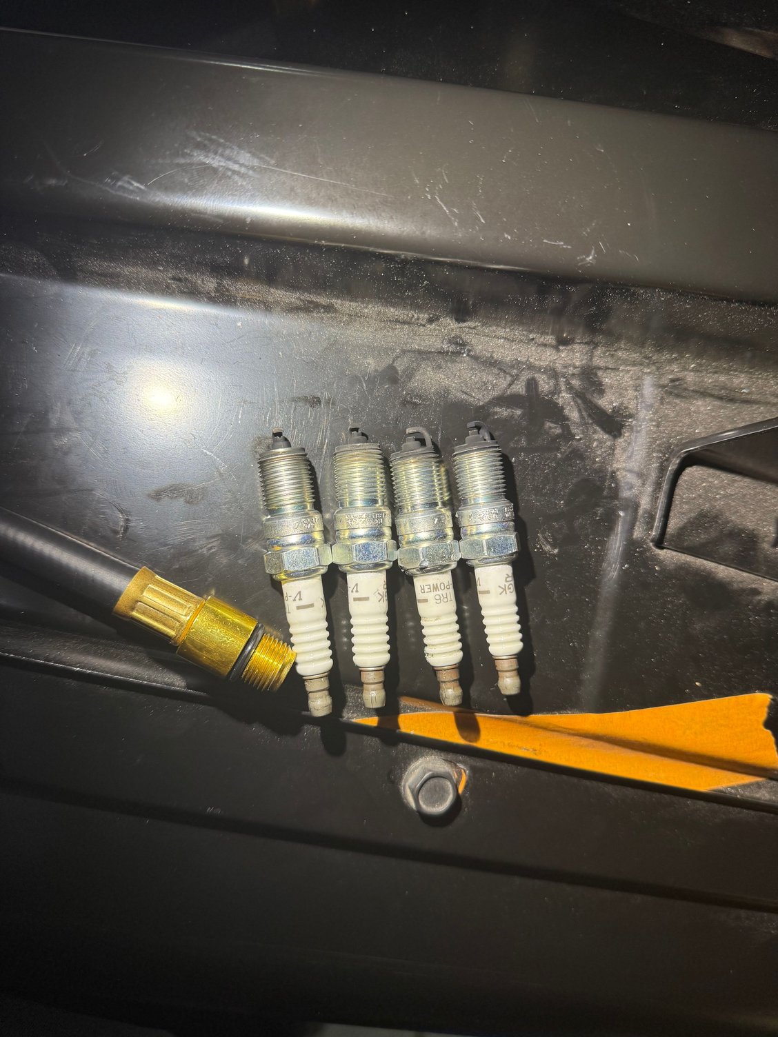

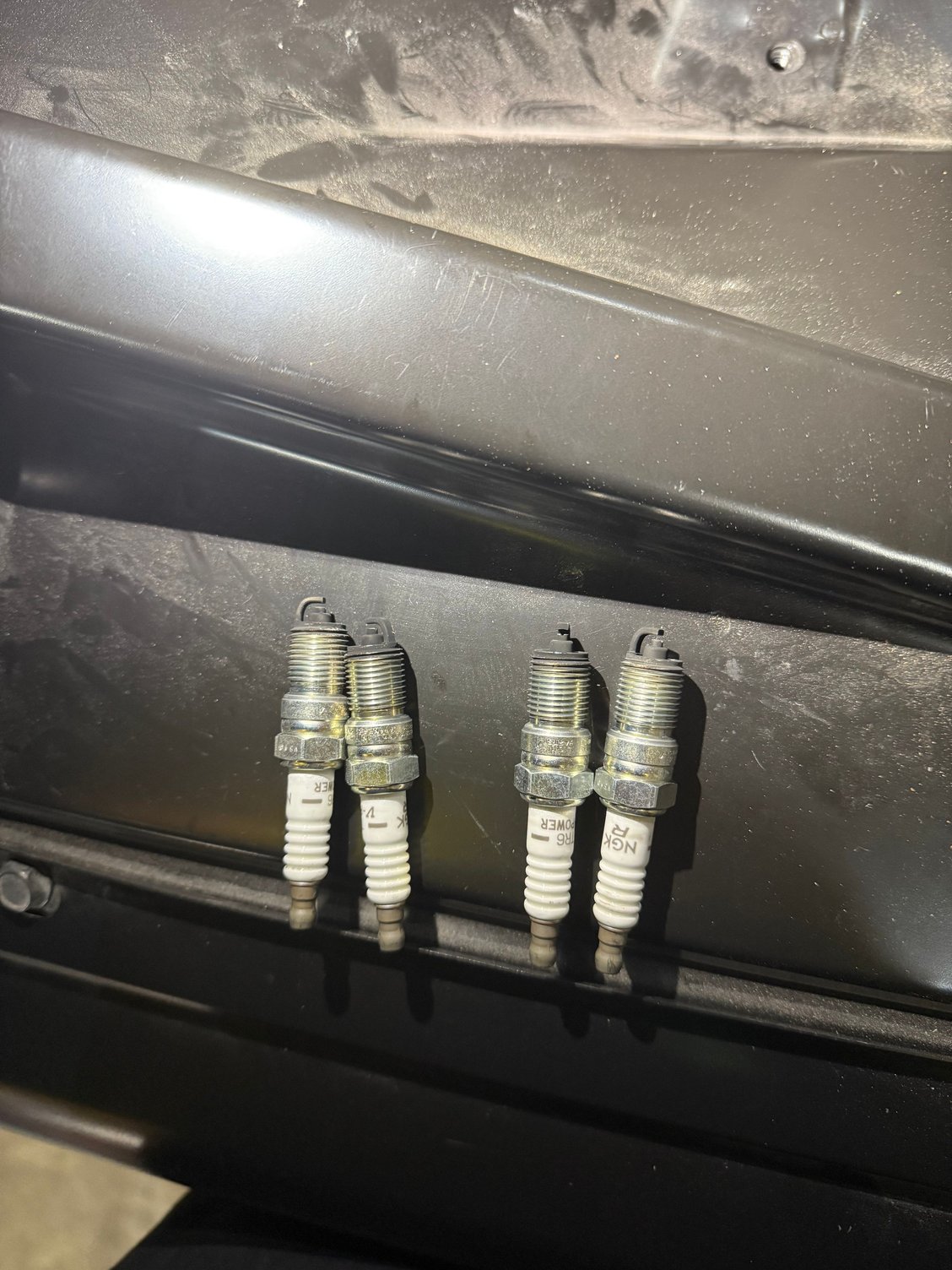

Something @68Formula said above, reminded me that after running the engine the best you can, remove at least a couple spark plugs, or even all to compare them.
If the mixture is super rich, they will be very black and/or "wet". Very lean and they will be very white. Take some out and post pictures here. Some people here (not me) are very good at reading plugs.

Here's some photos of the plugs. Photo 1 is driver side/bank 1. Photo 2 is pass side/bank 2. Not really sure the condition of the plugs really matters much now in determining my issue, as the leakdown test failed. But either way, they are definitely fouled very bad for only having less than a few minutes worth of run time.

Should put in some fresh ones, so you can get a better understanding. The fact they are fouled could be contributing to the symptoms or making them worse.

These actually were fresh ones. After getting my PCM back with the fresh tune, I did maybe 3 attempts to test start it with no luck. I then drained the fuel, put in fresh 91 octane, new plugs, and these are the result after a few more additional test starts
