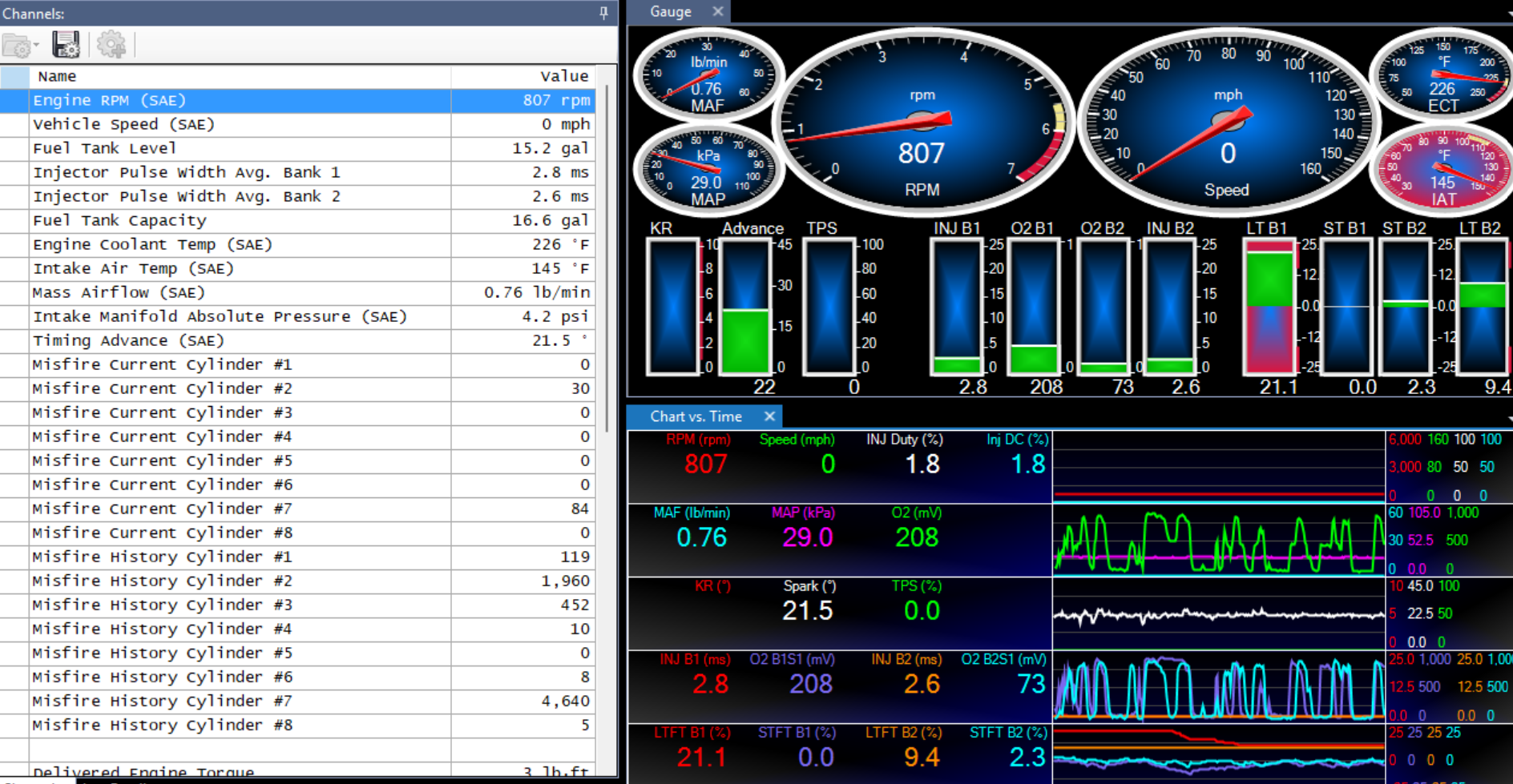

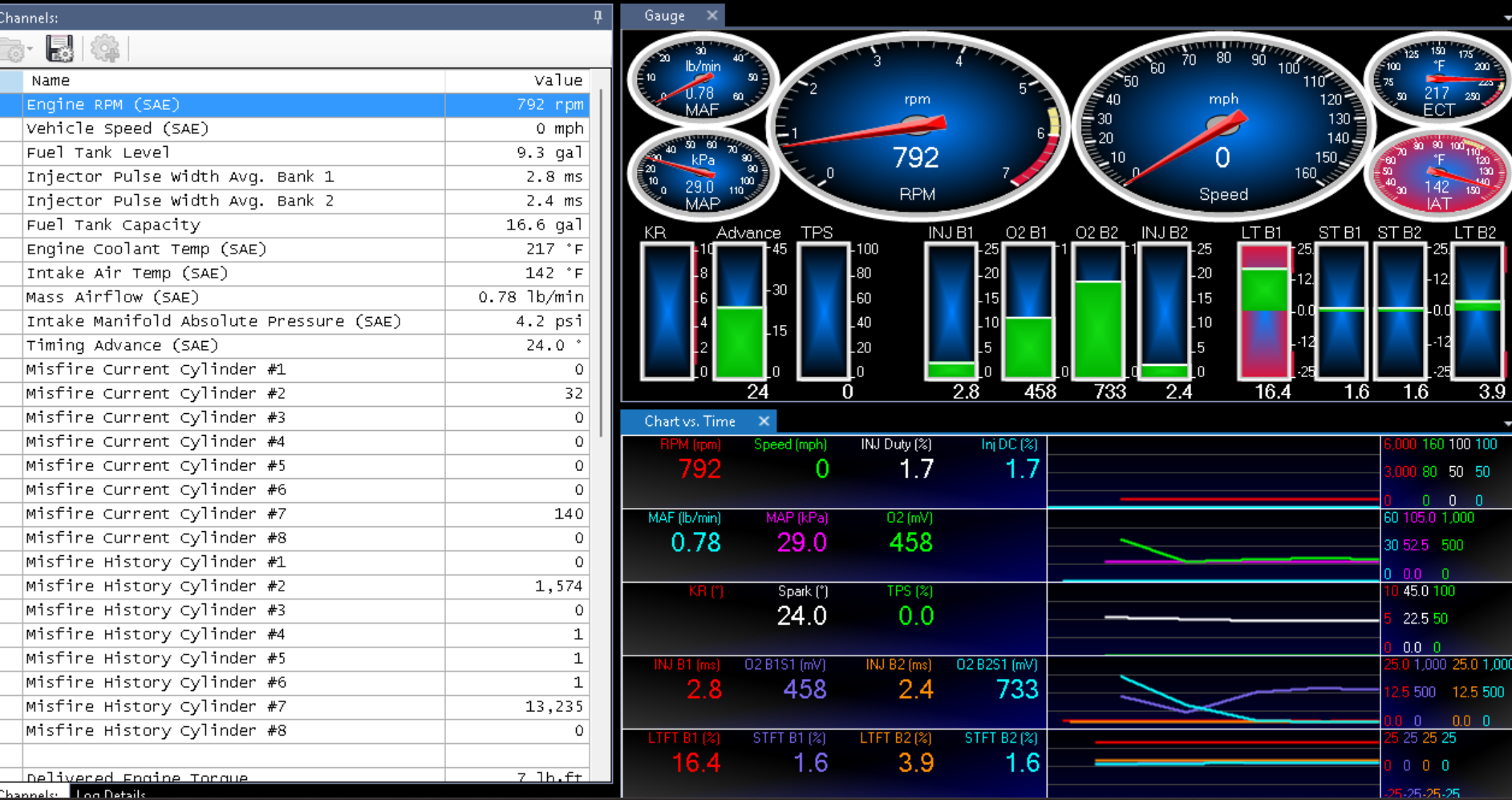

I am see misfires on both banks, mainly on cylinder 2 and 7. the car is hesitating under load with a ruff idle popping . i am pretty new to hptuners and don't really know what to make of the data i am seeing. Are there any other channels i should be looking at in hptuners?
i noticed the iat seems high to me but i was idling when i saved that.
i am not sure what LT B1 is? its showing red

Bank 1 LTFT(long term fuel trim) is adding a bunch of fuel.

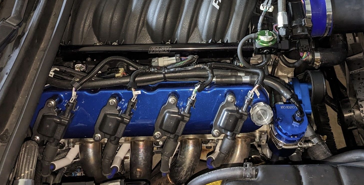

I had replaced the stock motor in my C5, and one night it hit me that that the harnesses were the only thing that I hadn't ruled out yet. Everything else was either proven good before the motor swap or ruled out from testing or replacing. I don't recall which harnesses I used at first, but they were from an aftermarket vendor.
For some reason I thought I needed an aftermarket harness to use gen4 coils in a gen3 car, but the ones I'm using now are OEM, part number 12621253.
Newer coils because Holley valve covers... Had 'em painted the same color as the car. This is the old/flaky wiring:

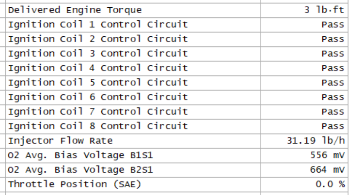

i was chasing misfires on cylinder 3 with no luck. On Monday i drove it to work after changing the spark plug on 3 for s/g's because i already had the plugs. it drove fine in the morning and was 75 degree's out. On the way home it was 89 degree's outside and the car started misfiring again. i realized i didn't notice the radiator fans on come. So yesterday i hooked up hptuners and turned on the fans with HPtuners just to make sure they worked, which they did. i noticed the coolant got up to 223 idling in the driveway so i turned the fans on with hptuners again and noticed the temp come down. So i am not sure if the fans are being told to turn on but they work. coolant temp sensor?
also noticing:
IAT is still high
LTB1 is high
misfires moved to cylinder's 2 and 7
injector flow rate low? 31 lb/h and i think it should be 36lb/h. would that cause misfire?
