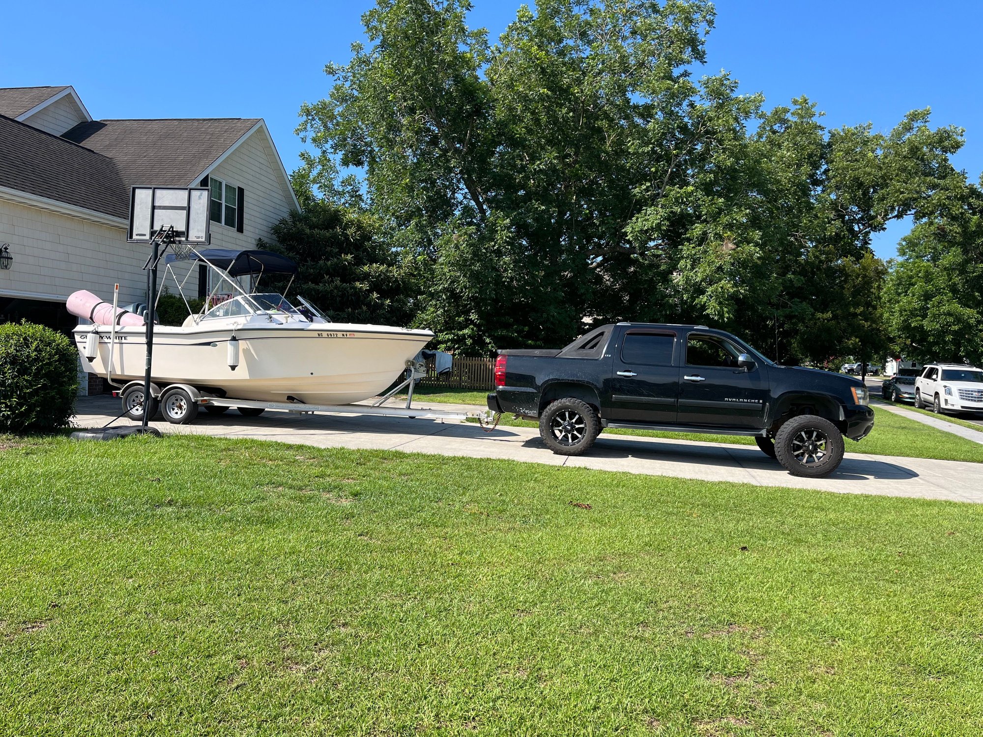

Havnt been on here in a long time but the camaro still lives, you can see it in the street. It normally lives in an enclosed trailer for the past 5 years waiting for me to stop having kids.

A SWAG.....
"service stabilitrack",
Different diameter tires ft to rear?

They are all 35x12.5 R20s, but they are different brand front to rear, but both measure very close in size.

Why does the first photo of Avalanche appear to show extreme tire diameter mismatch ?
