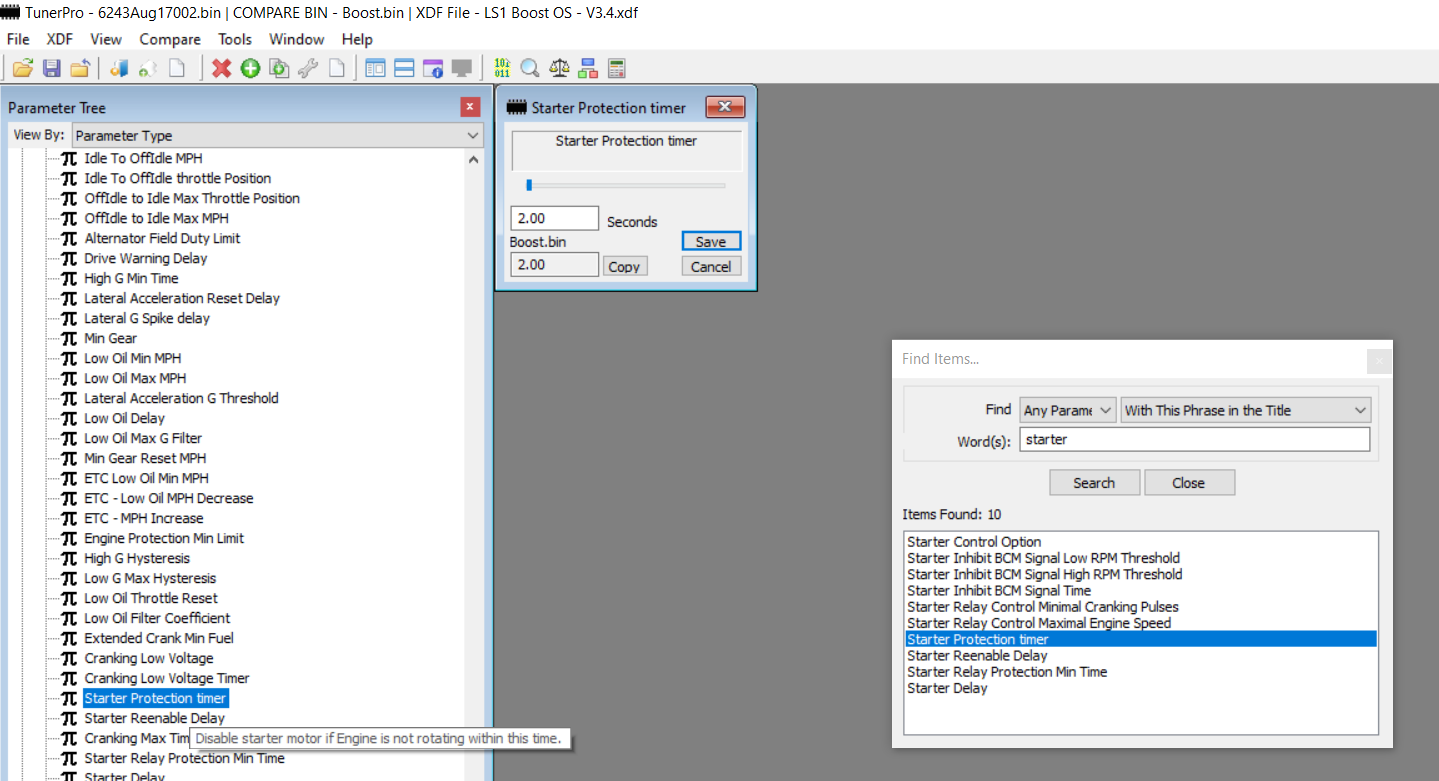

There is a starter protection timer that shuts the starter down after 2 seconds if the PCM does not see the motor spinning. Do you have a scanner that will let you watch the RPM through the PCM as you crank the motor? I`m wondering if the PCM is not seeing a crankshaft position signal? That would explain why it cranks for 2 seconds then stops and repeats.

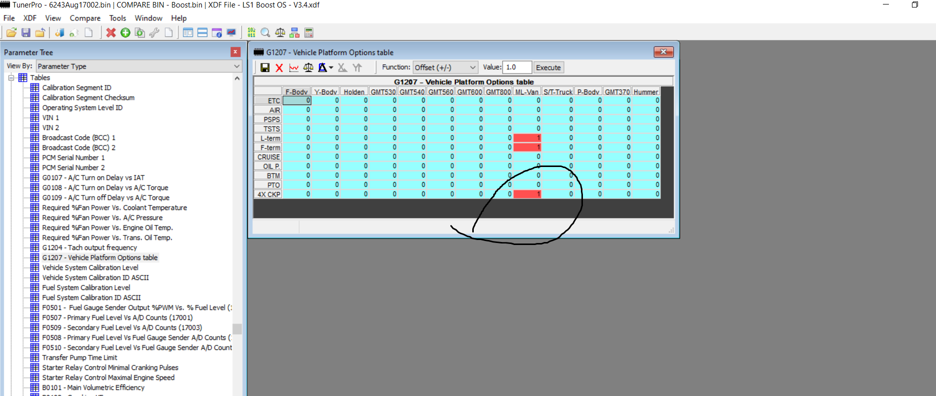

Found it the crank sensor was set to low resolution which would cause it to look for the wrong crank sensor signal. Try flashing the updated bin, you should only have to do a write parameters flash

Try this one. I updated from a van in the options matrix to the GMT 800 platform as your suburban donor was a gmt800 platform

That should not change the spark or fuel tables, but should correct the rpm running up to 2800+ as it should make the electronic throttle control happier
