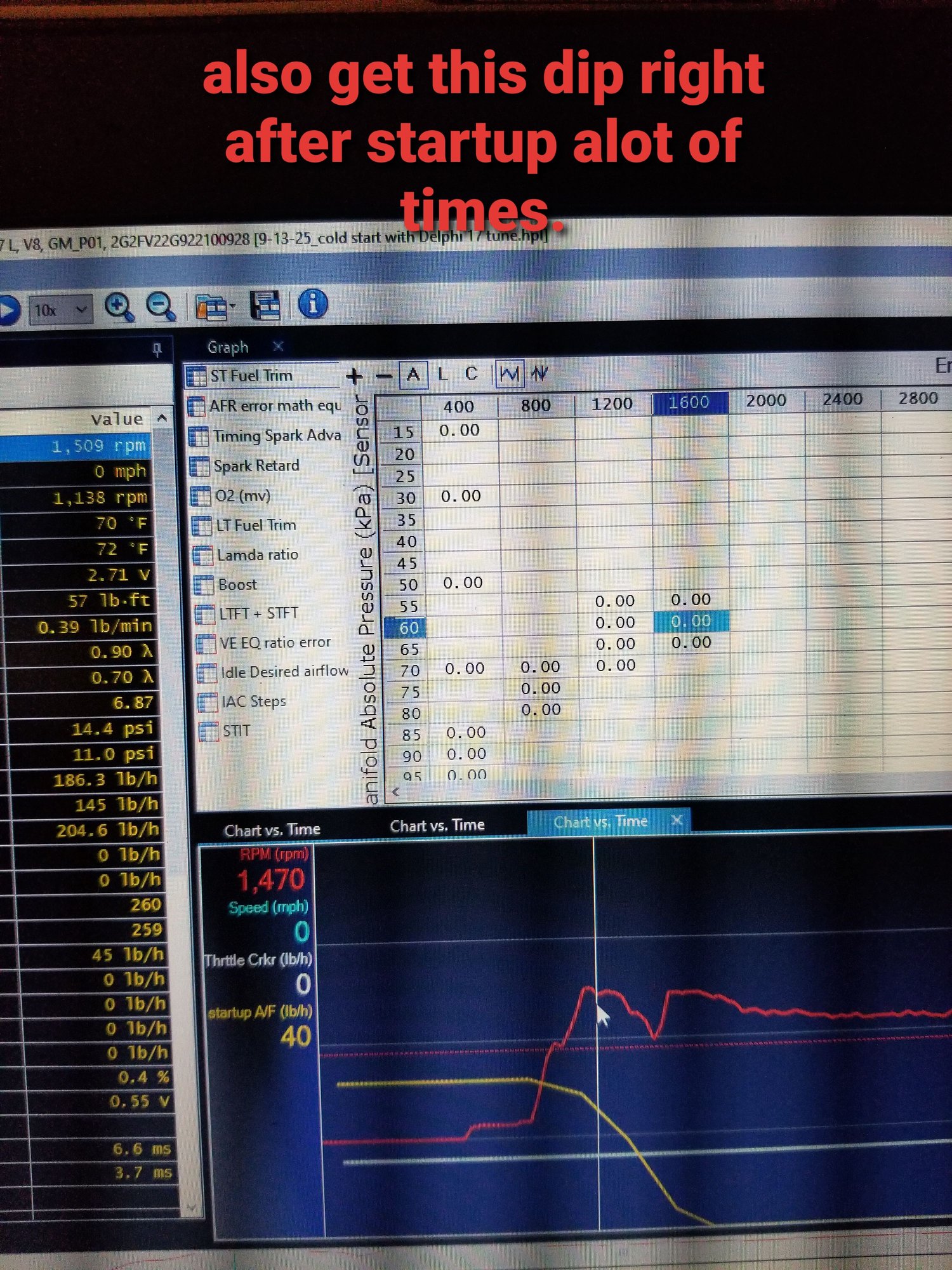

I'm looking for some help on getting my car to have a better cold start. This is only a issue with the first cold start of the day. As I spin the engine over, it takes about 2 seconds before the engine very slowly comes to life. It flares up very slow. Now if I shut the car off immediately and restart the car, it fires up perfectly. The BRAF and IAC counts are dead on.
I am running e85 and the fuel pump is a Walbro 535 - No Check valve.
Has anyone else experienced this and is there anything in the tune that I could modify to correct this issue?
thanks

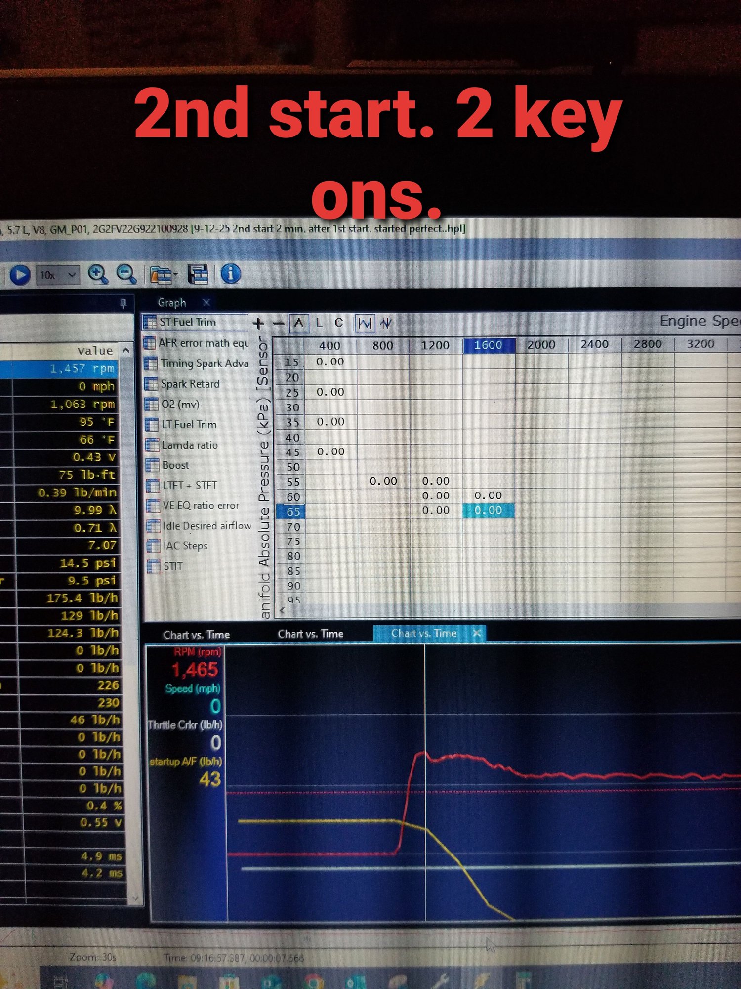

Here is a cold start from this morning and a few days ago.
The 9-15-25 Delphi 17 has 55% added to the FA Mult stage 1 and 2. The 9-11-25 Delphi 16 tune has 40% added to the FA Mult stage 1 and 2

Heres an update for anyone following: I did what NicD said to do and changed the 1st cell in the MAF table to 15 g/s, added 10% in the OLFA EQ ratio table up to 86 degrees, and 5% in the 104 degree column, I removed 15% from the FA Mult stage 1 and 2 table, So now I am sitting at 40% over the stock FA stage 1 & 2 tables, I also doubled the Prime pulse mass, First Pulse mass and Second Pulse mass. Not really know how this was going to affect the startup.
Results: 1st cold start of the day, .76 seconds of key on to fire, once it started to fire up it took 1.29seconds to flare to 1480 and start to taper down. No dips in the RPM after start. I believe bumping my Friction initial AF up fixed the RPM dipping problem.
So this is best cold start up I've had with this setup. Still room for some improvement but I'm happy these changes put me in the right direction.
I did shut the car off, waited 20 seconds and started it back up and it fired immediately, rpms flared straight up to 1460rpm and tappered down nicely without any huge dips in the RPM.

The dip in RPM after a flash is from the MAF not having failed over yet to SD, that is fixed with the larger value in the MAF table's first cell. Once it's been running and stopped as long as power hasn't been removed it will still have the MAF code stored and it will go to SD immediately next time on start up. I've never had to bump Friction initial on any Gen3 PCM before, not saying that didn't help but that's usually not the root cause of an initial RPM dip.
