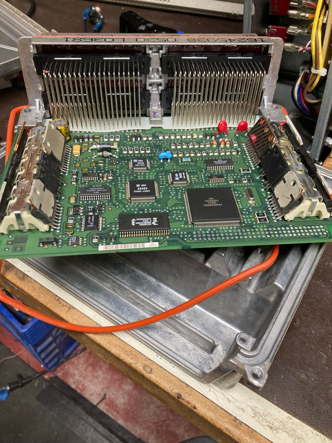

Anyone??? I know its an unusual problem when tuners from 4 different states have never heard of it! I will say I've learned something new today. A friend of mine here on Tech called me and told me that he has seen this happen only 1 time in all the years he's been doing LS stuff. Said it was a battery within the PCM. Until his call, I never knew there was a small battery inside the PCM!! Apparently a 2032, or similar sized little battery. He told me to turn the key on in the car (DO NOT START!) and leave it on for 2-3 minutes. Then turn it to the off position. Then immediately try to start the car. It fired for maybe a half second, as usual. Then the throttle shut and it stalled, as it usually does when ambient is under 66°-67°. So I learned the PCM has its own internal battery. I am leaning towards something corrupt in the MAF tables when ambient is under that 66°-67° mark. I put my little 10"×5"×5" electric space heater on the floor about 1 foot away from the front bumper. Let it run for 1 hour, turned the key, and car started as good as any new car, as it usually does after the pre-heat. Very frustrating.....

Based on the totality of circumstances it doesn't sound like a tuning issue to me, unless maybe it's related to engine coolant temp (IAT should read at ambient after 5-8 hours of sitting, when you say that it will still fire up OK, but ECT may still be above that ~67°F threshold depending on where it's parked).
The throttle snapping shut sounds like a failure of the DBW throttle electronics, possibly triggered by the unit dropping to a certain temp. Could be wiring or internal fault. I can't think of anything in the tune that would tell the throttle to completely shut off idle airflow based on an ambient temp reading.
I wasn't aware of any button-sized battery inside the PCM. First I've heard of that. Are you sure this isn't being confused for a capacitor?
One of the things missing from your initial explanation of the issue is a history of when it started. Was something changed with the tune or setup that triggered the condition? Did it come out of nowhere? Has it gotten worse over time or just been exactly the same since it appeared?
My gut tells me that if every tuner is completely unable to find the source of this, and you're dealing with the best of the best tuners, then the problem is likely not in the tune itself. Has anything that's been done by any tuner had any impact on the issue at all? Even a little? If not, I think the problem is a hardware or wiring issue.

Why not take a blow dryer or heat gun and try and heat up individual sensors to see if you can trace down the problem to a specific one.

Along with a can of freeze spray. Commonly used for troubleshooting temperature based electronics issues.
BTW, no battery in a P01. I just took one apart. 4896 to be exact.
That's what I figured. If there were batteries in these PCMs to fail, at this age it would be a common condition with pretty well documented symptoms. So we can scratch that off the list.
I like the ideas mentioned above regarding using heat/cold on specific sensors and components to see how/if the condition changes. The more data that the OP provides, the more I feel that the issue is not related to the tune but rather a hard electronics/sensor or wiring related problem.
