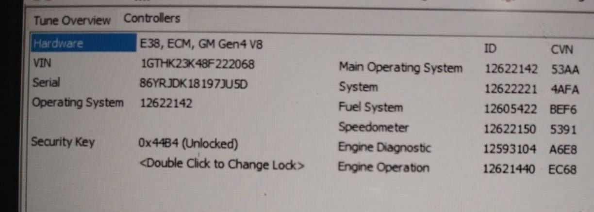

Hi everyone,
I need the file with Cruise Control enabled or any way to enable Cruise Control on my file
by this way the System segment for Segment Swap).
I already wired the cruise switches and BCM shows the button input ? only ECM needs the cruise enabled.
I'm looking for a stock HP Tuners .hpt file (or System segment) for:
- Vehicle: GMC Sierra 2500 / 2008
- Engine: 6.0L V8
- ECM: E38 (GM Gen4 V8)
- Operating System ID: 12622142
thank you
attached the pcm file

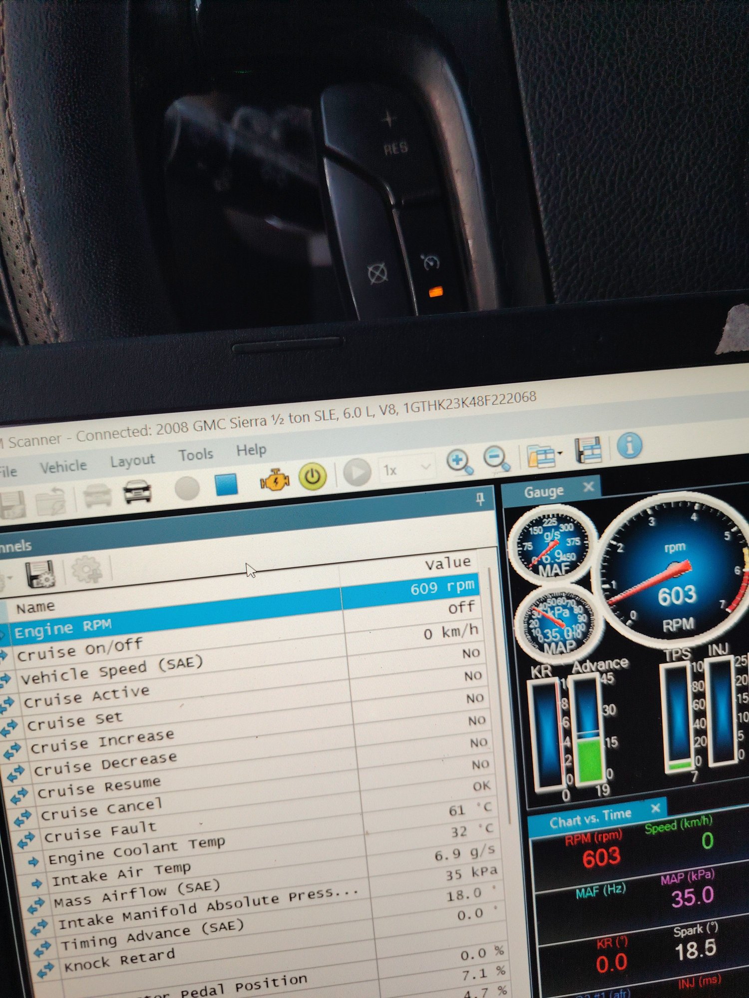

Really thank you but I tried this system (12619407) before and it didn't work I will try it again.
I tried all this system 12622216,12622222,12619407,but all not work
I test the body control by launch. The scanner knows the cruise control inputs. But the PCM by the scanner don't see any inputs
Thank you agine

Hi everyone
I change BCM with another car cruies control work fine . Anyone can help me to reprogram the orginal BCM to enable cruise control
thank you
