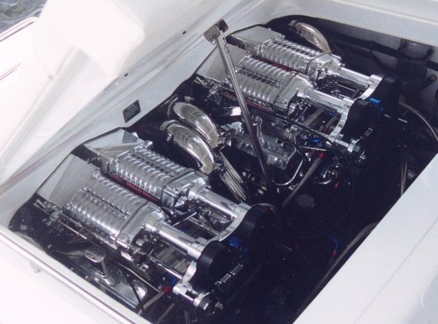

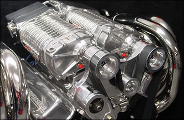

I'm working on something like this right now
and if i had a boat maybe this
