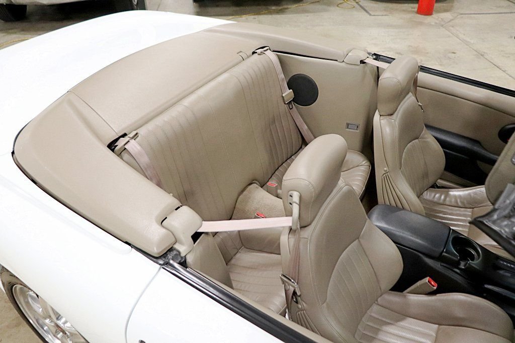

Are these supposed to light up when the door is opened? (small lens in rear interior panels by the speakers) Mine don't, what's the easiest way to get to the bulbs if they are lighted?
Thanks Ron

They are definitely supposed to light up when the doors are opened. I suspect there may be a way to remove the lens to replace the bulb, unless there is a way to reach down the backside of that panel. Mine's on the lift for the winter, so I can't check to verify. Maybe check the owner's manual?
If both sides are out and the front courtesy lights are also not working, you might check the fuse.

Both are out but fronts are working, guess instead of asking questions I should just get to dropping the top and see if I can get my big paws in there!!!

The bulbs could have a number of issues:
- They could be burned out
- The interior lights dimmer could be all the way down (very common)
- The Exit Light and Delayed Illumination could both be programmed off (see Owners Manual)

Doesn't the dimmer on the headlamp switch control ONLY the brightness of the dash lights? I didn't think about a BCM malfunction as a possibility, nor did I know that there was any programability of its behavior.

OK those interior lights pry out from the front edge. Very fragile and use something very thin. Poor design for sure, bulbs were just sitting in there loosely wasn't enough tension to make contact.
