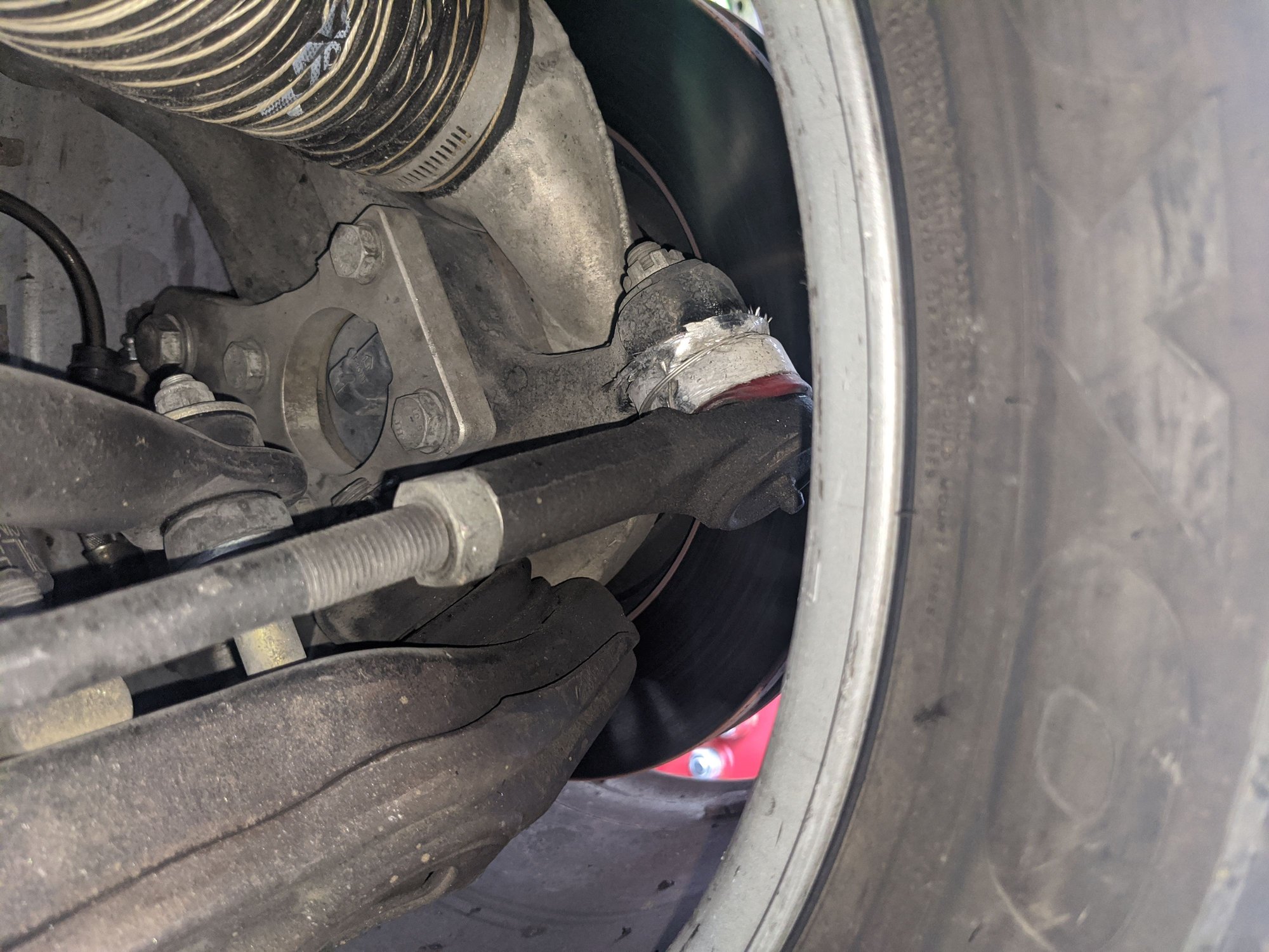

I think you misunderstood what I was saying. The car is on the ground, so this is about as good of a pic as I can get.
See the gap between the duct and the rotor? It doesn't fit tightly like the NASCAR duct, but a duct made for 13" rotors would. These are for the 12" LS rotors I suspect.
Old May 27, 2020 | 03:18 PM
  #222
.boB's Avatar
Joined: Jan 2014
Posts: 897
Likes: 33
From: Colorado Springs, CO
Ahh, I see. You are correct. With any ducting, eliminating gaps usually improves function.

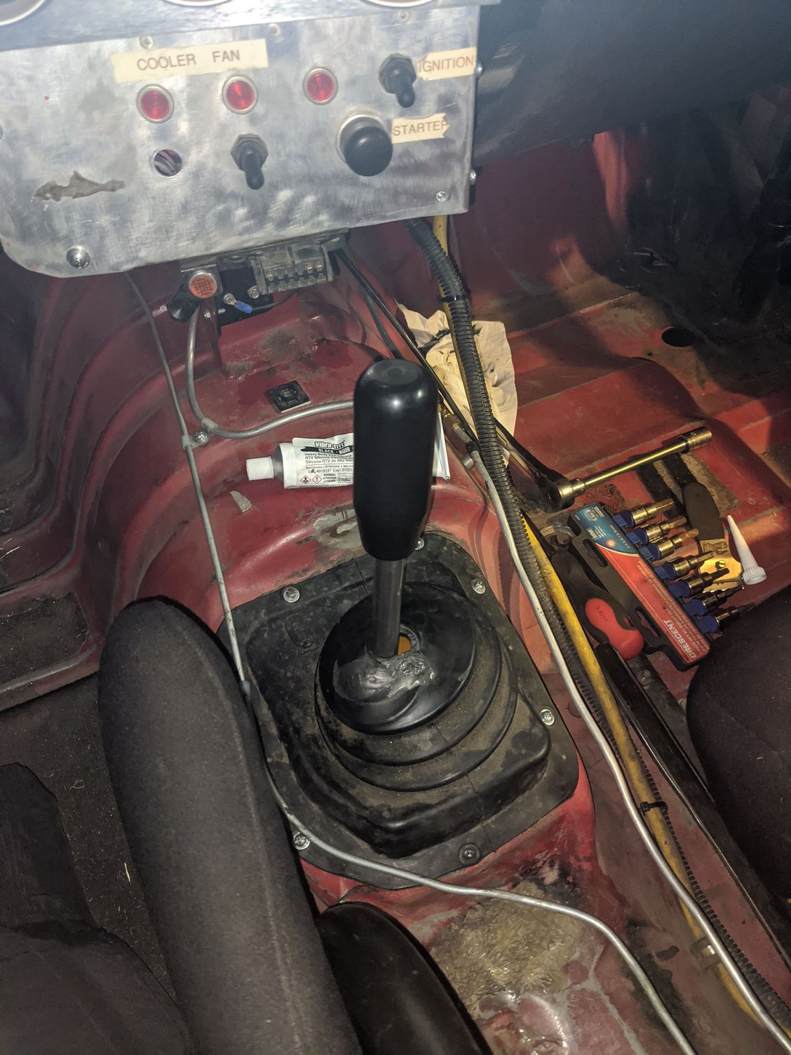

This shifter is much tighter than the B&M, really hoping this cures my 2-3 missed shifts.
This thing​ really finds its way home and with my Blainefab **** is miles from overly tight. There was significant slop on center with the old B&M, could have just been worn out. It used to work well, but just at a standstill making vroom vroom noises I'm liking this MGW a lot better.

Not sure how long this boot will last.
I had to stitch up a rip too, covered in black silicone as you can see.

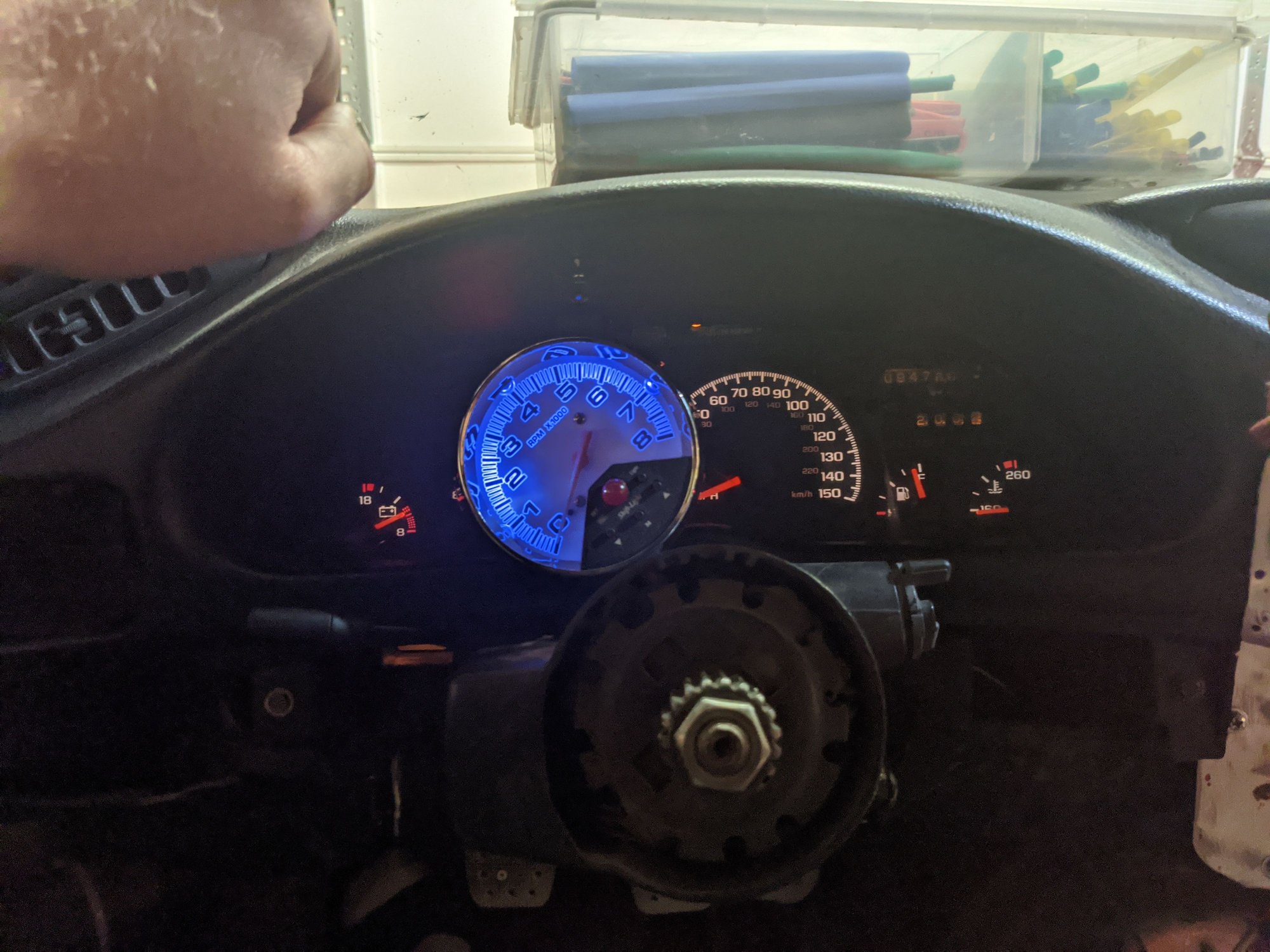

Seeing how the factory tach died with no filter, I figured the smartest way forward was to snag one off the shelf. Enter my 100 year old Summit tach originally installed in my Crown Victoria.
It lights up a different color every time you flip the ignition power on and off, sometimes splits the colors left and right. Very fitting for this class. I underestimated my reliance on the tach my last time at the track (which was my first without a good tach readout). Next will be chopping some LS knuckles to play with my C5 rotors and borrowed brake ducts. I don't think the Corvette hub adapters will be ready in time for the next race unfortunately. Also unfortunately for Rob, the guy from whom I'm borrowing said ducts, this shouldn't prevent me from whooping his ***.

Tach works. I swapped in my spare ECM and suddenly the speedo was working. Put my chip BDZL with adapter in spare ECM and no go. Put just BDZL in spare ECM and good. Put spare chip BDLD in current ECM and good. Put BDZL in, no adapter, current ECM no good. Try spare chip with BDLD current ECM no good. WTF.

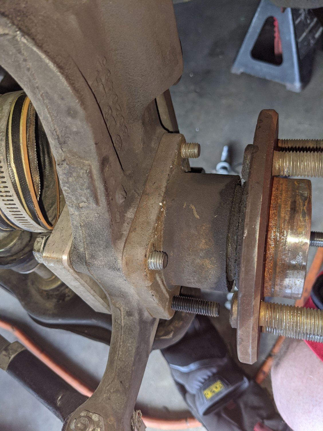

I had a decent weekend. These hubs are shot and gave me tons of knock back. My C5 hub adapters are at the plating shop now, so they're already machined. I can't wait. This is going to be another game changer. Just like the MGW. I never missed a shift all weekend or in Friday practice. And with the new syncros and whatnot I can finally bang gears as hard as I want with no gear of missing ever. I love it. So hubs are next like I said and once that's bulletproofed I'm pointing the cross hairs back at my brake setup. I may have to abandon the Raybestos pads as I do get the occasional fade. Saturday I had to settle for first loser, but in today's first race toward the end I pushed way way deep into a turn because the brakes just checked out. Luckily I had enough margin and was able to hold the lead, but I need dead consistency so this crap is coming to a stop. I also won the second race today too so pretty happy about that. My strongest competitor missed 2nd on the standing start, I was able to occupy his real estate, and get in the lead by turn 6 (was an invert). I'm seeing when the Autometer reports 250, the factory temp gauge is reporting around 220. This must explain why running this hot all these years has never killed the motor. The Autometer is not in the factory location, seems the back half runs hotter than the front half. Definitely going to have the cool suit ready for the next race weekend too.

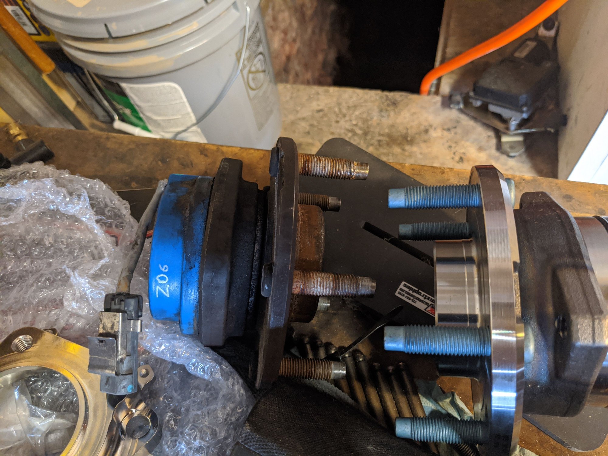

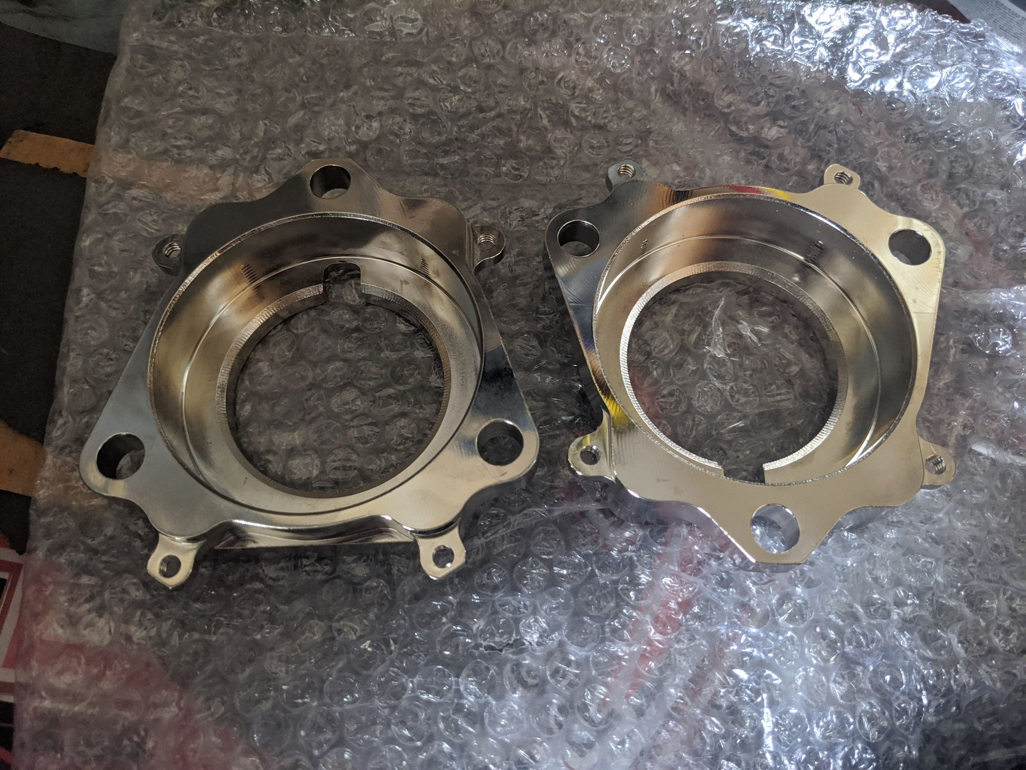

My next improvement just rolled in.
For the time being, I'll sandwich my old C5 plenum ducts between the bearing and adapter but when I go to the Stoptechs I think the plenums on the car now are what I want. I can't wait to experience no knock back. These are the Delaney adapters. I have C7 X Tracker hubs in the mail, just need to figure out which ARP studs to press into them. I want the kind that aren't threaded all the way to the end.

Holy crap the C7 hubs are beefy! This is compared to a C5 hub!
Hoping to press the ARP studs into the new hubs tomorrow and bring the car home to start the swap.

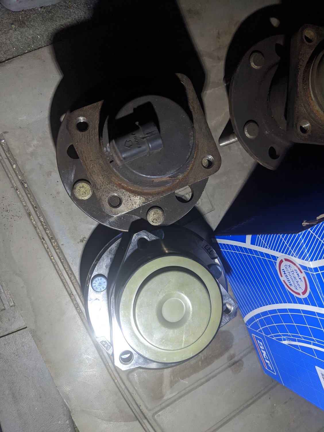

Oohwee, that there is a winter money project at $65 per corner! That is exactly what I want though so it will happen. For now I'll recycle the existing ARP studs without the thread starter nose that I want as I'll bleed to make these damned ducts. First pic I captured of the Camaro vs C7 hub.
This is definitely the end all solution for the hubs.
