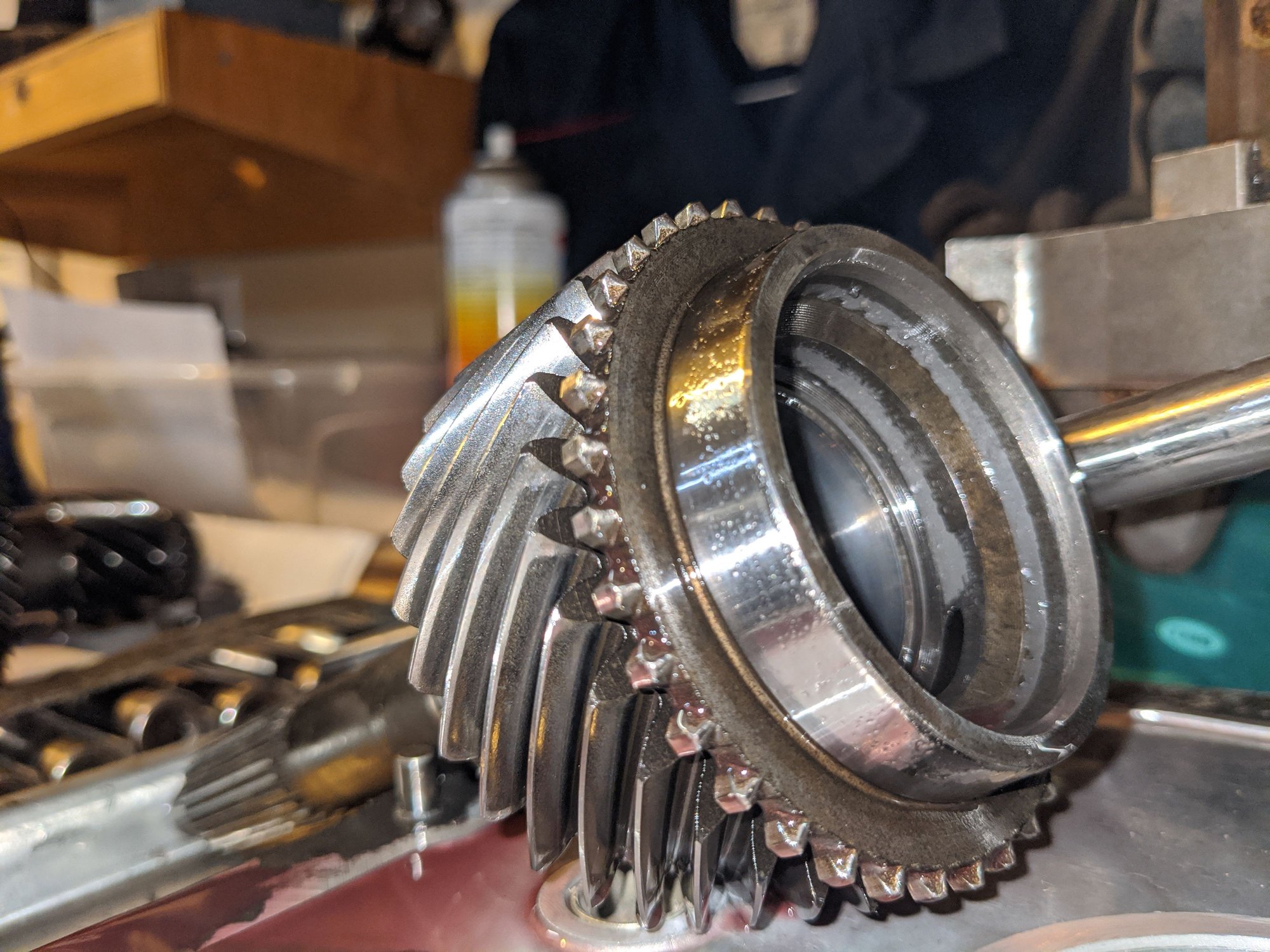

Got my trans apart last night. These things are surpringly easy to work on.
I need a press to get the main shaft apart. Bob? 😁
Here's an old/new 4th gear syncro.
This is kind of a let down. I was expecting brass syncros and a massive improvement in shift quality.
Here I did a crappy job of trying to capture the wear on these tips of the input shaft.
The surface where the pilot bearing rides is a little mucked up too. I intend to replace this and whatever else I find messed up once I crack the main shaft apart. 5/6/R looked good, but the plastic fork pads are hammered. I really hope that's what was messing up my 2-3 shifts. I snagged new carbon syncros and hubs, billet keys, and bronze fork pads for this thing along with a steel 3-4 fork.

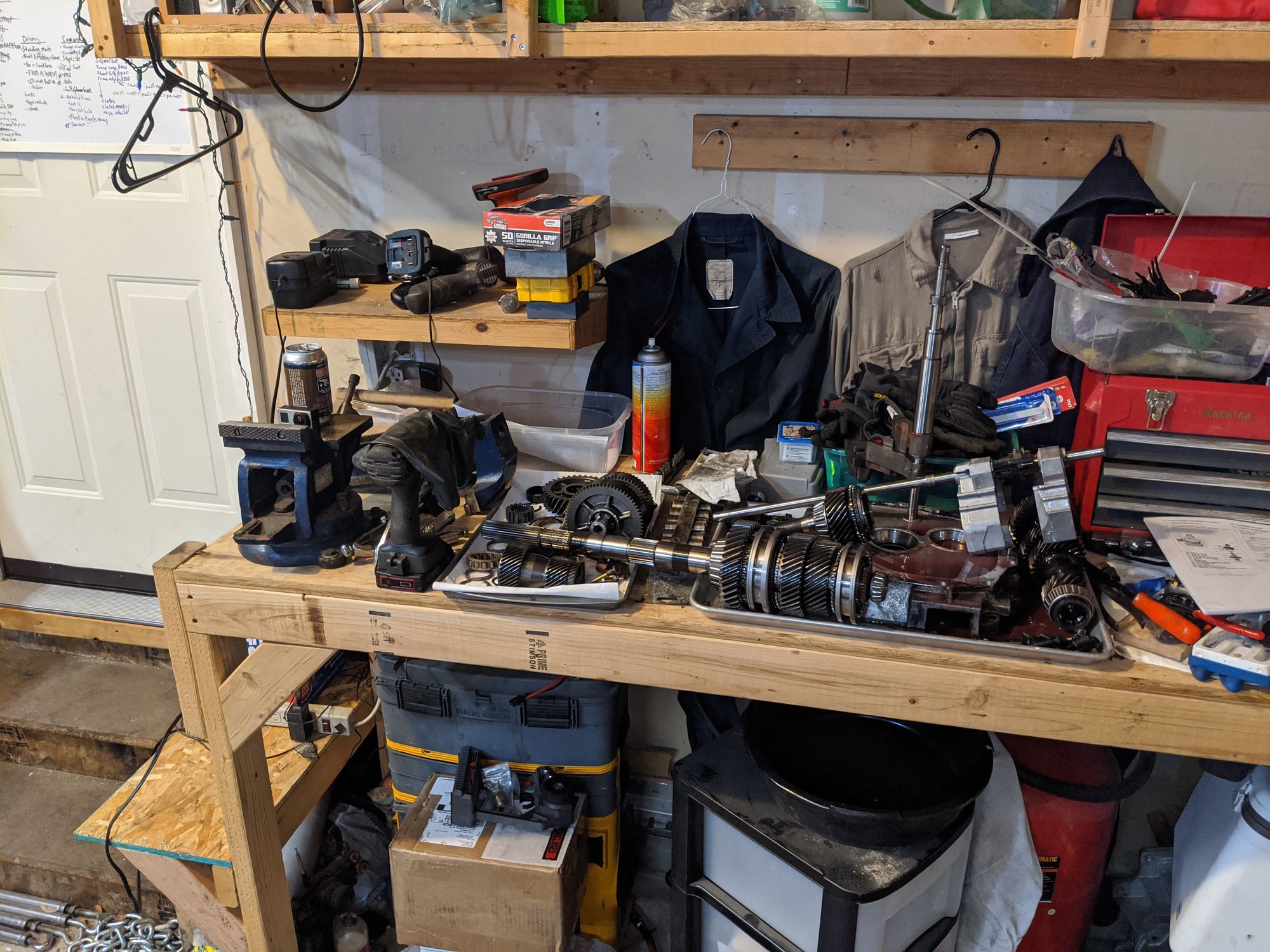

After texting with someone who's done a few of these, I got the mainshaft apart last night.
Now to decide if the gears are good enough. They seemed like it. Is it the end of the world if the tip shows slight wear? The input shaft had the worst teeth of all. Unless you count the hubs, those were definitely trashed. I can't believe it shifted as well as it did. It seems to me the aluminum hubs must be the fusible link inside these things.

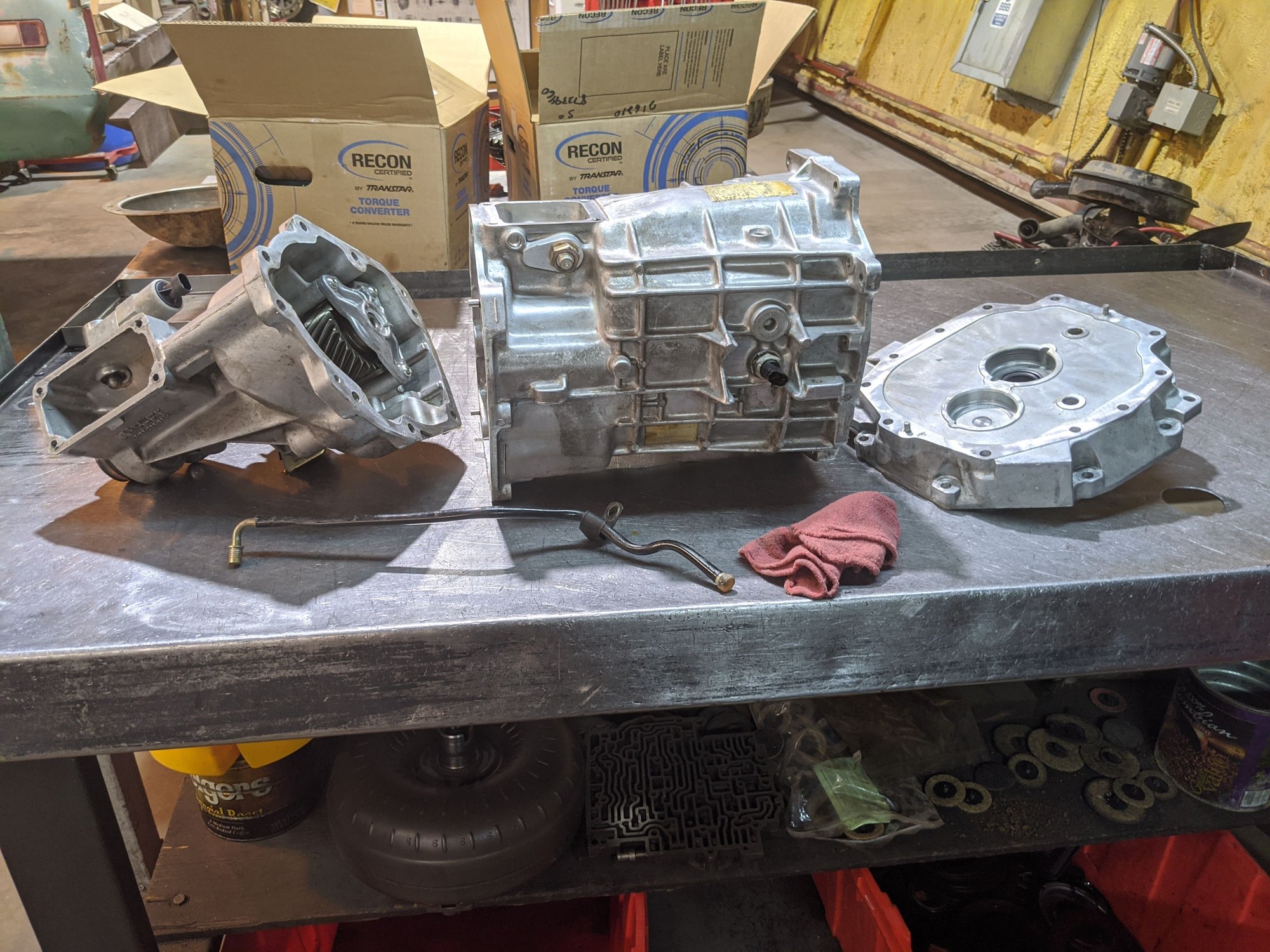

So I decided the gears are good enough, but I hit a couple other snags. I am replacing the input shaft, and that'll be here on Saturday. Next I got tanked the case and got all the SAE40W oil and dirt off of it.

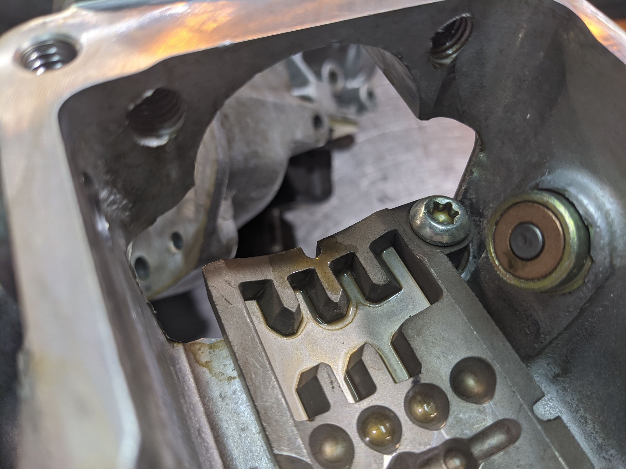

Came out nice. Once it was clean, I got to looking more closely at the guide plate.
​​​​I see rounded edges on either side of the 3rd gear gate. I decided I should peep the other mating surface.
This is the leading edge when the shifter is going into 3rd. This really looks like the most logical reason for my transmission ending up in no man's land when ripping off multiple 2-3 shifts. It didn't grind, it just would hang up on either side of 3rd if you didn't push the shifter up into the perfect location. It was especially bad when I'd shift mid corner and my arm was contending with the g forces. My last transmission always found its way into 3rd gear and never did this. My last transmission was also a low mileage unit that had been rebuilt before I got the car and this one had 150k on it before it went racing. I damn sure hope I'm right and I can slam some gears at my pace and not at the transmission's pace once this goes back in.

biketopia's Avatar
Joined: May 2017
Posts: 1,474
Likes: 101
From: Warrenton VA
Well if that ain't a helluva clue I dunno what is. Good catch and it should really even up your shifting. Going back earlier in your thread your talking about these super fancy one off diffs, I'm a straight line guy, what is so special about these for the auto cross guys?
