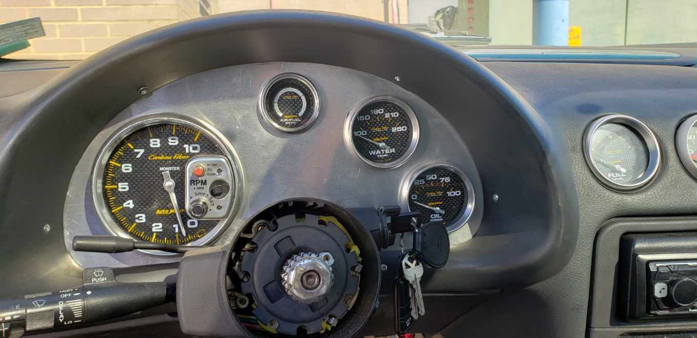

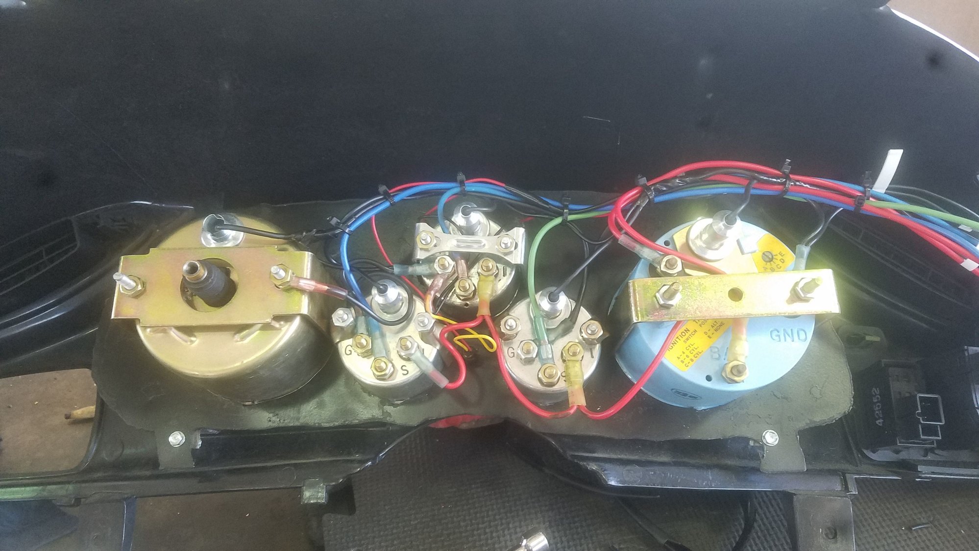

All I had before was a giant tach that I never look at and a volt gauge. It was all securely zip tied together, but did not have a professionally fabricated appearance. I could have simply added an aftermarket fuel gauge to it, but this will look cleaner. I'm still keeping the aftermarket oil pressure, oil temp, and water temp gauges. I also want to be able to compare temps apples to apples with other drivers who seem to run cooler than I do. The biggest driver here is the fuel gauge as I intend to shift some weight around just a smidge to get more inboard between the front and rear wheels. I'm probably not good enough to notice it, but every little bit helps and I'm doing a number of little bits to it this winter and hoping that, collectively, they do something. It'll be nice to have idiot lights front and center too to do a better job of getting my attention when something goes awry.

Man, I had a modified factory dash that was fitted with aftermarket gauges, looked pretty decent too. Would of fit right in for ya haha.

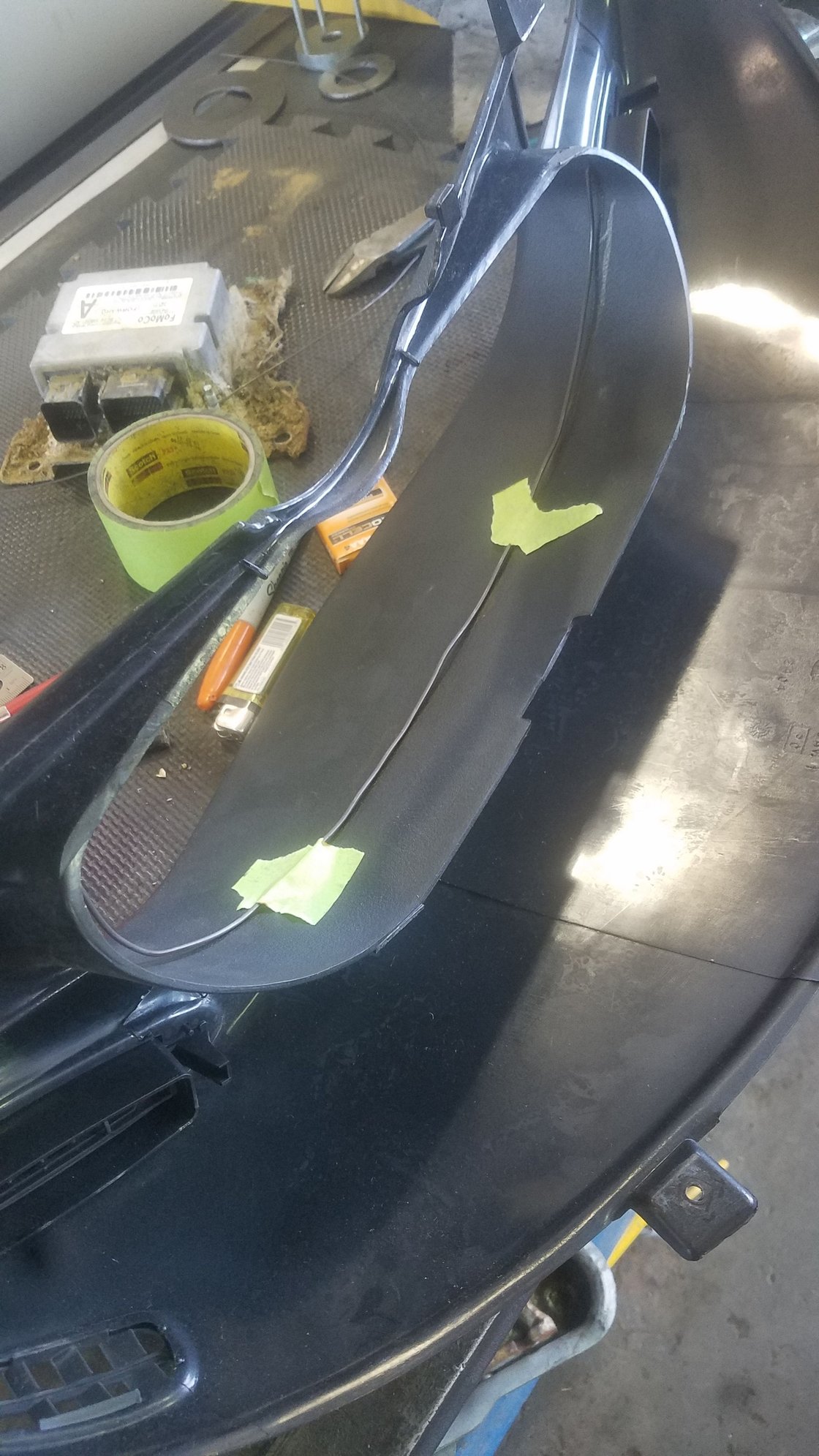

I'll dig back though my notes and see, last year I swapped a 95 firebird dash into my 95 camaro to get the round vents to mount gauges in. Then took some sheet metal and made my own blank face where the stock cluster would go, much like I did with the camaro the year before. I'll dig up some pics, wasn't hard at all.
Old Feb 21, 2020 | 03:10 PM
  #126
biketopia's Avatar
Joined: May 2017
Posts: 1,474
Likes: 101
From: Warrenton VA
Here's a few from building the dash for the Camaro, the firebird ones are on my phone. I never hooked up the speedo, so when I did the next rendition I only used a 5" tach, oil, water, and a narrow band in front of me, in the vents is Fuel, Trans, and Volts, and the F.A.S.T dual wide band is in the glove box.

How was that panel secured to the bezel? Mine was zip tied in a million places and it drove me nuts.
On the Camaro one I epoxied tabs onto the back side of the plastic factory bezel and then used some sheet metal screws to attach them to one another (last picture). On the Firebird swap, I made tabs on the panel, bent them over and drilled and riveted the sheet metal to the plastic in 4 spots. You can kind of see the rivets if you look closely on the edges. I thought I had some better pictures of when I was building the fire bird dash but I can find em so these are how it looks today. I scored the firebird dash carrier from the junk yard for like 40 bucks, stripped it of everything I didn't need there. It just a shell in the car, no hvac or air bags etc, it's from like a 96 or 97 so it's a slightly different opening than the LS cars I think. The switches below my radio are for ignition system, fuel pump, electric water pump and fan's high and low. On the firebird cluster the Tach is not a panel mount tach, but I found a fernco type rubber fitting that fit the back of it snugly, cut my hole and slid it in and used the thick rubber to hold it in place, the others have mounting brackets. Some one posted this in another thread https://maggperformance.com/product/...r-blank-plate/

Biketopia that looks way better than the way my car was put together. I like that.
