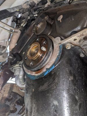

So the dually decided to pump its oil pan dry and I tore into it last Saturday to see what the deal was. I suspected rear main based on someone else's account and it turned out being the case.
That's how I found the seal. Saved me the trouble of dropping the diff to drop the oil pan to pull the rear main cap to remove the old seal.
And if you look closely, you can see it's been walking itself off for a while now. Gonna beef up the crankcase ventilation to prevent a reoccurence.
Since I'm in this far, I'm knocking out the rest of the pre-season maintenance as well. I've got more time to do this stuff with the new covid19 work schedule. Once this mess is wrapped up, I can finally get back to the Camaro. I wasn't really liking the idea of not having the camper at the track this year, or in general, so decided to jump on this. If 1 truck goes down I can survive, but they both went down to an extent recently and that's no good so had to shift my focus back to them for the time being. This addresses some things that have always bugged me about this truck so it'll be nice to have it all buttoned back up again. I've blown a ton of muck off the trans, tcase, and the exhaust is getting cleaned up as well. Manifolds are getting blasted today, I can't stand the rusty dirty look on an otherwise VERY clean 1997.

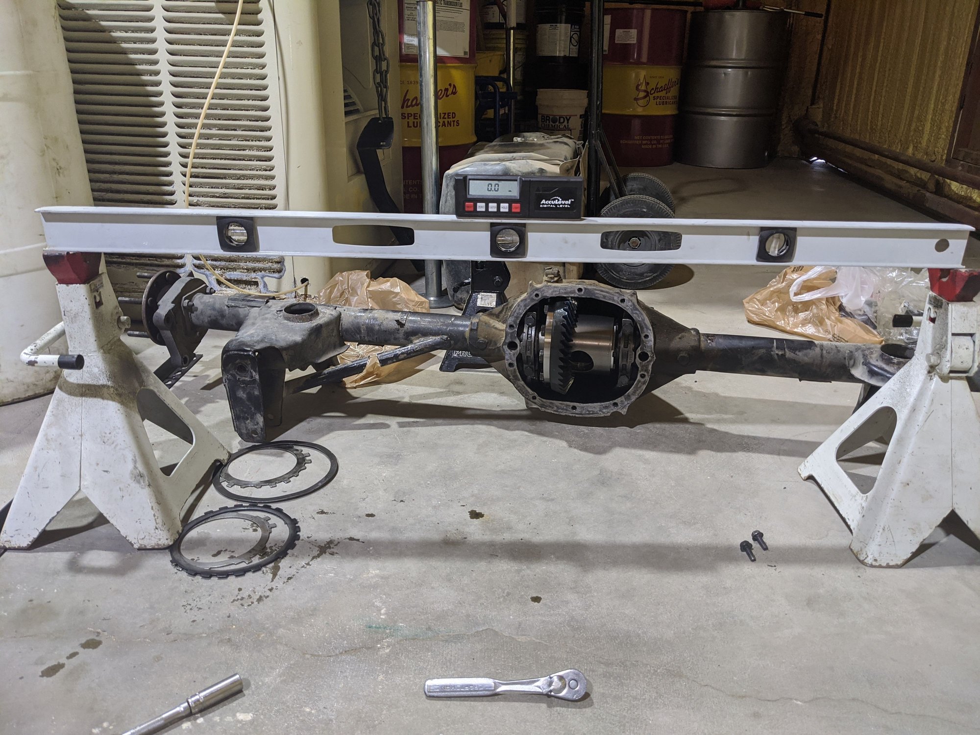

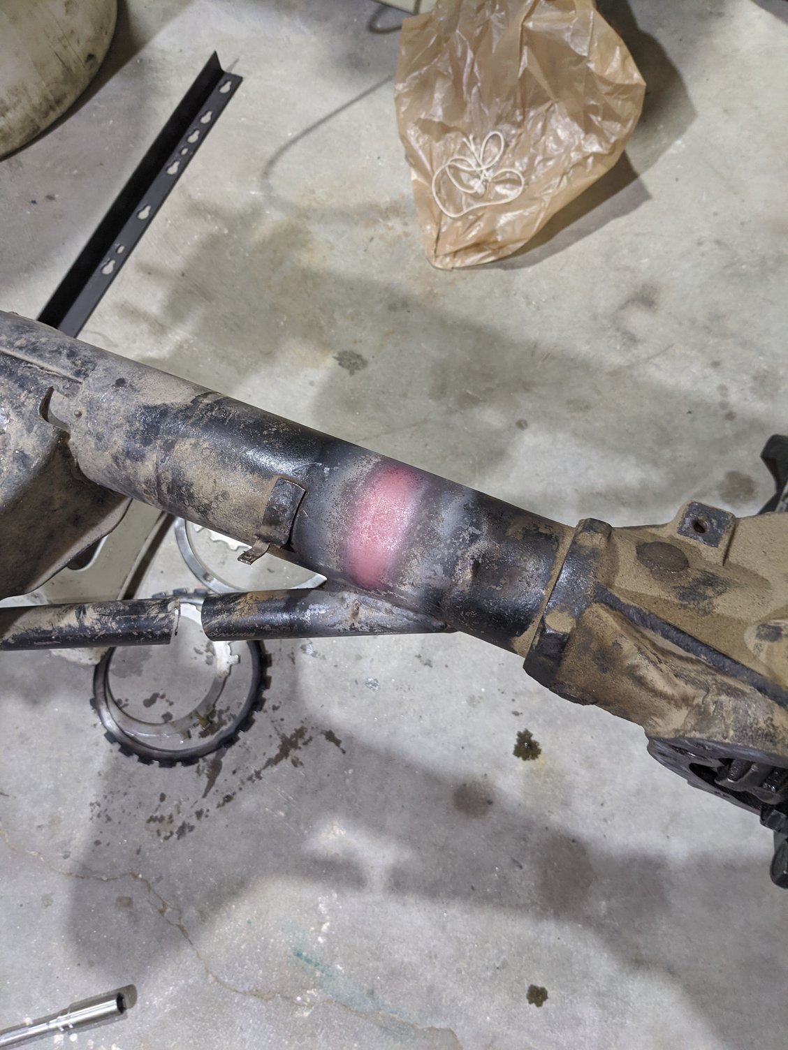

Originally Posted by Supercharged111
Today I went after some camber out back. I started by levelling the jackstands.
Next came the torch.
This single heat and cool cycle got me from .1 positive to 0 camber. I did this a few more times and got .2 negative. The other side was at .5 and I worried adding more to the left side might add some to the right? I wish I knew more about this.
So you just ran the torch around to get red and let it cool a few times checking camber each time or did you put weight on the center section?
Old Apr 4, 2020 | 05:39 PM
  #157
Supercharged111's Avatar
Joined: Dec 2015
Posts: 931
Likes: 153
From: MI
No weight, it just over shrinks when it cools. You can quench it too.
I thought quenching made the metal brittle (for welds anyways, figured it's similar with just heating red hot).
I was thinking about welding the tubes to the center hoping it would kill two birds one stone if I just set it the right way on stands.
Old Apr 4, 2020 | 06:52 PM
  #159
Joined: Dec 2015
Posts: 931
Likes: 153
From: MI
It does make it more brittle, but I was told by someone who straightens axles for a living he's never had one come back.
Did you heat the same spot over and over or move over a little each time? What measurements did you end up with?
