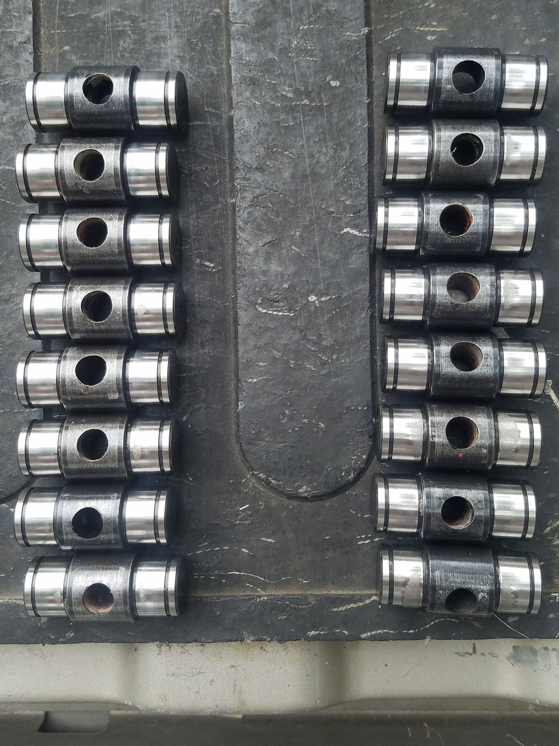

Hello, all. I was referred to this forum via Performancetrucks.net. I posted a few questions but was advised to seek some direction here. I recently attempted to upgrade an L33 in a 2006 silverado. Sought out a notable builder in the area. BTR stage 2 truck cam, stock crank, pro LS forged pistons and rods, ARP head studs, 799 heads worked over full competition port and polish, Beehive springs. Inconel exhaust valves, hardened push rods, NNBS intake, 90MM TB, CAI, LTH, X-pipe, true duals on magnaflows,,….. originally procured a set of needle-less Straub technology trunnion kit but the builder informed me that he previously had a bad experience with trunnion kits and opted to go with a scorpion roller rockers instead.
Got it tuned by DSM lights (awesome guy Edgar) set my rev limiter to 6500. Went through the 2500 miles break in oil period, changing as directed. Changed to synthetic penzoil platinum, I’m 1500 hundred miles in. Now I’m experiencing sputtering on acceleration and hearing a knock from the passenger side valve cover. Also sluggish at highway speeds. I have not had it WOT yet. I kept it under 5000 rpm but only hit the gas a few times. Was trying to bring in it gradually. Before this it was running beautifully. The knocking is slightly audible but more tangible, i can put my hand on the ignition coils and the oil spout-and the whole valve cover for that matter and feel the consistent tapping,
Popped the passenger side valve cover off. A buddy that turns wrenches for a living said that i may have Clarence issue with the Rockers. I initially thought it was hitting the valve cover. But it may be hitting the back side of the head.
Would this concern contribute to the sputtering on acceleration, and loss of power? Or perhaps the tapping? Or would it be something else like a dropped valve?I checked the springs and they look good. I will post some pics of the rockers.

Possible stuck lifter, roller rocker trunion/bushing fail, broken valve spring, stuck valve.
I would also pull the plugs and use a cheap amazon bore scope to check pistons. < than 100 bucks plugs in to a phone.
Stop running it.. It wont get better if its got a mechanical knock. I would tow it to the builder.. At < 2K miles, It should still be his problem.

Ever since i notice the tapping i stopped running it. Would a rocker rubbing the back of the head cause issues like what i described?

If the rocker is rubbing the back side of the head there is a problem, Without looking it over myself the first thing that comes to mind is the pushrod could possibly be to long or there could be an issue with the rocker arm itself. Either way they aren't supposed to come into contact with anything as it travels.

Have you changed the oil and looked for or any signs of metal? Nothing wrong with factory style bushed rocker arms and it was Comp Cams trunnions that was having failures.
Can you tell us more about these Scorpion rocker arms? I've heard some horror stories about running cheap aluminum rocker arms and If it was me I'd be pulling the valve cover and inspecting it and everything else looking for signs of metal shavings and damage from metal to metal contact. I'd pull every rocker arm and pushrod to inspect them for signs of wear and damage and I'd also thumb check the valve springs to see if I have any excessive guide wear as those should be stiff and hardly move at all when you apply pressure. Verifying PR length would be on the list and hopefully you caught it in time before you done any significant damage.

If your experiencing a loss of power, to me that indicates much deeper issues. I would pull the rocker covers, do a good visual inspection, and then crank the motor over and make sure the rockers are all moving equally. I would pull all the plugs out for this so the engine rotates smoothly. Maybe disconnect the injectors/harness and coil packs.
Next thing I would do is a compression and leak-down test. These are critical and will tell immediately is something is amiss, and if something is wrong you can speak to the builder armed with undeniable info vs. him telling you some nonsense like "its fine" or "put some more miles on it".
And cut your oil filter open while your at it.

Good idea,….. I also got my hands on an endoscope as advised. The rockers are coming off for sure. Check the push rods. And see if a valve has been dropped. And if any damage to the pistons. Check the oil filter for metal with a magnet. Anything else?

Geometry of a stock rocker arm that is fixed due to it being mounted on a pedestal with a predetermined height and pushrod? I can see the "It's good enough" in building an engine with stock parts that have been proven to work without checking P-V clearance. It's when you change something is when required like wanting to build more compression and knowing how much you can mill the cylinder heads.
