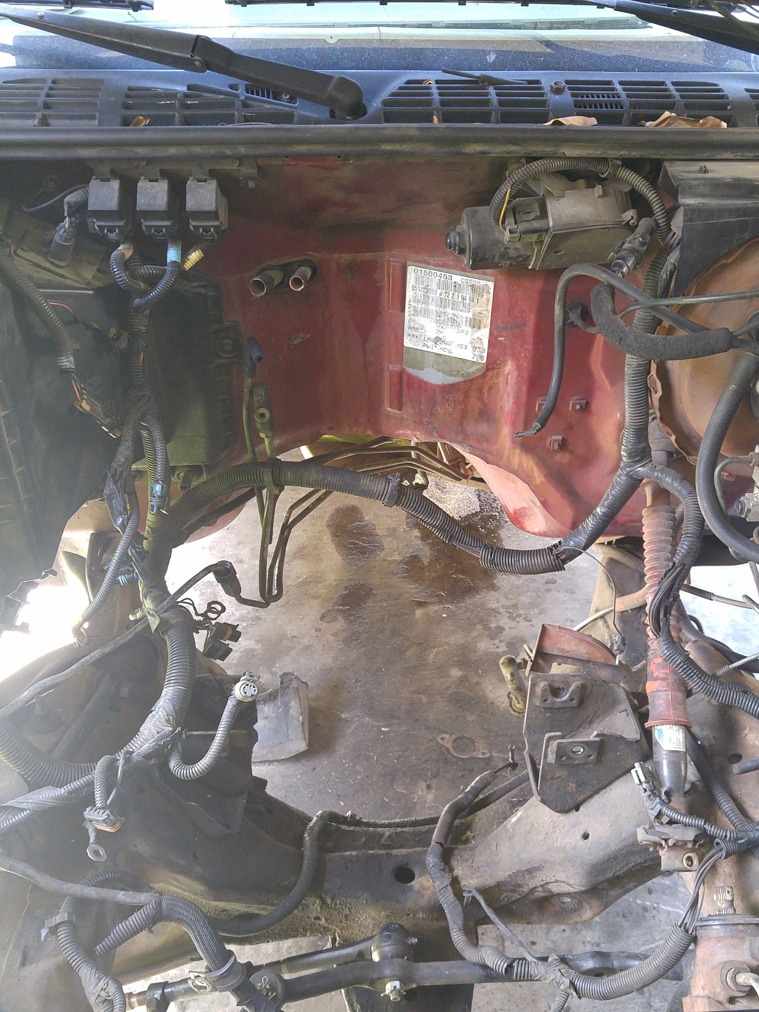

So, I've owned Ron for about six or seven months now. For $1000, it was doing far better than I had originally imagined a truck (or any vehicle for that matter) to do. At the time, the only major repair I had done was replacing the drag and toe links and drove it to Vegas, Buttonwillow, Ridgecrest, and several other places until a few weeks ago.
Those few weeks ago it started acting odd and wasn't making power. It was struggling to get downhill but never really did anything worse. Checked the water for the signs of anything catastrophic and hoped it could last me until around June. Well, turned out after replacing parts there was only one thing that it could be and I pulled the head to confirm: it was cracked.
Crap.
Well, it became the great excuse to start getting the L33 engine going. Yep, that's right, I have an L33 that will be going into Ron Burgundy. It's great because I'll get roughly the power I want in an engine that will be lighter than the LQ4 I was originally looking for. Of course, I would need parts to get it together and in to the S10. Thanks to Texas Speed Industries, that's going to be easier with Dirty Dingo, Mechman, and Texas Speed's own parts. Can't thank those guys enough as that's a big part of this build other than the transmission and engine controls.
I've also started to do the suspension that we've received from QA1 and the junkyard sourced ZJ Grand Cherokee steering box for a quicker steering ratio. We've also got the wheels it will wear but need to get tires for it. Finally, Optima sent us a battery and charger, so look for a review on it soon.
So, the next big parts I'm going to need soon are the 4L60E transmission the the 8.8-inch rear end.
