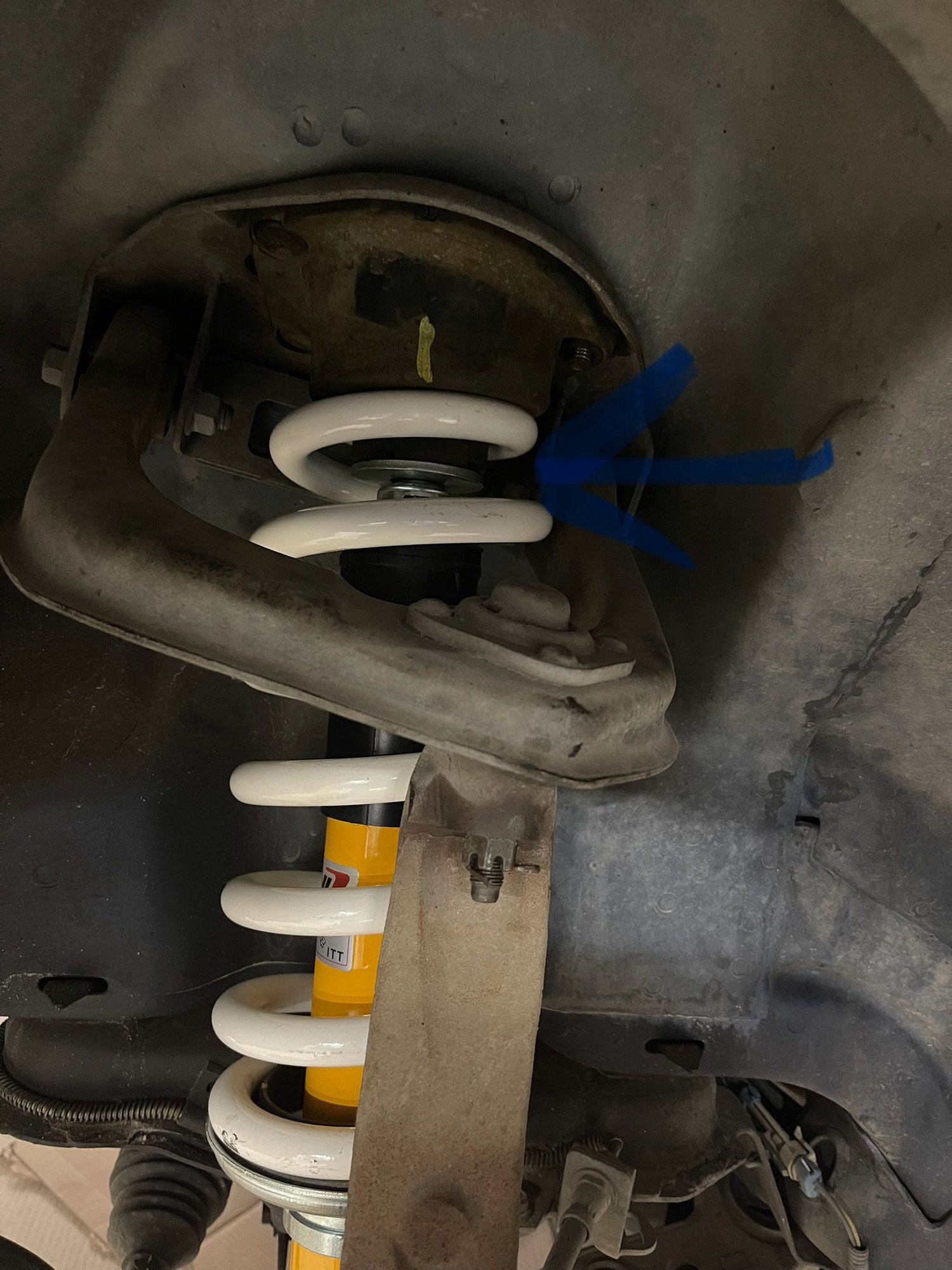

Old Nov 24, 2024 | 07:44 PM
d_lozy's Avatar
Joined: May 2015
Posts: 14
The picture isn’t showing up on this. Do I have the washer in the right spot?
Old Nov 24, 2024 | 07:57 PM
Sam Strano's Avatar
LS1TECH Sponsor
iTrader: (41)
Joined: Apr 2002
Posts: 9,614
Likes: 152
From: Brookville, PA
It is indeed.
