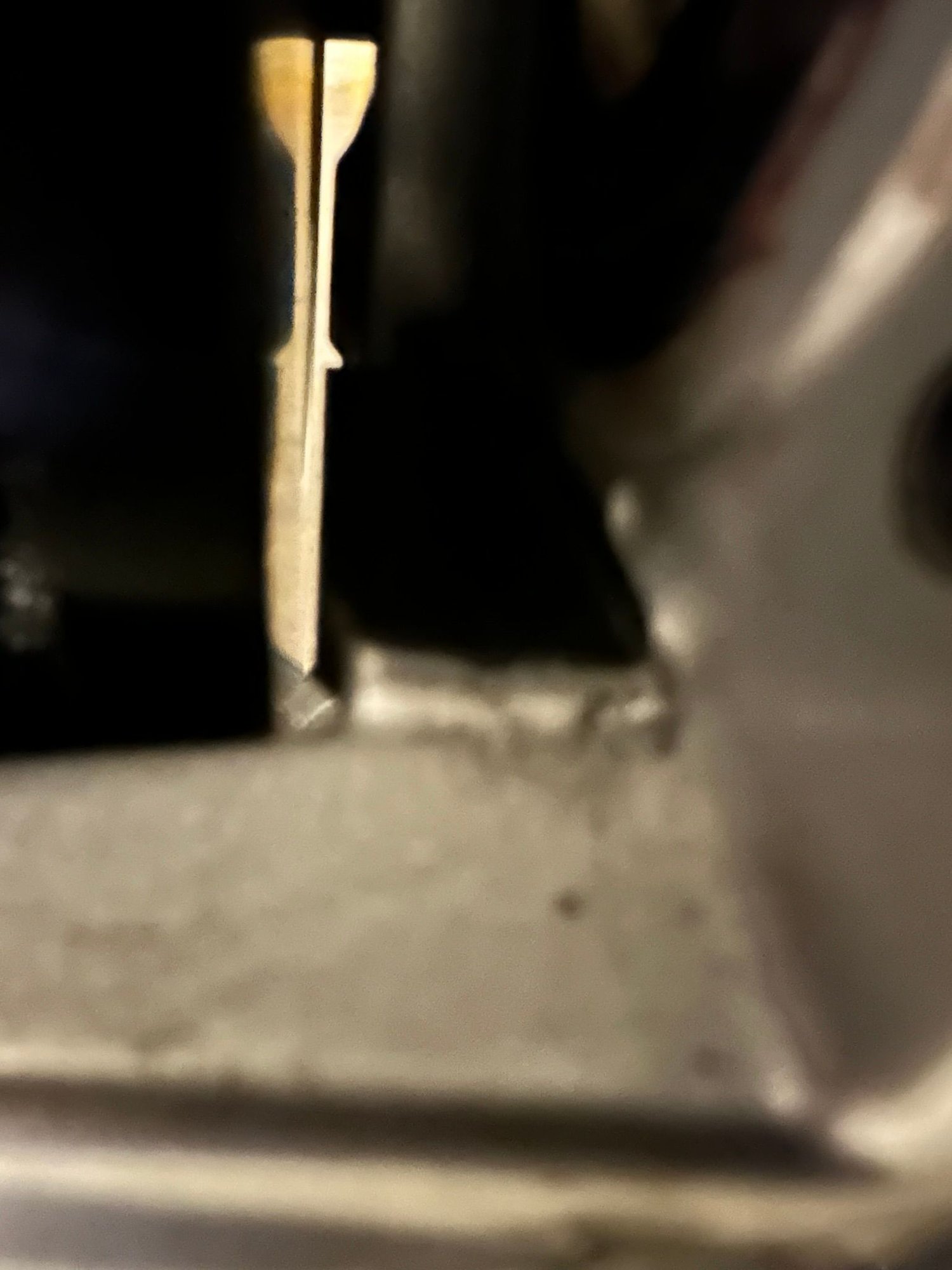

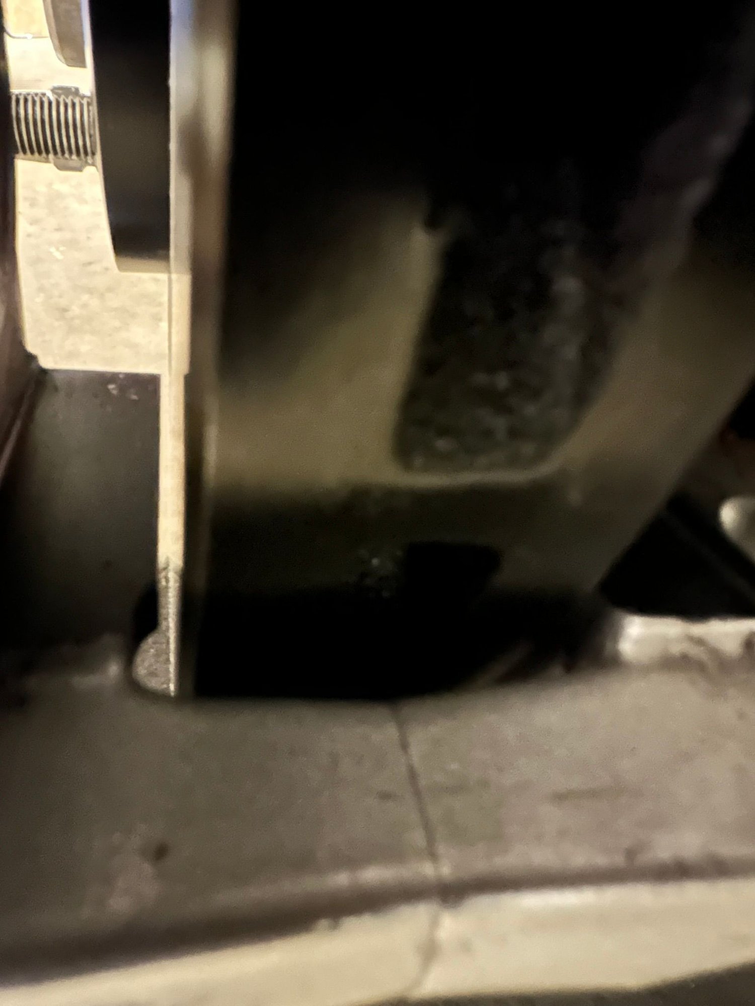

Spacing with M12 Big washer thats 3mm thick. One on each bolt between knuckle/caliper.
When I use the 2 M12 washers, a piece of paper would barley fit on the one side.

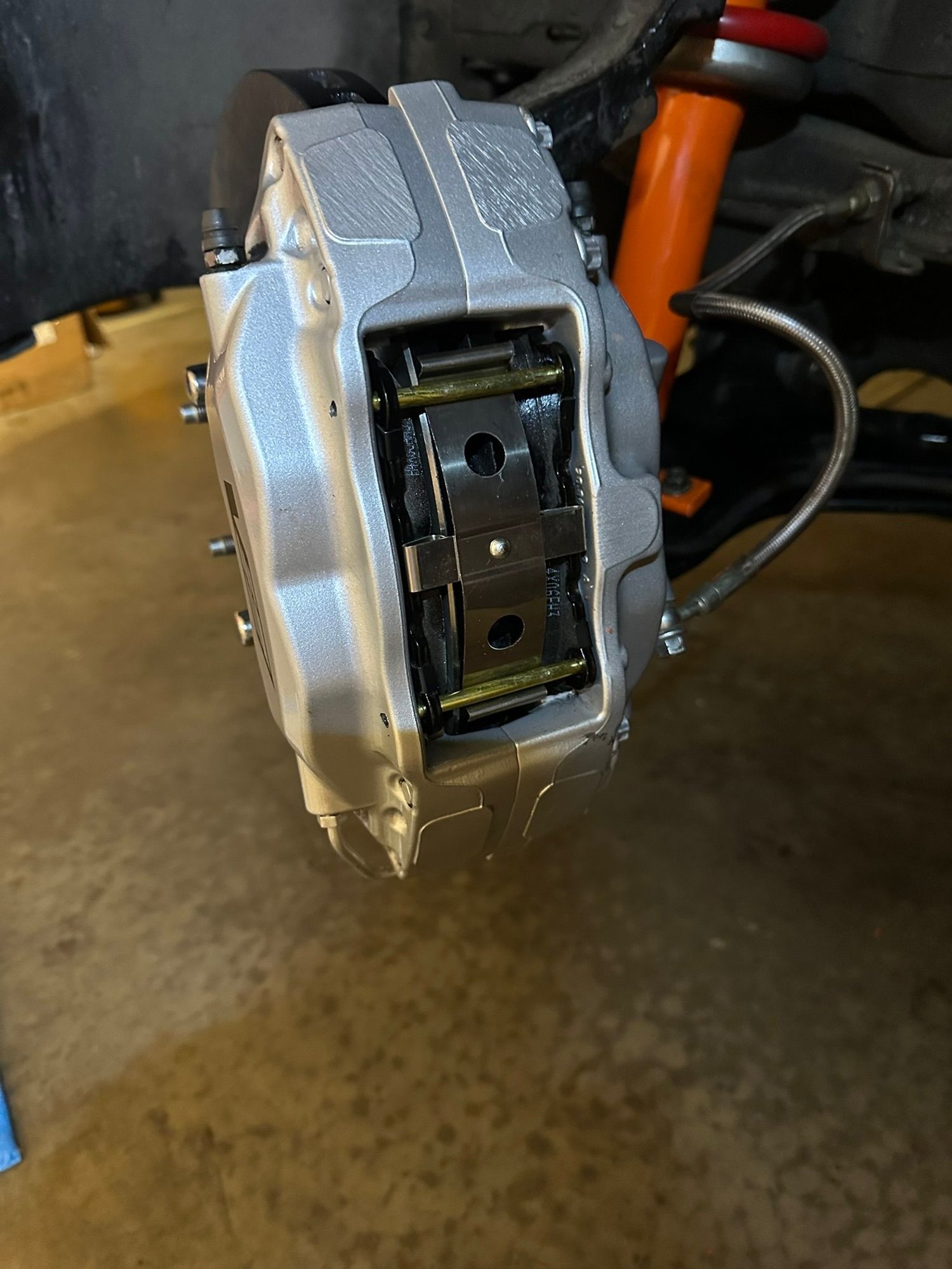

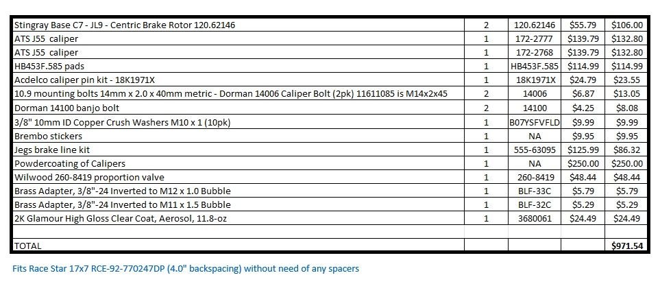

I went with the ATS setup. All new brake lines were ran. In addition to the parts below, I needed (4) 20 Deg Side Bent 3AN To 10mm 3/8" Banjo / Brake Line Fitting Adapters.

Great blueprint for those looking to do this upgrade.
Well done.
