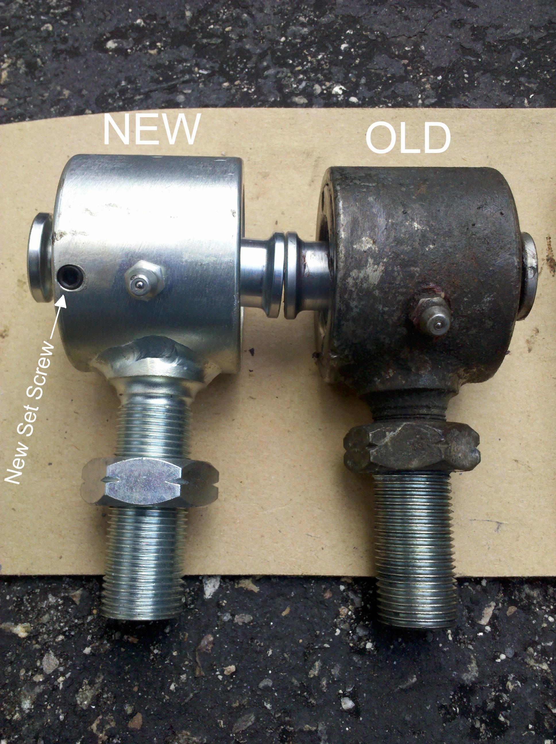

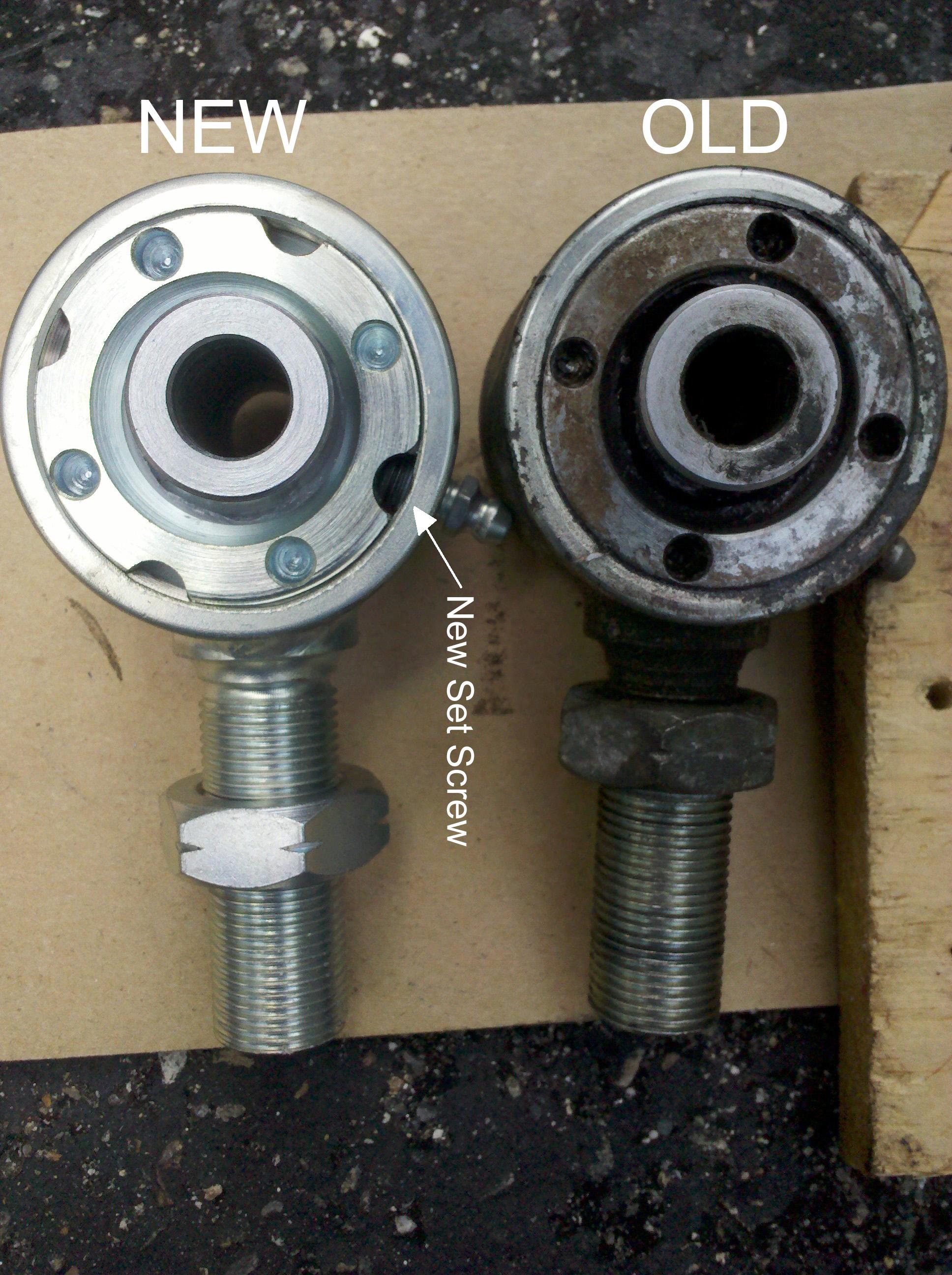

Update
Here is a comparison of the Old vs New Design with a set screw added:
(Click Images for larger image)

my question to those that have them how often do you have to adjust the set screw if at all or can you set it and forget it

Looking at the recess it sits in, you shouldnt ever have to adjust it, since it physically prevents the thing from turning.

You shouldn't have to adjust these often at all. We have them preset to a certain tightness. The only time adjusting is required is if or when the delrin lining inside would begin to wear. Once it wears you can tighten the adjusting ring in to apply more tension. This isn't often though since the delrin doesn't wear quickly.

We updated the design awhile back with a set screw that now locks the adjusting ring in place and prevents this.
If you have an older design PM me and I will take care of it.
As for Delrin, we have no issues using Delrin in the Roto-Joint, we are pleased with the performance of Delrin in the applications we are using it. The older style Roto-Joints are a locking issue and not a material choice issue.

I agree with DietCoke & UMI Performance, you shouldn't have to adjust the set screw unless the Delrin bushings wear. In which case, you can loosen the set screw, screw in the notched side plate, and screw in the set screw again to lock in the side plate.
The set screw keeps the side plate from rotating and backing out which happens on its own as you drive due to normal suspension movement (which leads to rattles as the joint loosens up).
