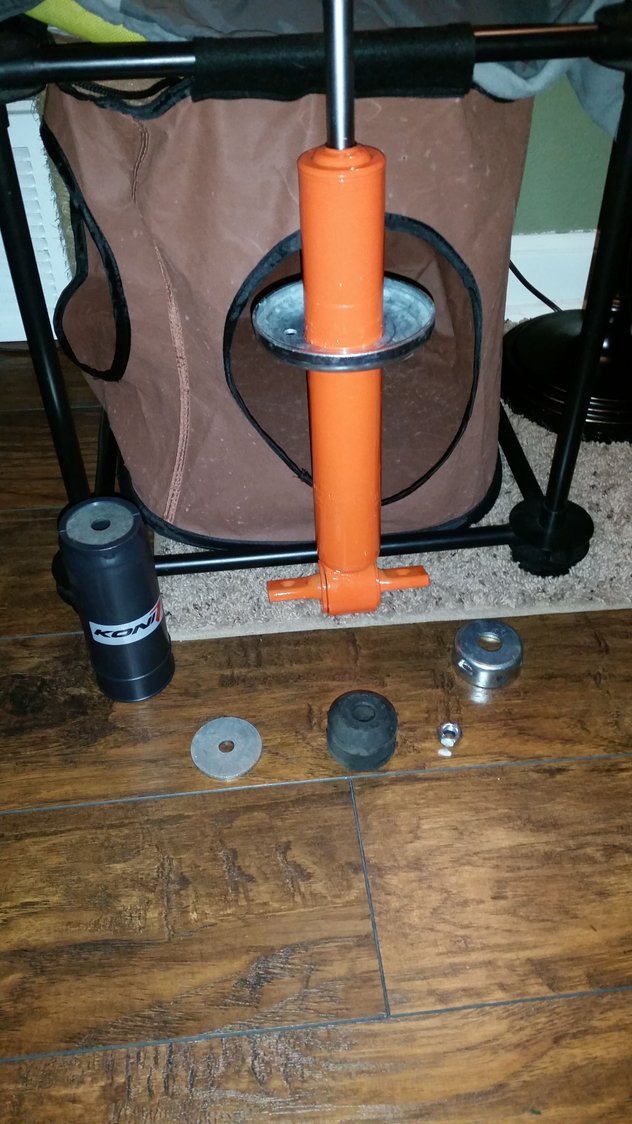

So this is what came with each shock. What i dont understand is what the strut bellow is for, and where the metal part all the way to the right goes. From what i seen from the old one, I thought all I needed was the top mounts, the coil spring insulators for the top and whatever sits in the plate where the spring sits on the bottom of the shock which I thought would be the coil spring seat?
Okay, So disregard the bellows since I see it already comes with them.
