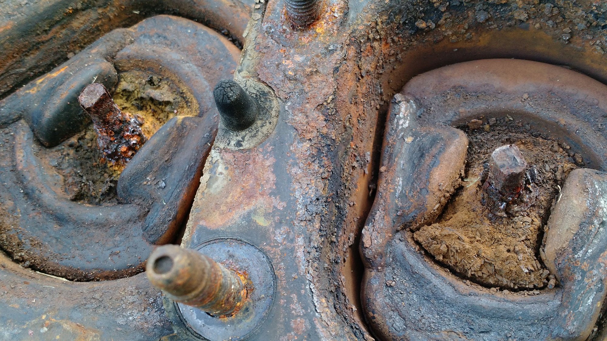

I needed new mounts pretty bad
I could've put spring compressors on the springs and cut through the nut and shock shaft to free up the assembly, at the expense of ruining the little isolator piece and possibly cutting into the shock itself and letting the gas start leaking from the shock (a neighbor did that so I didn't feel like doing that.) So it's possible to save your mounts and lower rubber spring seat piece, but you also might end up lucky and have mounts that aren't rusted at all like mine too
Nevertheless I didn't want to mess with the old shock assembly so I bought all new mounts and pieces lol, I'm not as adventurous as some
Geez those don't look too healthy. Lol ok I'll check mine out and make a decision based on the condition they're in. Thank you
