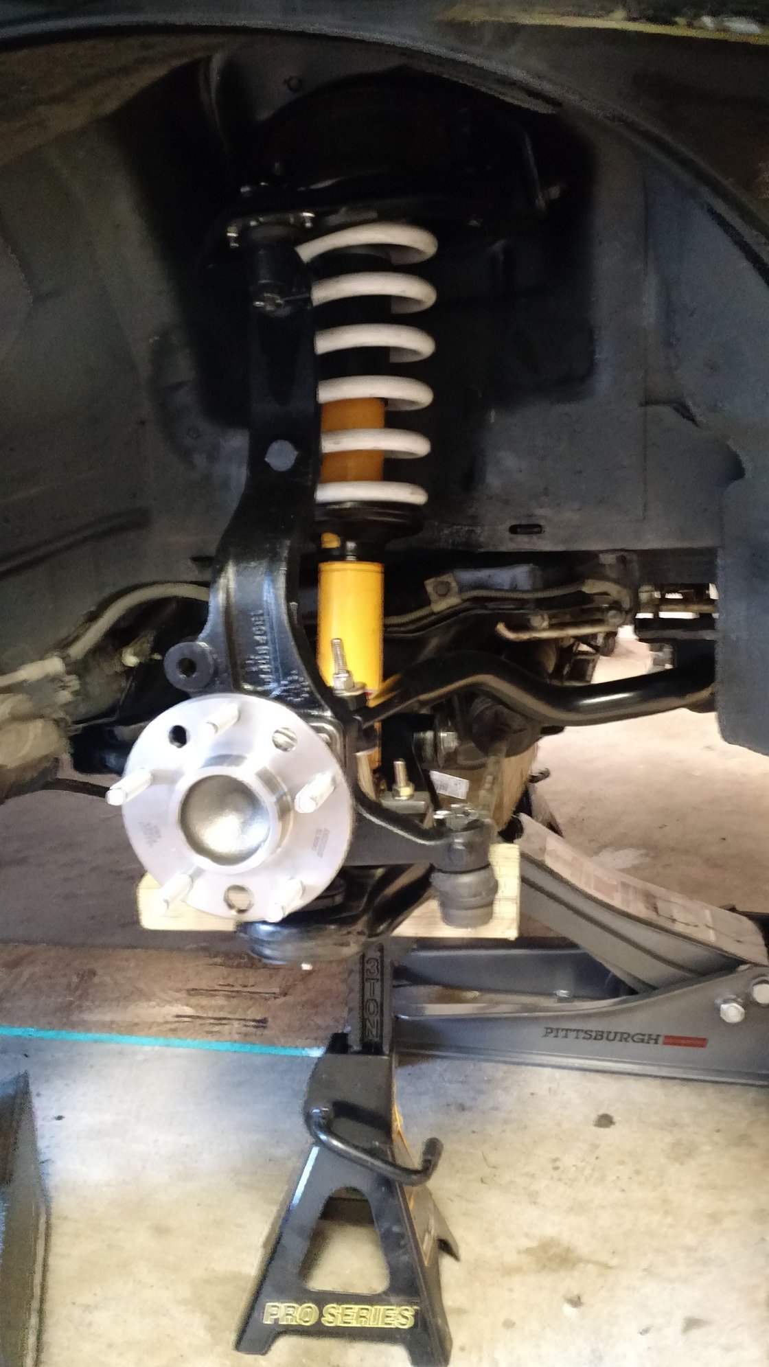

I've finally finished up a great deal of work on my car. Only problem now is alignment.
Question is will adjustable front upper control arms be able to dial it in? Do I need to worry about damaging my new wheel hubs/bearings with the current alignment? I am not particularly excited about spending a lot of money on front adjustable control arms. So I would like to limit to exactly what will give me the adjustments I need.

Over the last few weeks I replaced the front upper and lower control arms, bushings, and ball joints. All MOOG except the control arms that where stock replacements. The old ones were really rusted and had to be cut off the K-member anyway.
Pics of the work I did to better explain. The rust did't make it
