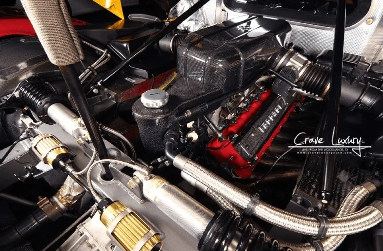

Pushrod suspension. Common with supercars and is not anything new, the ferrari f50 had it back in the 90s and have been used in f1 cars forever.
The biggest advantage i can think of is packaging space and potential ease of access to parts.
Is this the exact thing you are talking about?
Heres from the f50:
Enzo
Zonda
