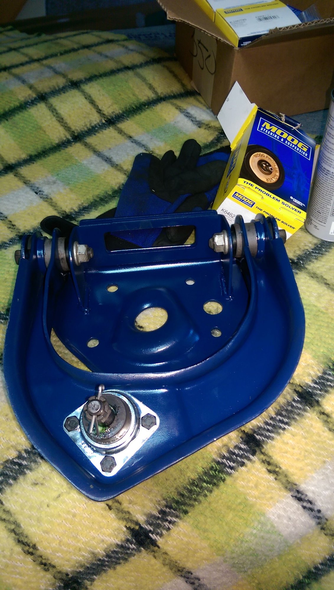

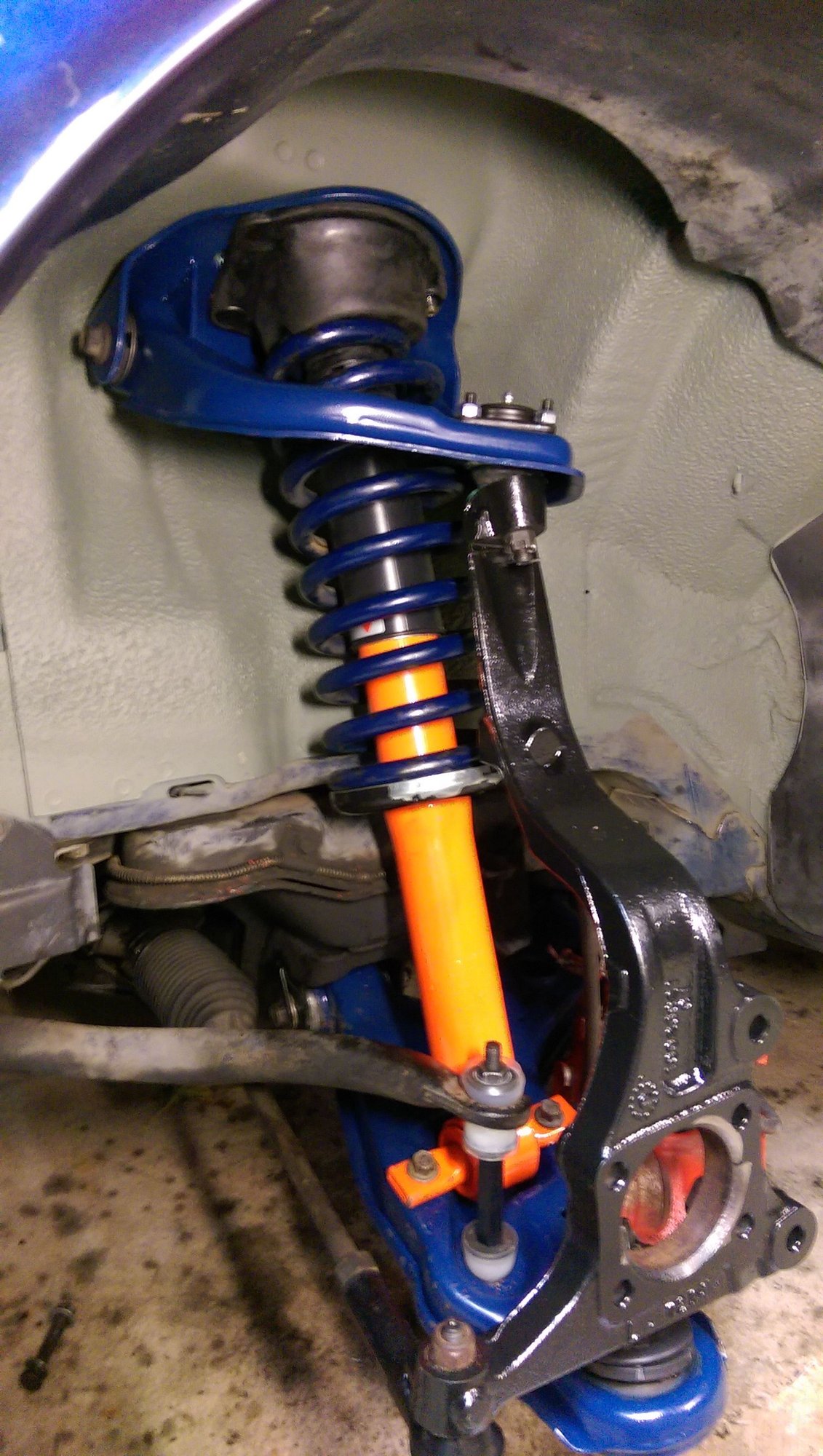

Guys quick question...with the collapse of the front suspension (pics on beginning of post) is it possible The rack and pinion took on extra stress to create the power steering leak I experienced days before I realized front end suspension was installed incorrectly??
Also, We noticed that the caster was off (upper ball joint sat forward of the lower ball joint). The top strut mounting bracket attached to the wrong control arm.

Sounds like the shop fixed it at their expense.
My '94 FSM doesn't even seem to show the insulator as part of the upper mount assembly, which seems kinda strange.

Did they reinstall the bumpstop and dustboot that was also missing from the original picture?
