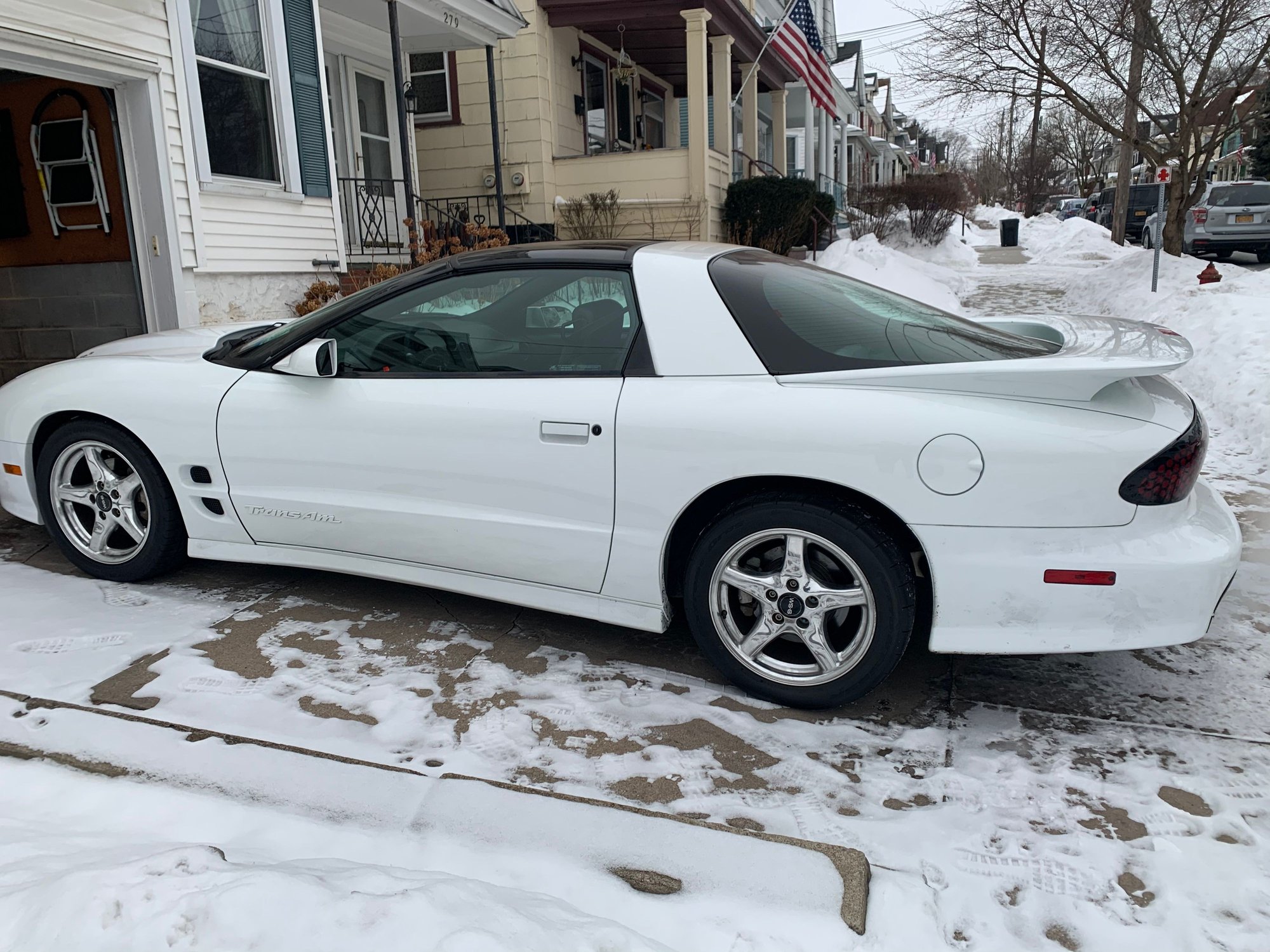

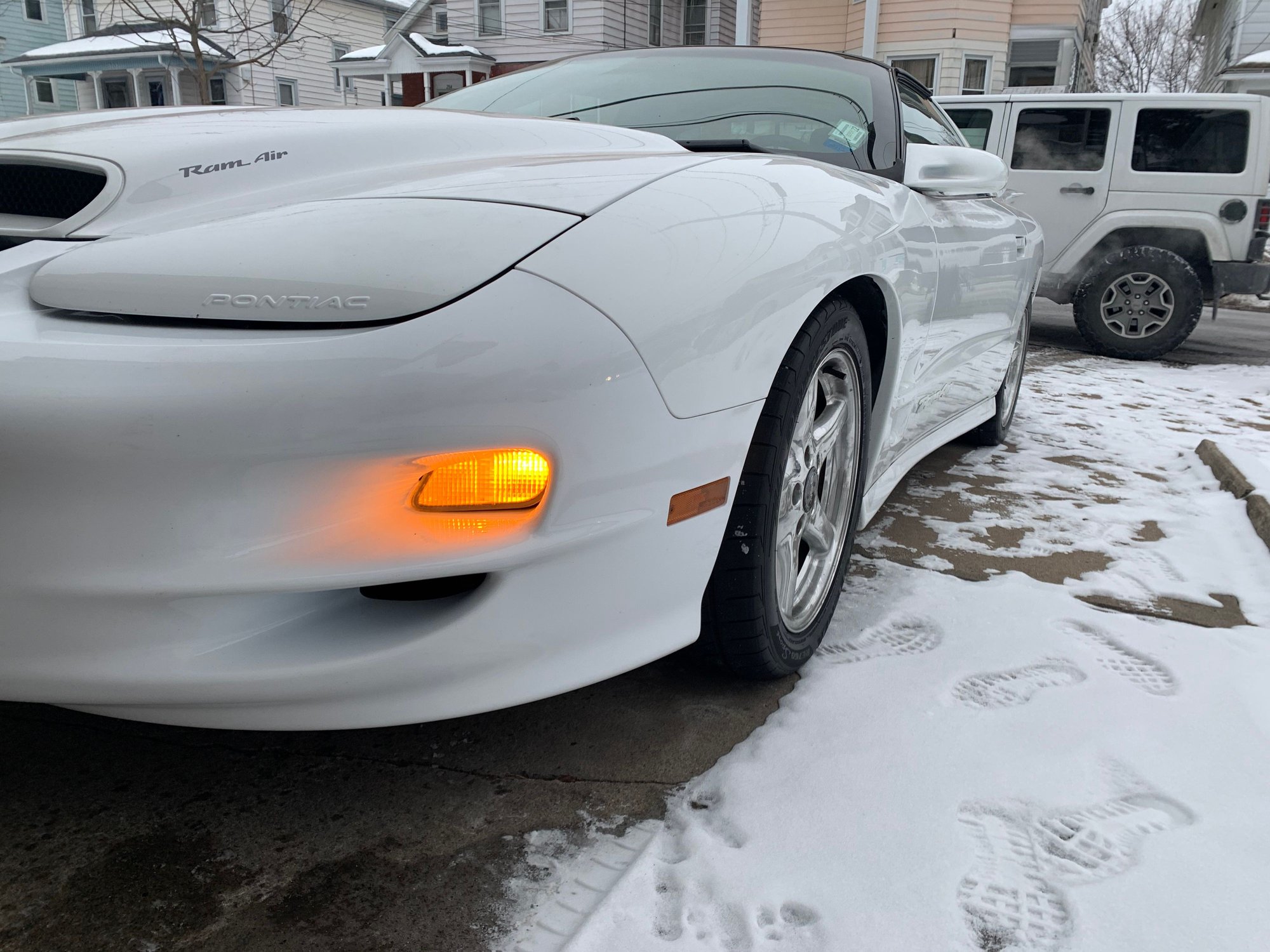

Just put that combo on mine last weekend
(only in snowy driveway for phone)
