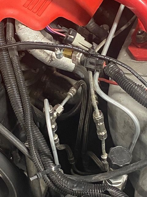

SJM, mine brakes just fine, not a daily driver at all more racecar though. Did mine with engine out so a lot easier. Yes you need to flare the factory lines which are steel and harder to work with. Eastwood "on car" flaring tool works perfect though.

Im all finished up. What a terrible mod. The SJM kit was a terrible idea. Without a very high quality flare tool properly flaring the tubing is impossible. It was a total nightmare. Do not buy the SJM kit! Basically all I used was one line and the valve.
If SJM included Swageloks it would have been a breeze. I would have gladly paid 200+ extra for the swageloks to be included with the kit.
Dear SJM, Please fix your instructions and replace the fittings with swagloks. Also the website is missing a ton of information. Like how very difficult it is to flare tubing.
Ordering Swageloks is a pain in the ***. Swagelok makes it very difficult. But they work PERFECTLY!
Anyways my breaks work 100x better now. glad i got this doneish. I should have listened to the guy that said dont get the SJM kit!
