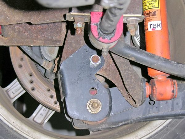

Factory rubber bushings = comfort, Aftermarket poly bushings = better handling with a slightly stiffer ride. You might not even notice the difference in comfort.
Sway bars end link bushings, unless they're deteriorated/broken/flattened, no need to replace those.
