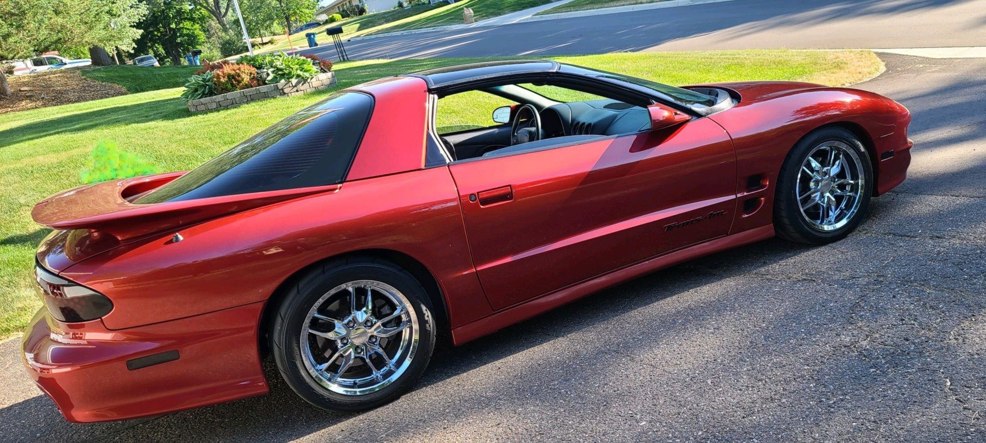

Sam has some Billsteins that are custom revalved to his specs by Bilstein, matched to different springs. All of them are much better than any OEM springs/struts/shocks. He also will give you the best adjustments for the Koni's depending on your intended use.
Old Jun 17, 2023 | 08:24 AM
98CayenneT/A's Avatar
Joined: Nov 2013
Posts: 3,913
Likes: 366
From: White Bear, Mn
Strano springs with Koni Sports. The handling is absolutley amazing.
