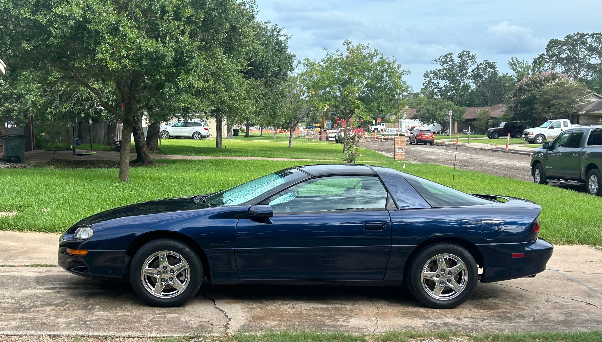

Like any beautiful woman (Sara 2001 Z28), "the best kept secrets are underneath the facade." She is stock height, due to a B&M 3 1/2 qt deeper transmission pan, which hangs noticeably lower than the stock pan. She has SLP 3-point bolt on subframe connectors, BMR non adj LCA’s and PHB and adj torque arm, solid front and rear sway bars and U brace (connecting the subframe connectors), Detroit Speed front welded sway bar brackets to frame (learned this one the hard way). I have Bilstein HD shocks, and like any good woman, I "have to hang on for the ride "
Sara is beautiful, always loved that color

Originally Posted by RevGTO
With all due respect, "Sara" looks 4x4. A big gap between the top of the tire and the wheel well is unsightly. This can be corrected by the above adjustments without going into full lowering mode - basically an adjusted stock ride height.
Absolutely no offense taken, I went +2 on the wheels 18x9.5 and went to a very low profile tire 285x35ZR18. This MAYBE the reason for the gap. When I had the shocks installed, I had the mechanic "index the springs to the seats, so the stock springs sat exactly how they came off. I can say that I have a very stiff ride, with no sway at all.
