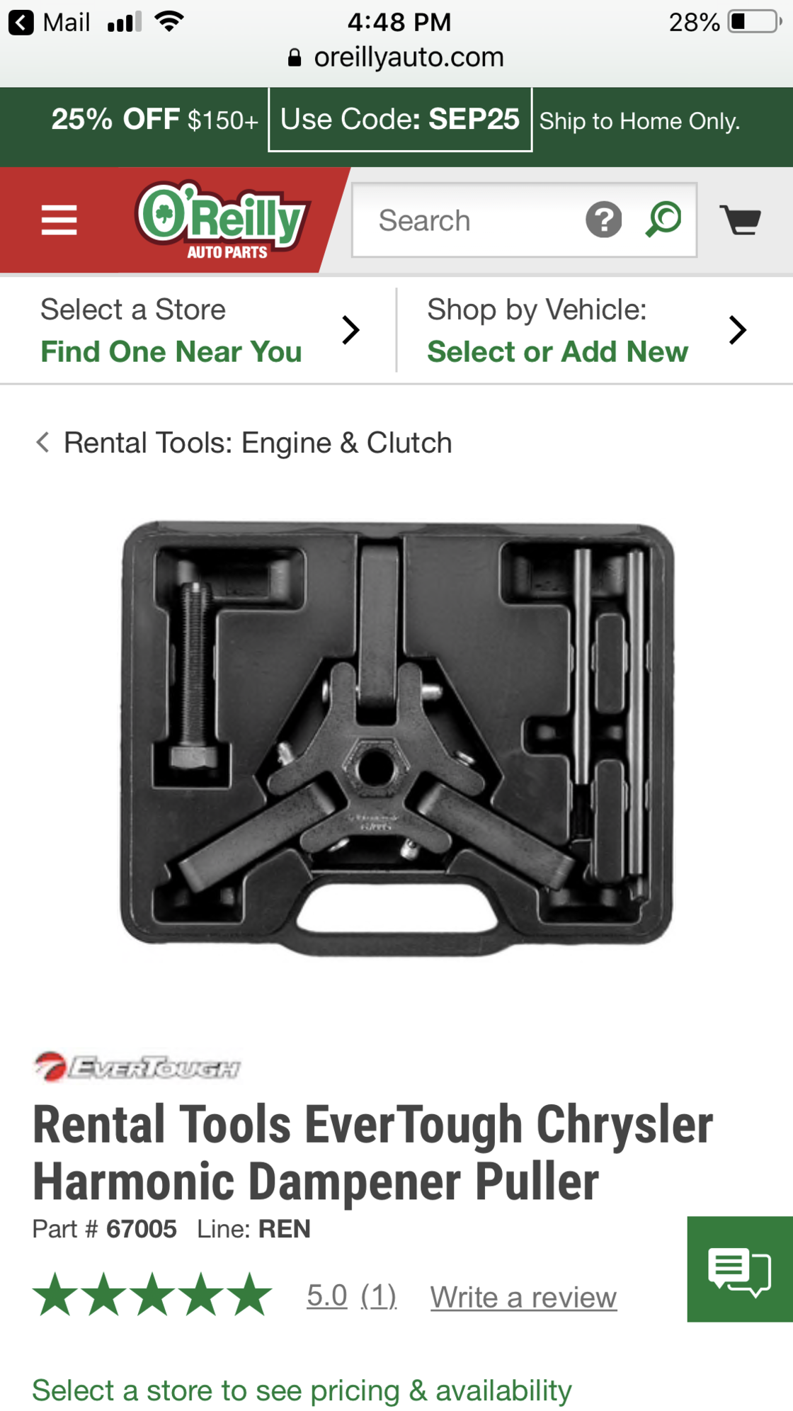

FYI some places refer to them as “Chrysler” pulley pullers...

O'Reilly's has a small and a large balancer puller so get the large one. You may have to flip the arms around on it to make it grab the balancer correctly.
This is the one I bought, I think I paid $45 for it, It works great for the LS balancer.

Good to know I may just buy that puller. I've always rented the O'Reilly ones and got my money refunded to me once I returned it.

I rented them a handful of times until I finally just bought my own from Amazon. I haven’t used the one I bought yet lol...

i tried that one didn't work the rods were to short i brought one that had four rods and that one worked
