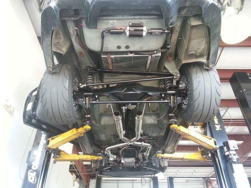

Originally Posted by AnotherWs6
This guy is the fng winner. Info on setup/sizes?
Thanks! Car is exactly how I always wanted.
MWC fab 9" shortened 3" per side.
Viking coil overs on all four corners.
Billet Specialties Street Lites double bead lock.
Rear rim - 15x10 5.5 bs - 295/55/15 Mickey Thompson ET Street radials.
Front rim - 17x7 - 225/50/17 Nexen
A bunch of hammering, cutting and cussing to fit. Running Strange rear brakes to fit. All the work was worth it.

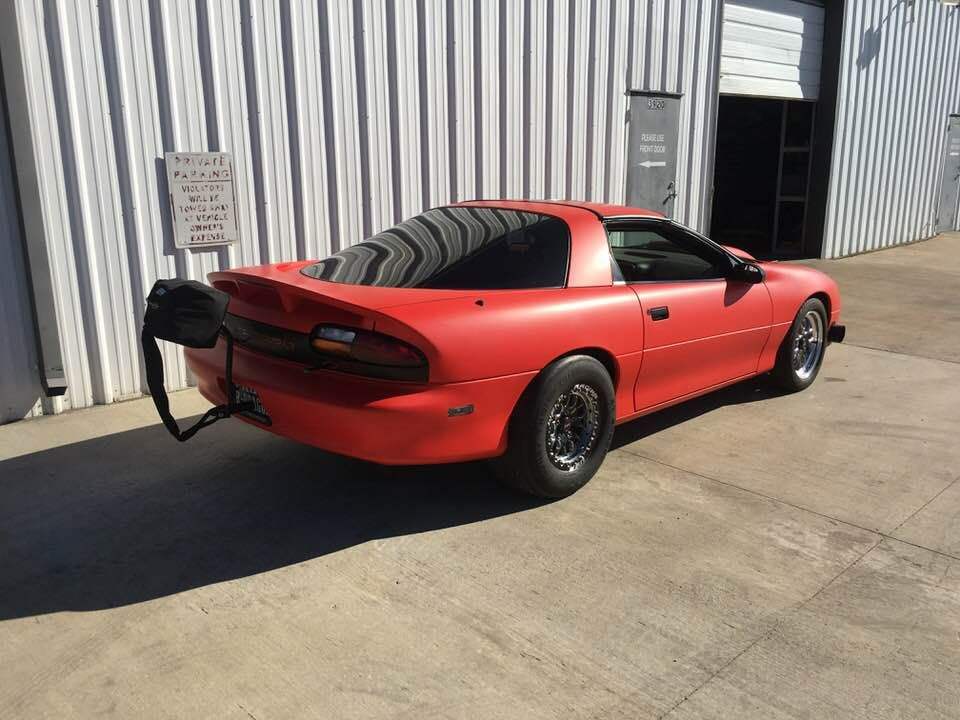

here is mine

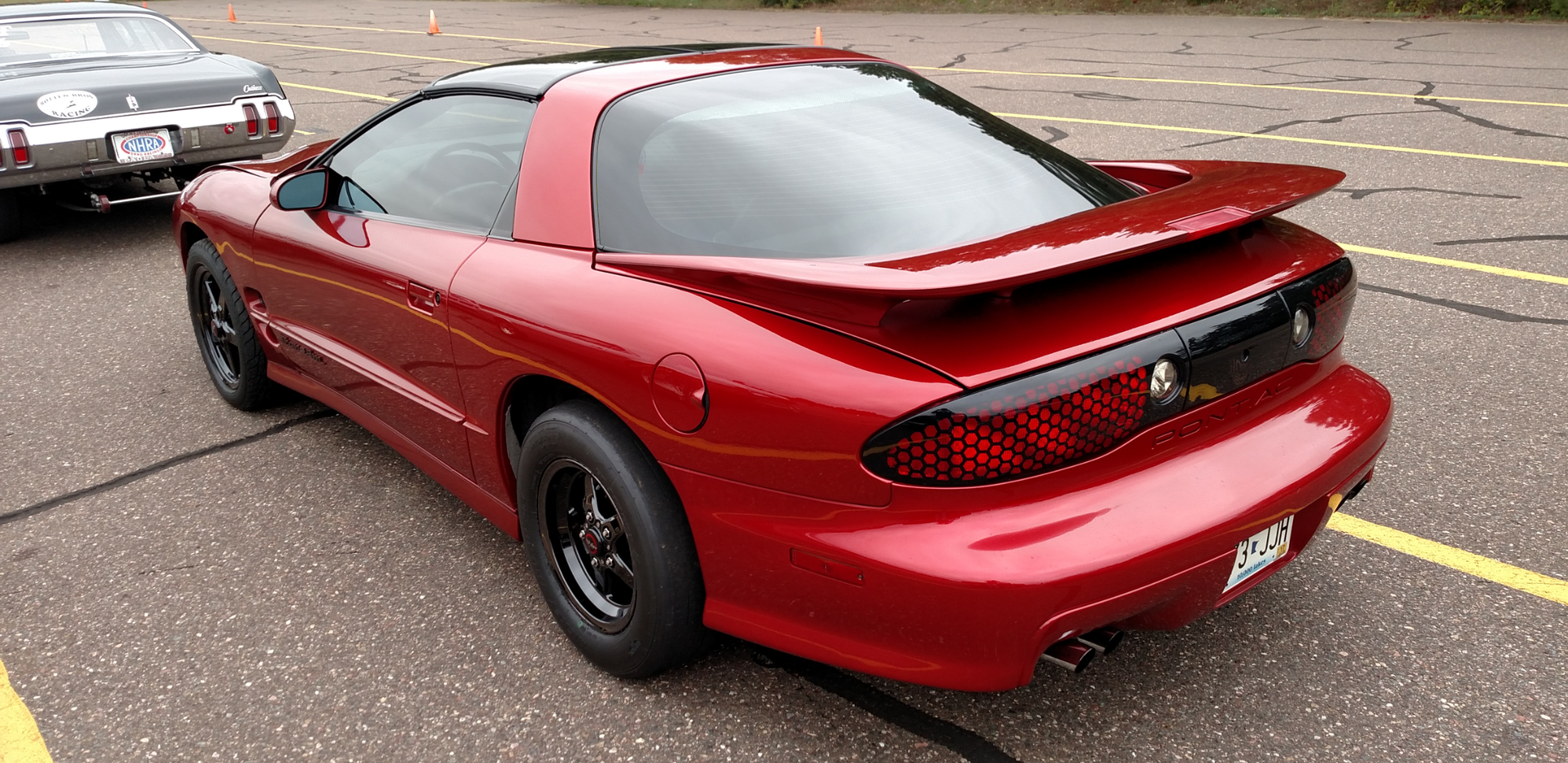

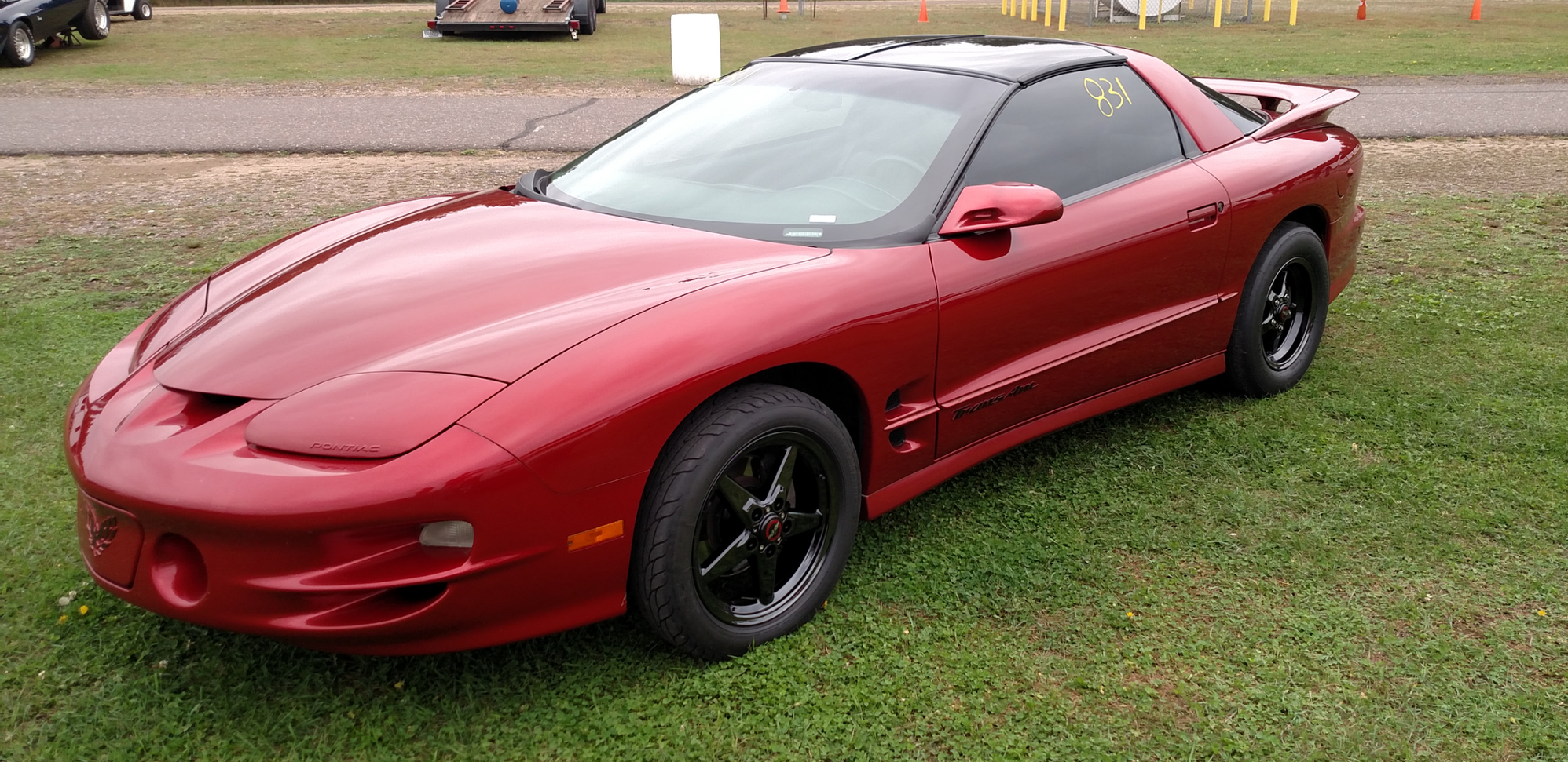

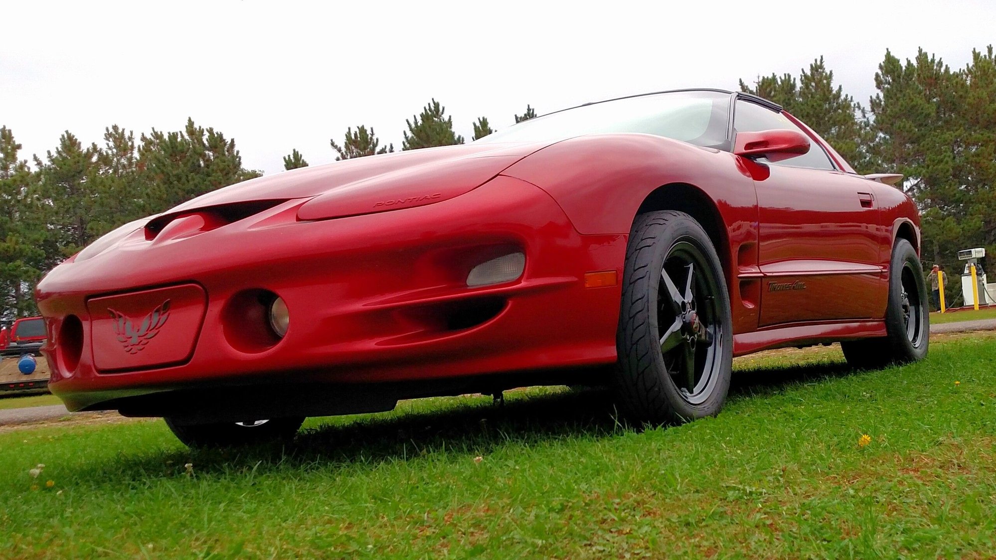

I don't care much for the black look on my car but here is my buddies dark stars on my car.
