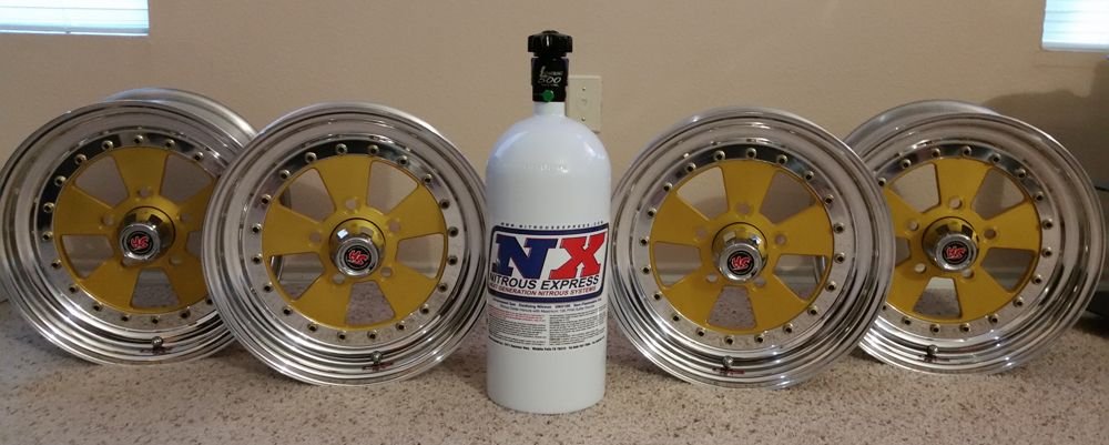

The wheels for my semi-daily Formula came in yesterday....
Holeshot Sun Flare's w/ Gold Centers
Front: 15 x 4
9lbs w/ center cap
Rear: 15 x 10
14.4lbs w/ center cap
I'm very impressed with the quality of the product! Tires should be here next week and I'm looking forward to seeing them on the car!

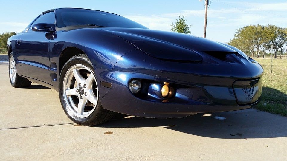

Those are pretty sweet. What color is the car these are going on?

Nice car. What did those wheels set you back?
Old Jul 10, 2015 | 01:12 PM
NitrousExpress's Avatar
Ls1tech & Truck Sponsor
Joined: Jun 2010
Posts: 2,267
From: Wichita falls Texas
Thanks!
With the anodizing and getting the rears made with a thicker center section than normal it was a little over $1700 w/ shipping.

What brake set-up are you running?
Old Jul 13, 2015 | 03:46 PM
Joined: Jun 2010
Posts: 2,267
Factory style brake setup. The car has already had multiple wheel styles on it from 15in prostars etc.. to 17in Fiske's on it so I shouldn't have to do any grinding but we'll see. I'm going to test fit them tomorrow and tires should be here on Wed.

Wheels are on... [ No center caps in these pics ]
Had to grind a little on the previously ground brakes but that was about it. I did have to clearance the front of the inner fender wheel well. No spacers used in the back....
For the fronts I didn't feel like grinding on the brakes since we were going to track later that day so I got a 5/16 spacer and no rubbing at all.

What suspension do you have on the car? I think it looks money to me.
Old Jul 29, 2015 | 04:39 PM
Joined: Jun 2010
Posts: 2,267
Thanks guys! I'm really digging them. As with everything.....they look better in person on the car.
Rise of the Phoenix... The car still has the factory shocks n springs in the rear. It does however have a factory width Moser 9in, Spohn lower control arms, Spohn panard bar, and an aftermarket swaybar. Front suspension is all factory.
