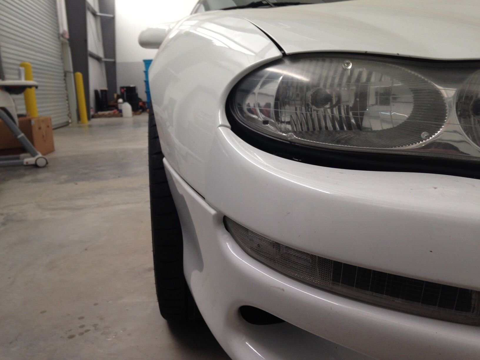

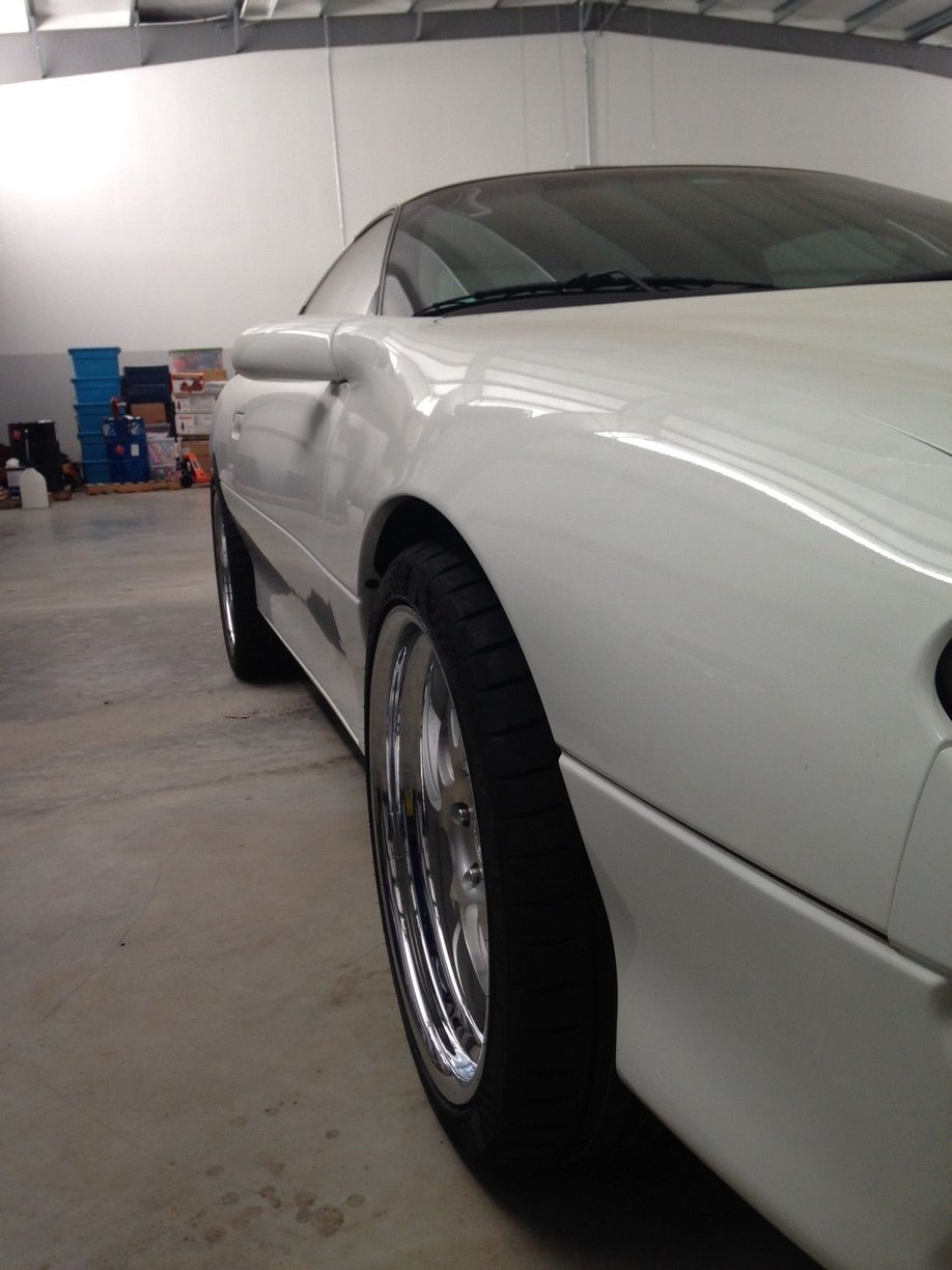

if you are wanting 315's I would go with a 11" wide wheel, max I would go on a 10.5" wheel is a 305. I have 295's on a 10.5" wheel and it is pretty much perfect. but that also depends on the tire brand as well, some run a little bit bigger than advertised and some run smaller. this is what my 295 nitto nt05's look like on a 10.5" wheel
