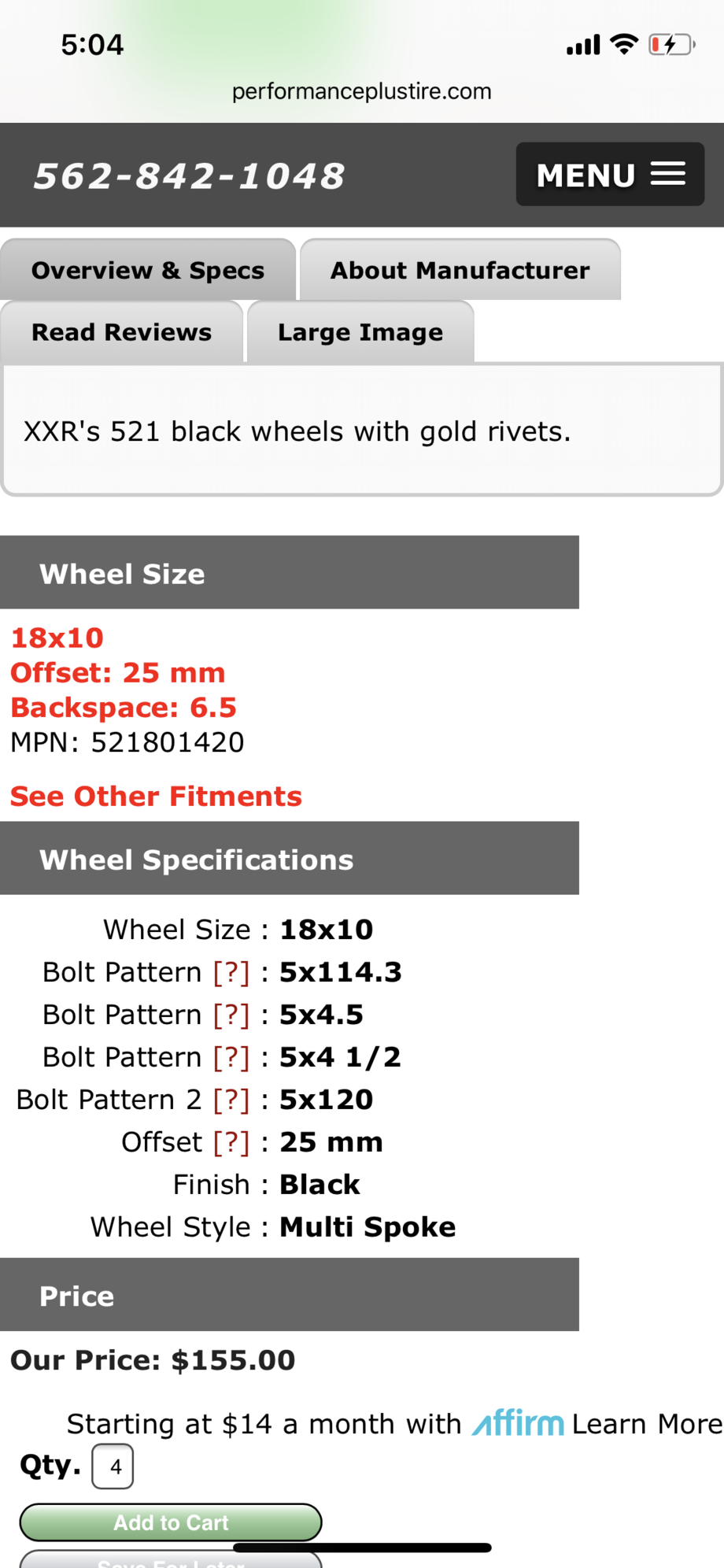

Just wanted to know if these would be a good offset for my 1999 Trans Am. Kinda new to offsets on wheels so I don’t really know what to go with any info would be great. (These wheels would go on all 4 corners)

They wont fit properly. They will stick out like hell - (probably over an inch out the wheel wells)
+25 is waaaayyyy to small an offset. +38 minimum.

My C5z speedlines in 18x10.5 (~56 offset) with a 15mm spacer equals to about 41mm offset and they poke out of the fender.
I would agree with around a 38-40 offset.

18x10 +35mm, 275/40r18 (almost an inch taller than stock tires), lowered on Strano's, fender's are not rolled, zero rubbing. I do believe +25 would be pushing the limits a bit too far and they would most certainly be more than flush with the outside of the fenders.
