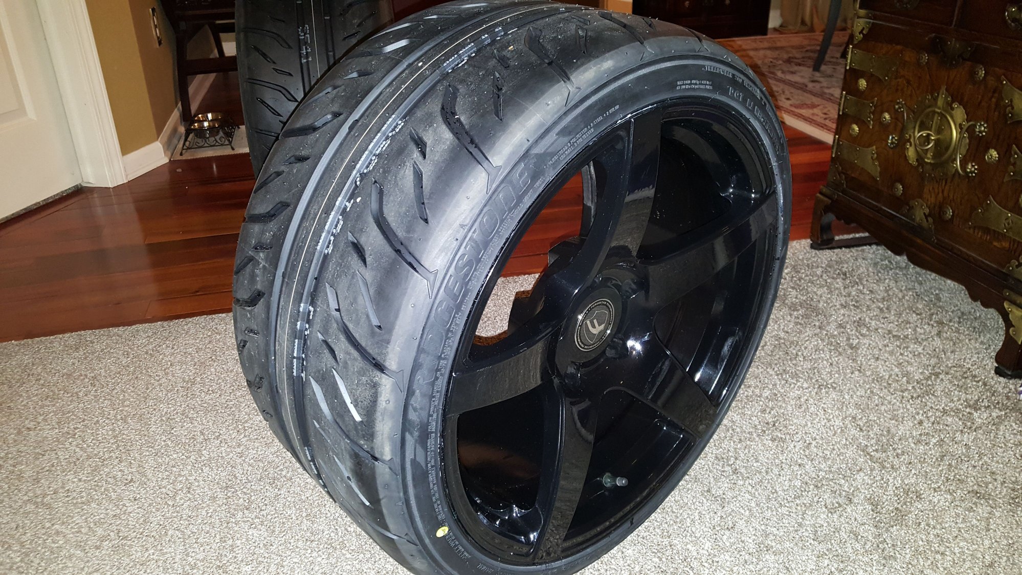

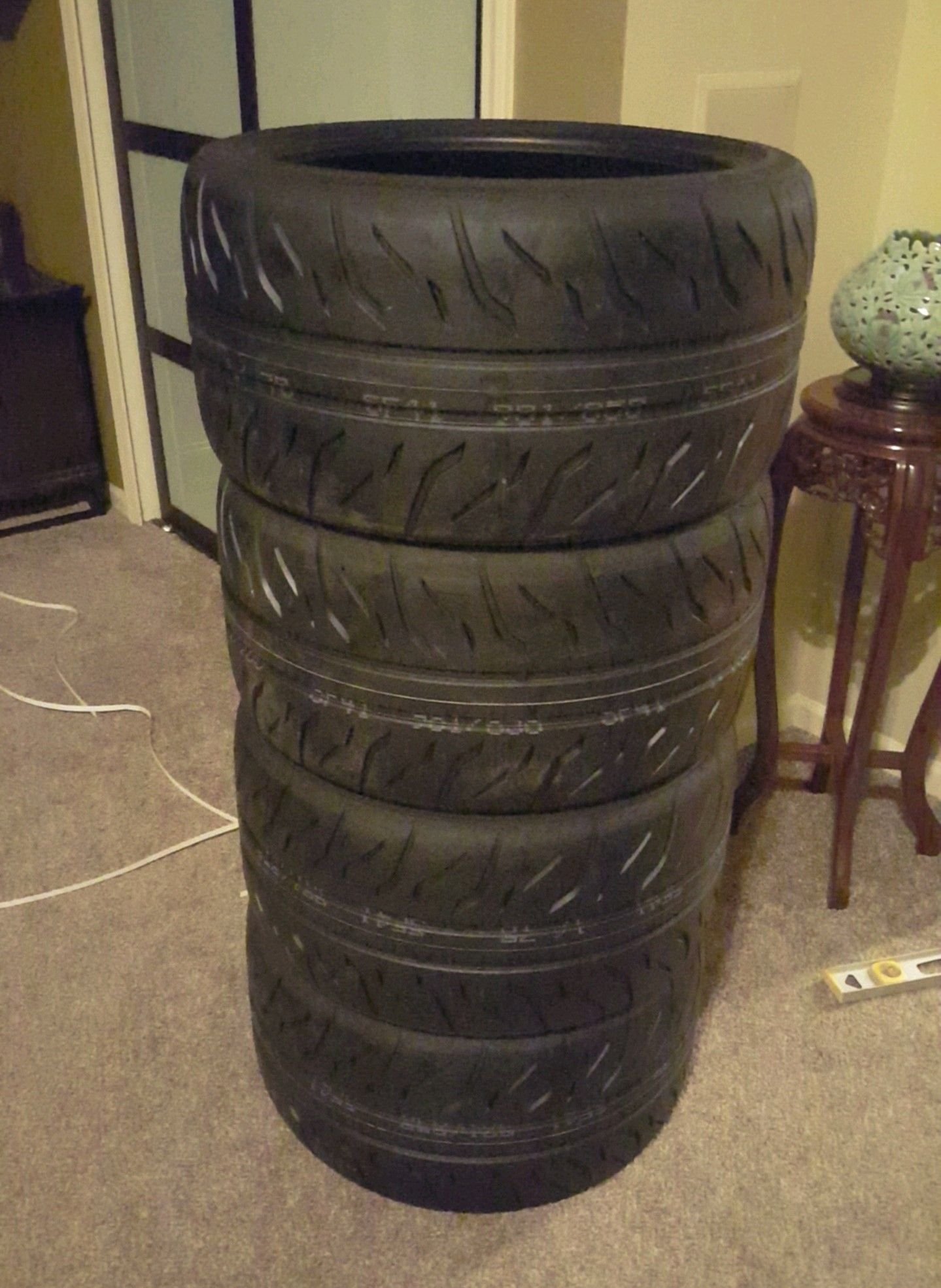

Ok so there was a sale so I bought some 285/30R18 RE71R. I don't have them mounted yet, but I thought I would share how big these are. The stack of tires was 47.5", so very close to 12" each (unmounted). Also I had concerns mounting on my 11" rim. But the distance between beads on these is 10 3/4". Super short tire unmounted as I got 24 1/4".
Anyone have a pic of a 285/30R18 on a vehicle? I'm curious if these are going to look dumb because of the small diameter... I may just mount a pair now since I'm impatient for spring.

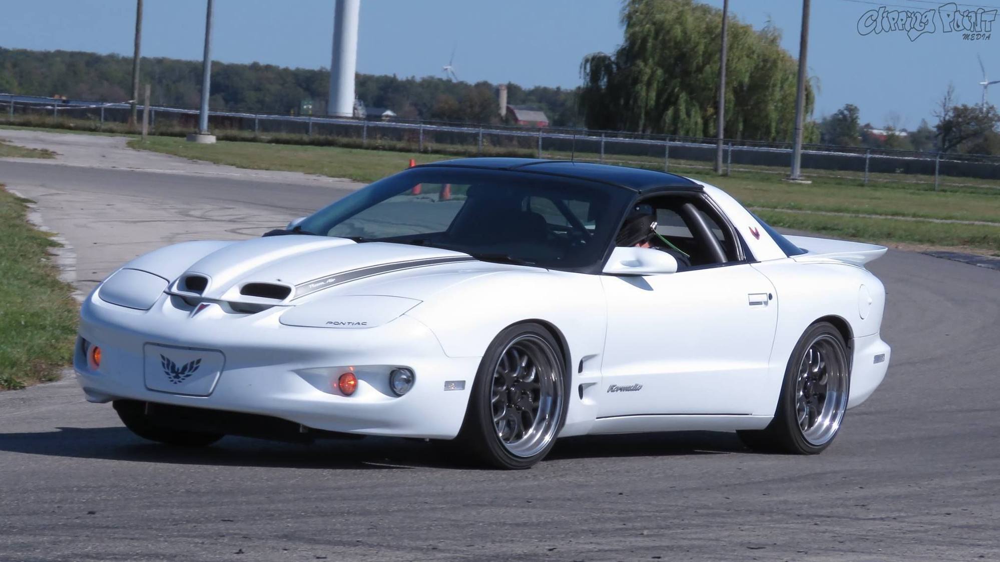

295 30 18s on 18 x 11s. 25" tall.

Hmm, that looks pretty good. Not so concerned now. What tires are those?
Yokohama, AD08Rs.
