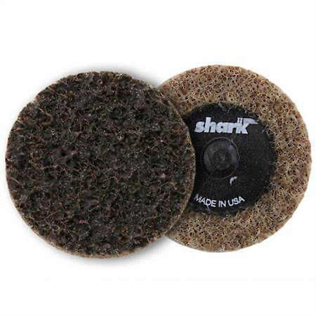

I see this all the time in the shop. I usually put the wheel on the tire machine and use a brown cookie (Roloc disk) on my little Sioux air angle grinder. I use the machine to keep the wheel slowly I'm rotation and just go around the wheel grinding all of the peeling chrome and corrosion free from the bead on the wheel. It takes a couple of minutes per wheel this way and there's no damage done to the wheel and the wheel faces are never touched. I couldn't imagine hand sanding this crap off. After it's done the beads are clean and seal perfectly again but you could use some bead sealer if you're really ****. I very rarely ever find it necessary.
These are perfect for the job.
