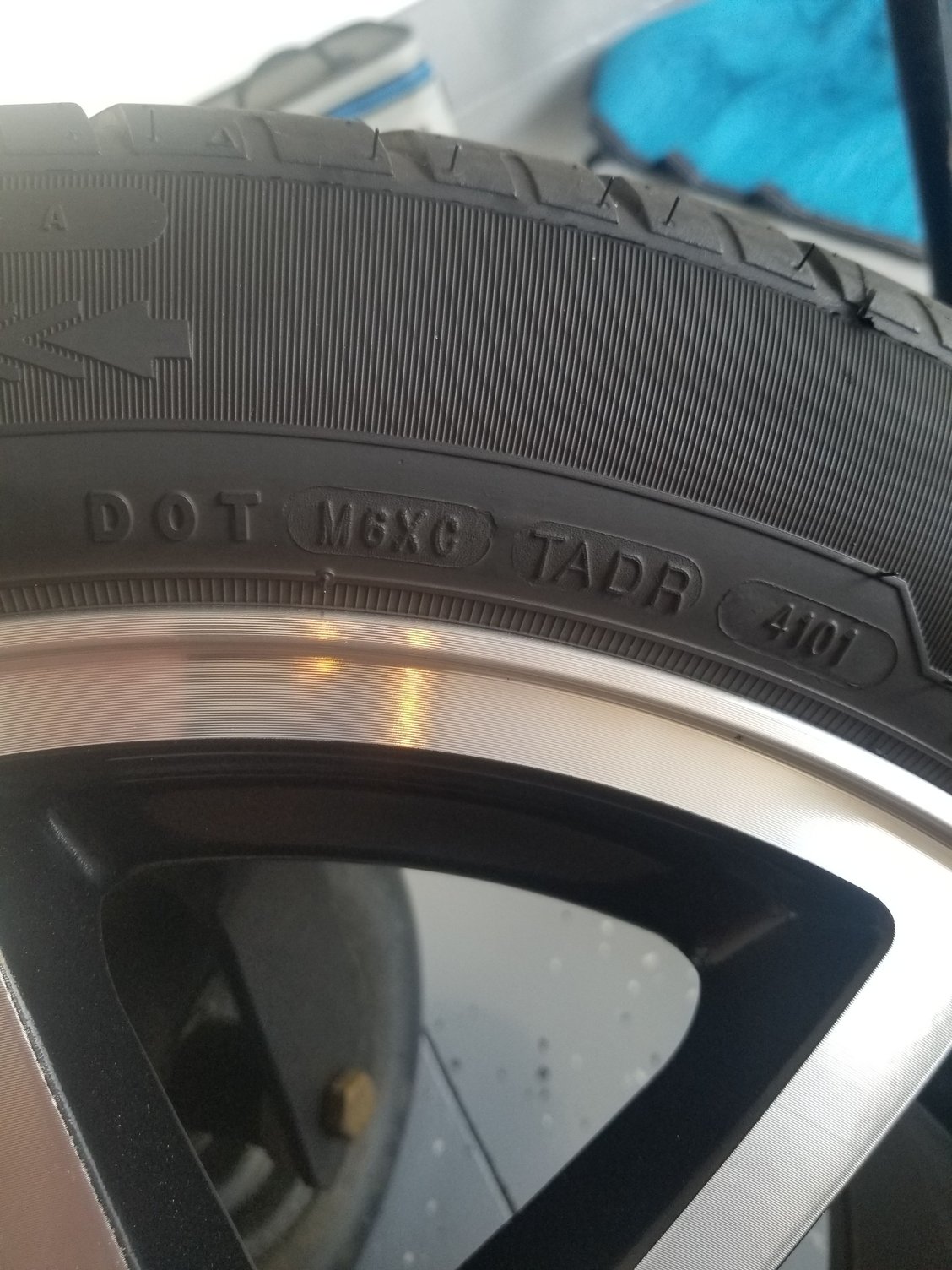

Hey team I'm sure someone on here just knows this off the top of their head....what is the date of these tires on a car I purchased? The guy I purchased car from on ebay said he just put new tires on it this Spring.....but I dont really believe any of that. Pretty sure they are from 2001....any help is appreciated.

Your suspicions are correct, those tires were manufactured during the 41st week of 2001. So they are ~20 years old no matter when he installed them. Looks like they are on a 35th anniversary wheel, so they are likely original to the car and were installed by the factory.
If he actually claimed in the Ebay ad to have installed new tires in spring of '21, it would certainly be fair to document this falsehood in any feedback that you leave for the seller.
