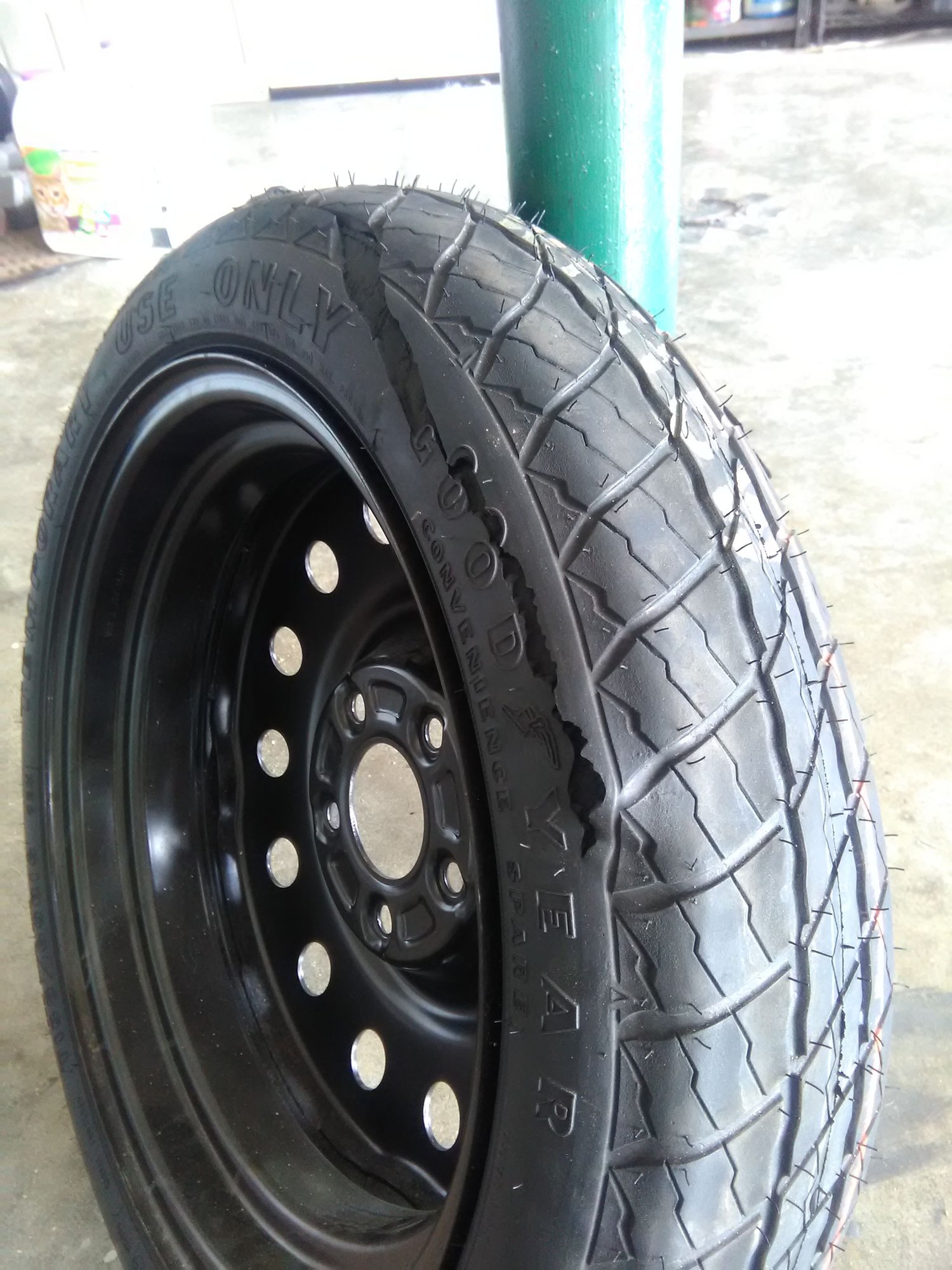

I wouldn't consider using a 20+ year old tire anyway. Here is mine just from being old, never used still has the **** on it. I pulled it out and replaced with a small duffle bag and some tire plugs/tools/rubber cement and two cans of fix a flat and two cans of tire inflator. I figure if it's worse than that AAA can deal with it.

Not to restart the whole "old tire" debate but, FWIW, I still drive my '98 to local shows on 17 year old tires. I wouldn't take a cross-county road trip on these, but for my purposes (and especially knowing how I've maintained these tires over those years) I don't worry. I know several guys that still drive to local events on assembly line tires from the '80s & '90s on their super low mileage B/F/G/Y bodies. Excessive heat from chronic underinflation (which is typical with limited use cars that are often neglected in this aspect) is the most common reason for failure, but the higher the speed rating the more resistant to heat a tire will be.
With that said, these donut spares weren't built to the specs of a full-sized Z-rated performance tire in the first place so they're definitely not going to hold up as well at this age.
This is bizzare. I would think the tire should be fine if left mechanically alone and maintained. (It should be pretty good, kept out of the sunlight.)
This is actually the second time I've heard of one exploding while in storage in the factory compartment. I guess it's just a result of certain heat-time exposure. I don't think these were manufactured very well, as I've seen a TON of ancient cars ('60s/'70s) with original full-sized spares still in the trunk, never used and no signs of physical damage like this. And many of those weren't even steel belted nor high-speed rated.

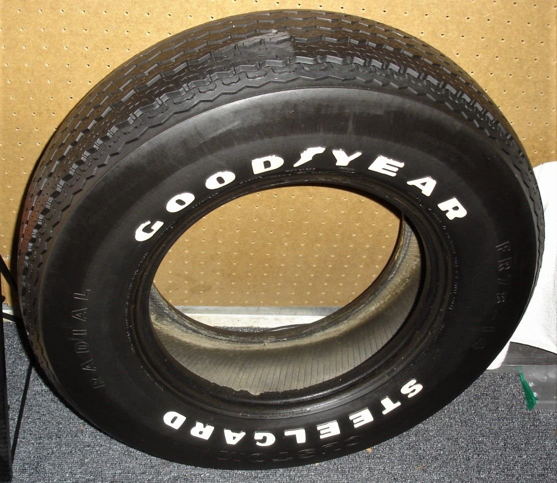

The spare in my 1974 AMC Matador X trunk was looking good but the area near the bead was shot. Not bad though for nearly 50 years old. the car was mainly owned in Minnesota and Washingto state before that (cold states for sure). I kept the tire as garage 'art'. Loved the radial edge look. A newer spare went with the car when I sold it.
