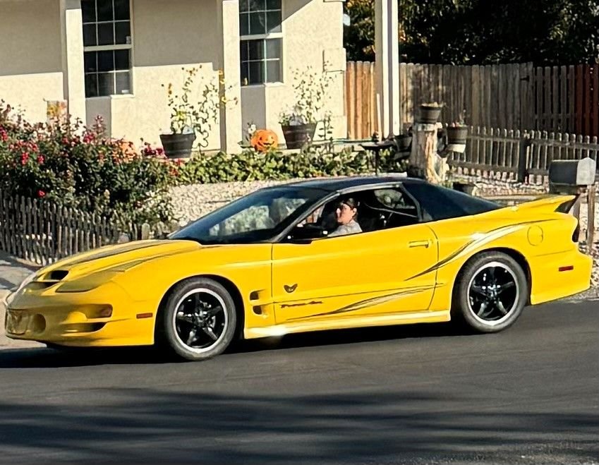

Just picked up a 2002 CETA. looking for what others are running for rear tire and wheels? wanting to fit a wider tire for when i build a motor for the car. Wanting to have plenty of traction and still handle well.
