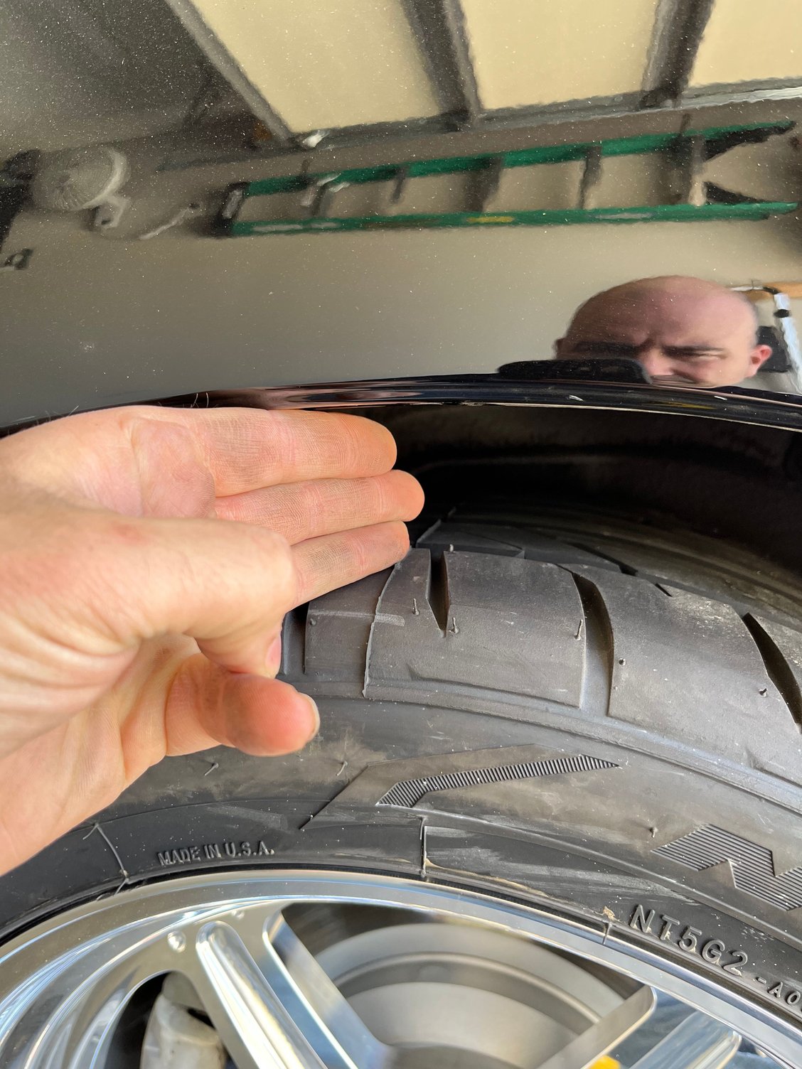

My 2001 WS6 M6, running the standard 275 tires. With TC turned on, it takes me a little bit (not much) to slide the *** end around.
The 2000 WS6 A4 (which we posted on in Dec) , has Nitto NT555 315/35ZR17. These tires slip and slide all of the F'n place. I can not make a left or right turn, with good acceleration, without managing the *** sliding. Even just a quick straight line, take off and these things are sliding, and lets not talk about a wet road. These tires half 6mm of tread left on the, which is around 50% of their life.
Now, the car was owned by and older guy, garage keep, 65k miles when I got it. I guess these tires could just be a bit old.
What tires would you recommend for daily driving? I have not yet done the Adj Pan and control arm mod, yet (spent to much money at Christmas), so this could still be the issue too.

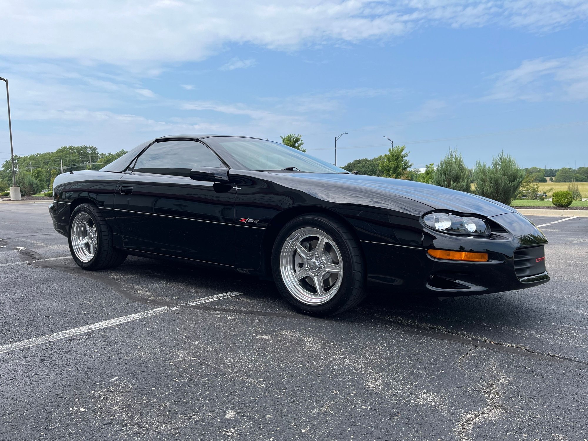

You can absolutely fit 315's on 17x11 wheels on a 4th generation Camaro. That's what I'm running on mine. I didn't need to hammer anything or cut anything. The only thing is the bump stops may be a problem, but my were so worn down that they aren't interfering with anything. My suspension is nearly stock. I do have aftermarket lower control arms and an adjustable panhard bar but that's it. Rear end is stock and I'm not running any spacers and I didn't have to roll my fenders.
What wheels are you running and do you remember your specs for the rear wheels as far as backspace and offset?

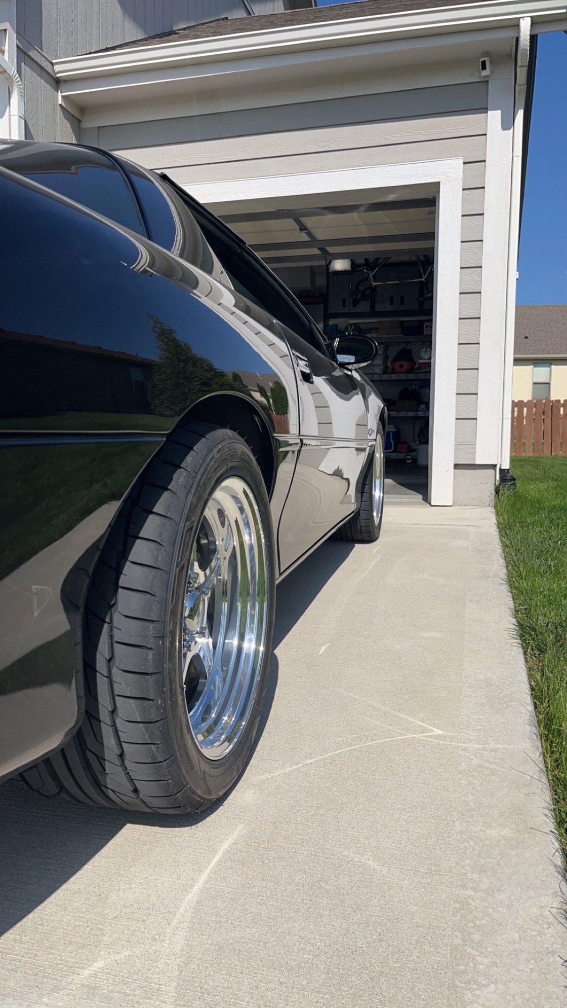

Im not running Welds. But, I went with a 7.75" BS out back with a 315 and didnt roll or hammer anything. Clearance inside is perfect and touches nothing. Still havent had an issue contacting the fender lip either.
