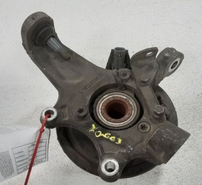

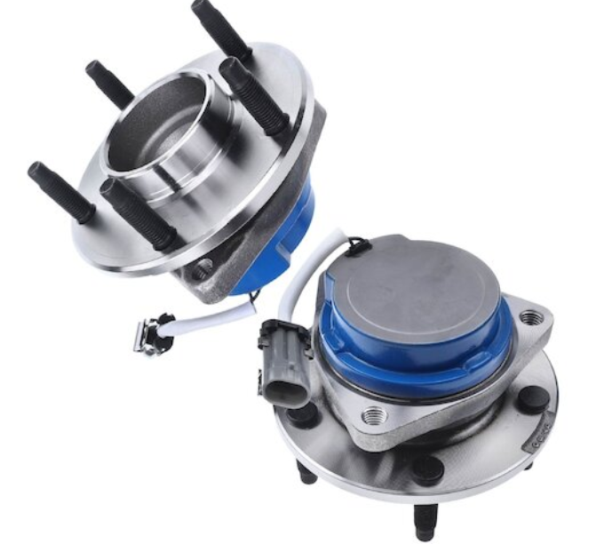

^ That's the rear. The fronts should pop in/out in 5 minutes.
Front:
Rear:
I'm not a fan of the hammer due to the stress it puts on other components. (Especially if we miss...) I prefer renting (for free!) a ball joint press and using that:
