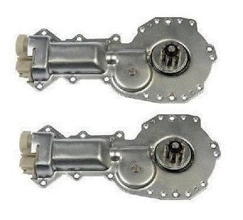

I think they also sell remans for the old design. I don't see the new design on their site, so it could be under a different brand name, now. The new design looks like this:
vs. the old:

I did not pick one up from the store, I pulled it out (AC Delco) of our totaled Bird that was in use about six months. Works amazing compared to the stock one, while I had the panel pulled I fixed the crack in the panel.......was a good day!
I thought the stock one would be AC Delco, but it was not.
