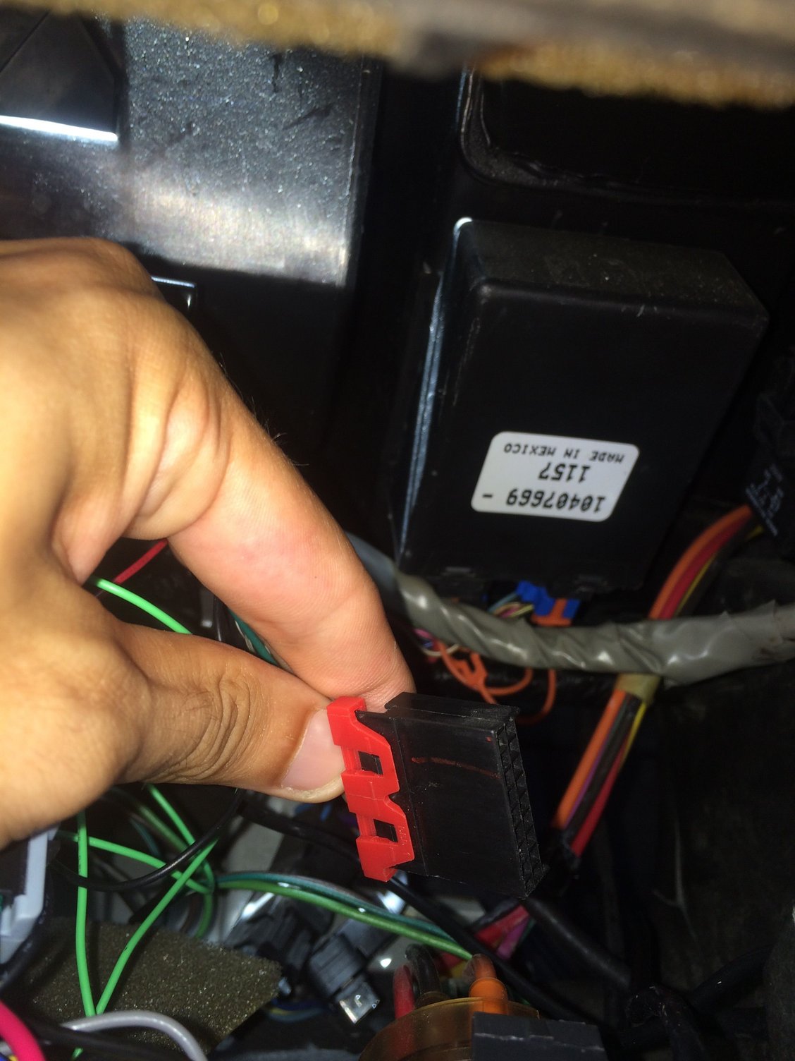

Yup I'm sure. Not blowing out of anything.. I did see however that the black wire from the stereo are spliced together into the harness, shouldn't one be grounded?? Can that be the culprit?? I'll post a picture tomorrow cuz I don't think I can exain it rite
Old Jul 21, 2015 | 07:11 AM
WhiteBird00's Avatar
Ungrounded Moderator
Joined: Nov 2003
Posts: 11,332
Likes: 347
Not necessary. The black wire in the factory radio harness goes to ground. So if the head unit and any accessories like a steering wheel control adapter are spliced to the black wire in the harness then they already go to ground.
There is very little you could do when replacing a head unit that would cause a failure of the HVAC system. About the only thing I can think of is possibly disconnecting the plugs on the HVAC controls below the head unit opening. For example, if you unplugged the fan switch then you wouldn't get any air movement.

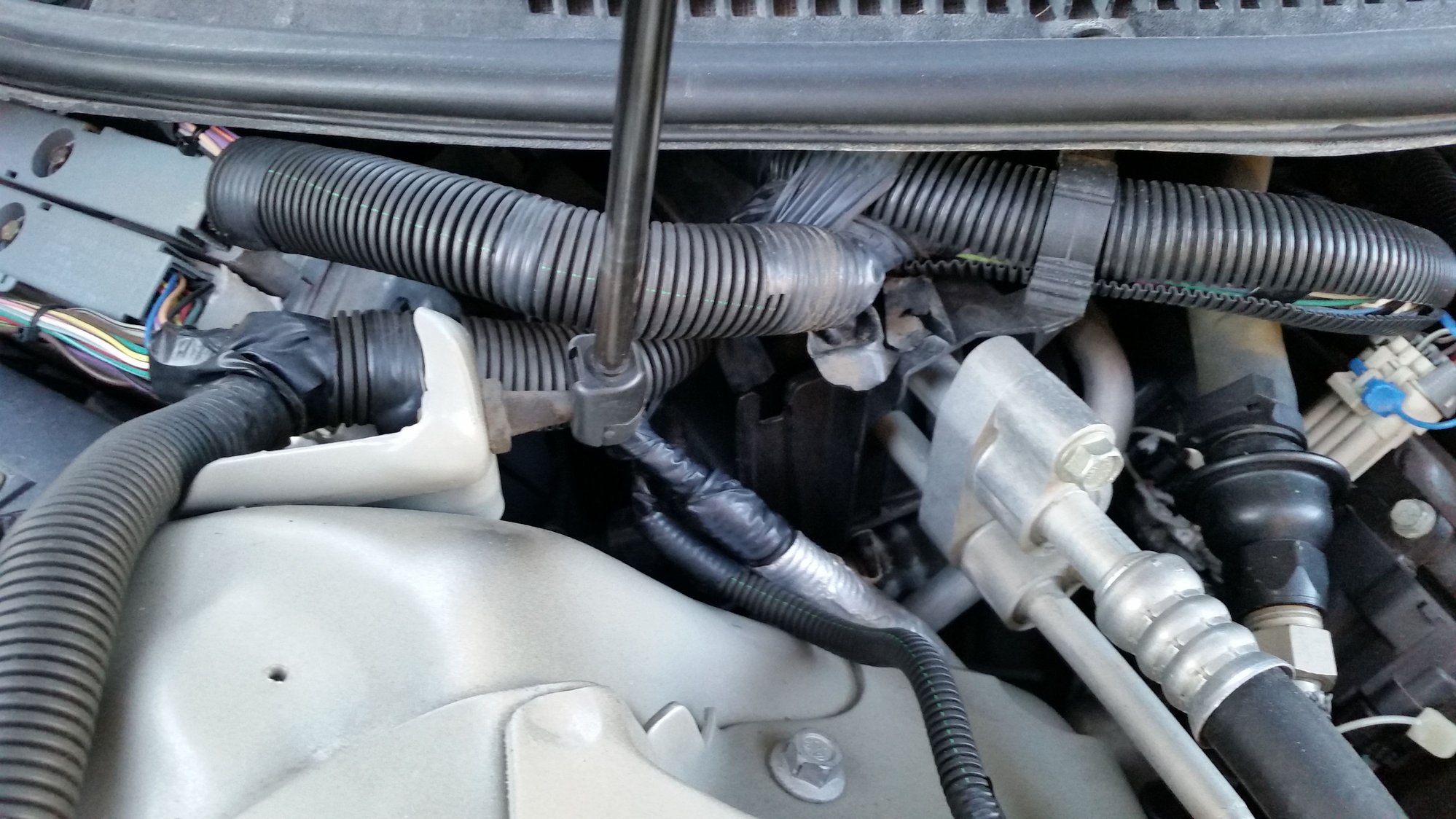

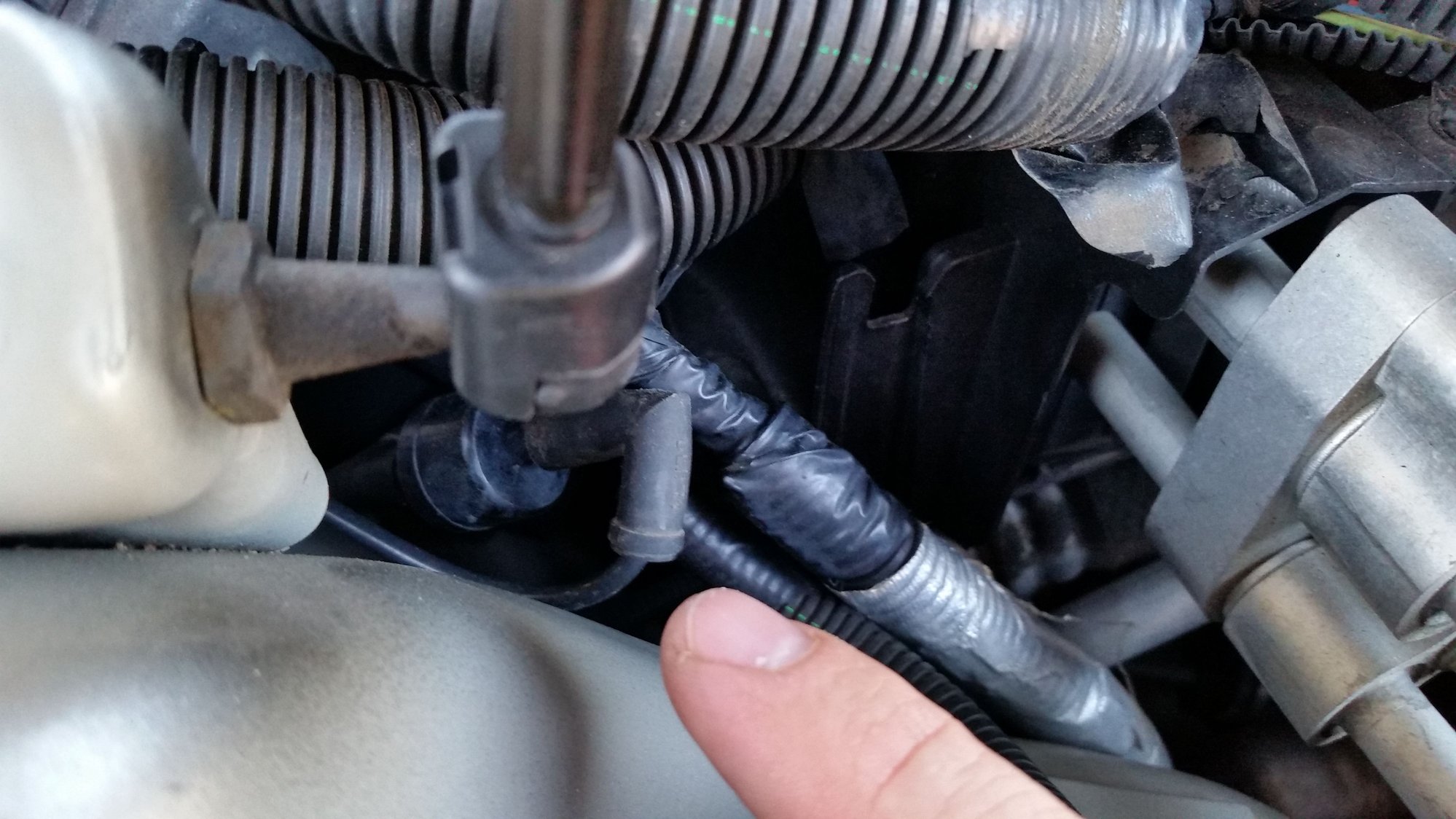

If it's only blowing through the defrost and feet then that IS the vacuum leak I was talking about. Common issue. Small plastic lines exposed to high levels of heat over a 15 period. They break. The valve that switches the ac from floor to the front vents is vacuum operated. If the is a leak. It won't switch.
Old Jul 23, 2015 | 08:46 PM
FraziaFraz's Avatar
Joined: May 2014
Posts: 64
The vacuum lines you want to find are located behind this mess on the passenger side of the engine bay.
Look behind the wire looms and you will find this plastic piece with 3 vacuum lines that run in/out of it. Trace them to your problem.
