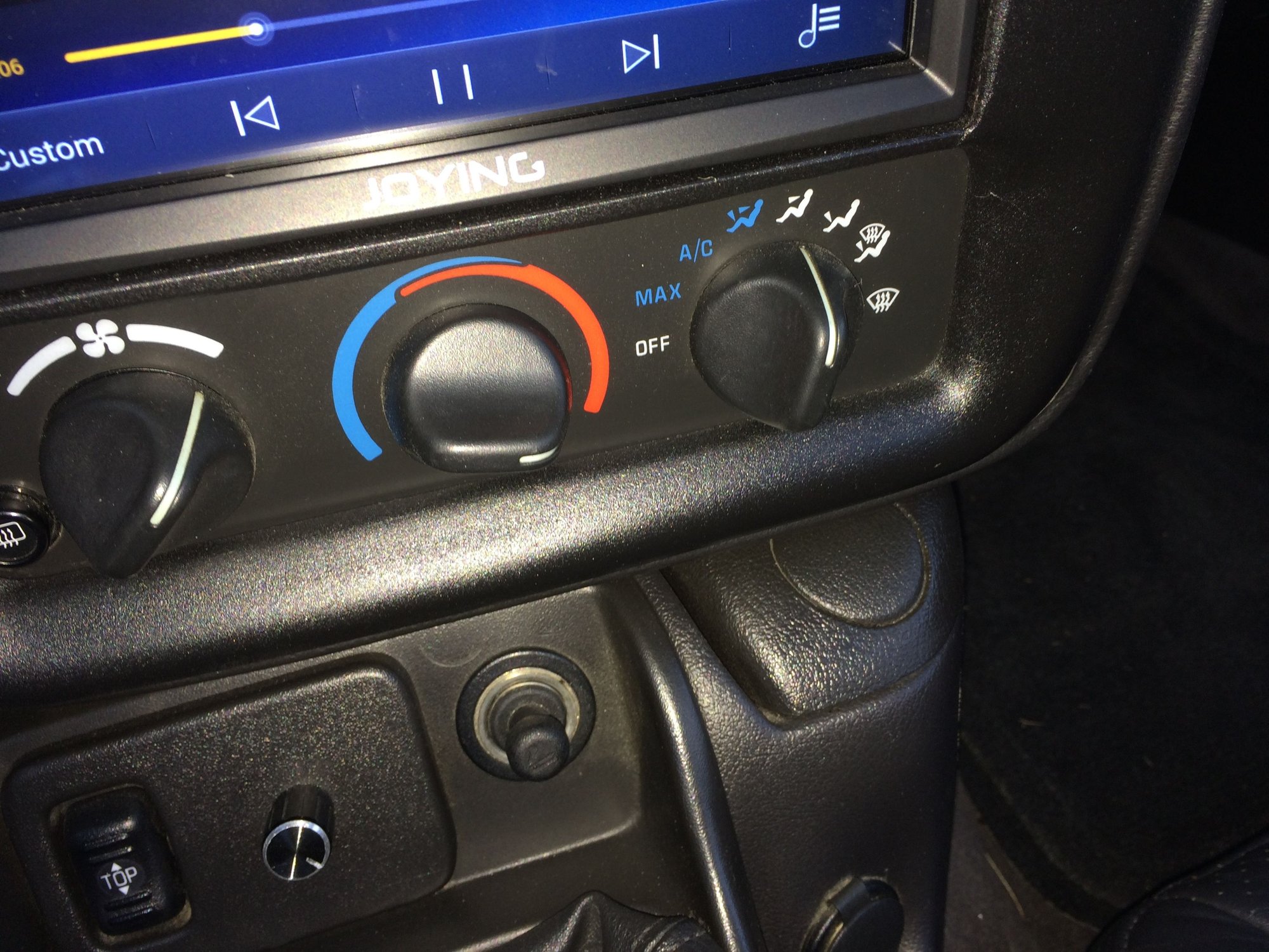

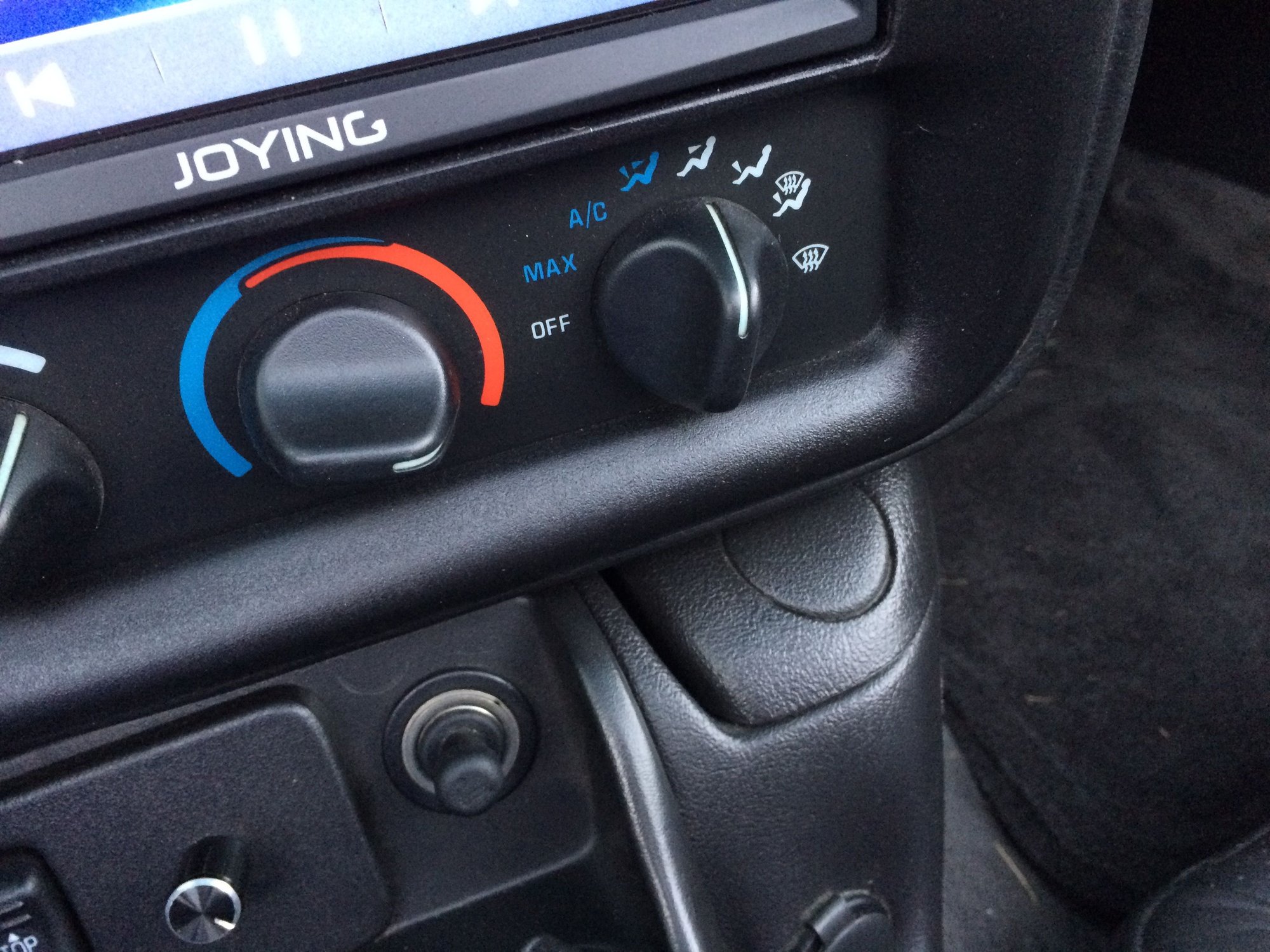

OK, so here you go...I used SEM SEM 15013 Landau Black Color Coat aerosol spray. It was really easy to do...just held the can a good 18"-24" back and did several (like, 10-12) very light coats to give it the texture. I had sanded this bezel down smooth before applying it to ensure it'd be even. all the texture is truly from the paint - no additional "texture" material or coating was added. Just the sanded bezel and paint. I didn't even sand it that well, just knocked it down quickly with some 220 grit. Honestly, it was very easy to do. I am far from a pro with stuff like this.
Also, I didn't spray the vents, so you can see how close the color is. I would say the color is VERY close - just a little darker than the factory color. In bright direct sunlight (I am a 'vert), a little variation can be seen. Also, the texture is a little more rough than the console lid, but there's really no getting around that. I honestly think it's as close as it's going to get to a perfect match without being a pro.
I took a few pics, some with flash, some without just to try and give a good idea on how it looks.

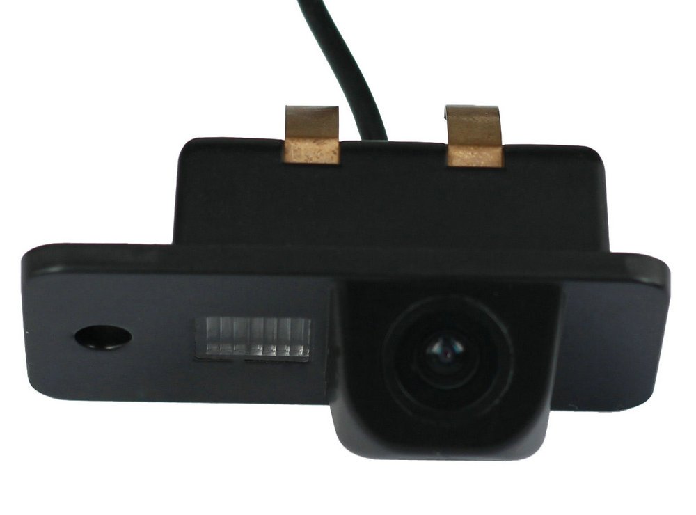

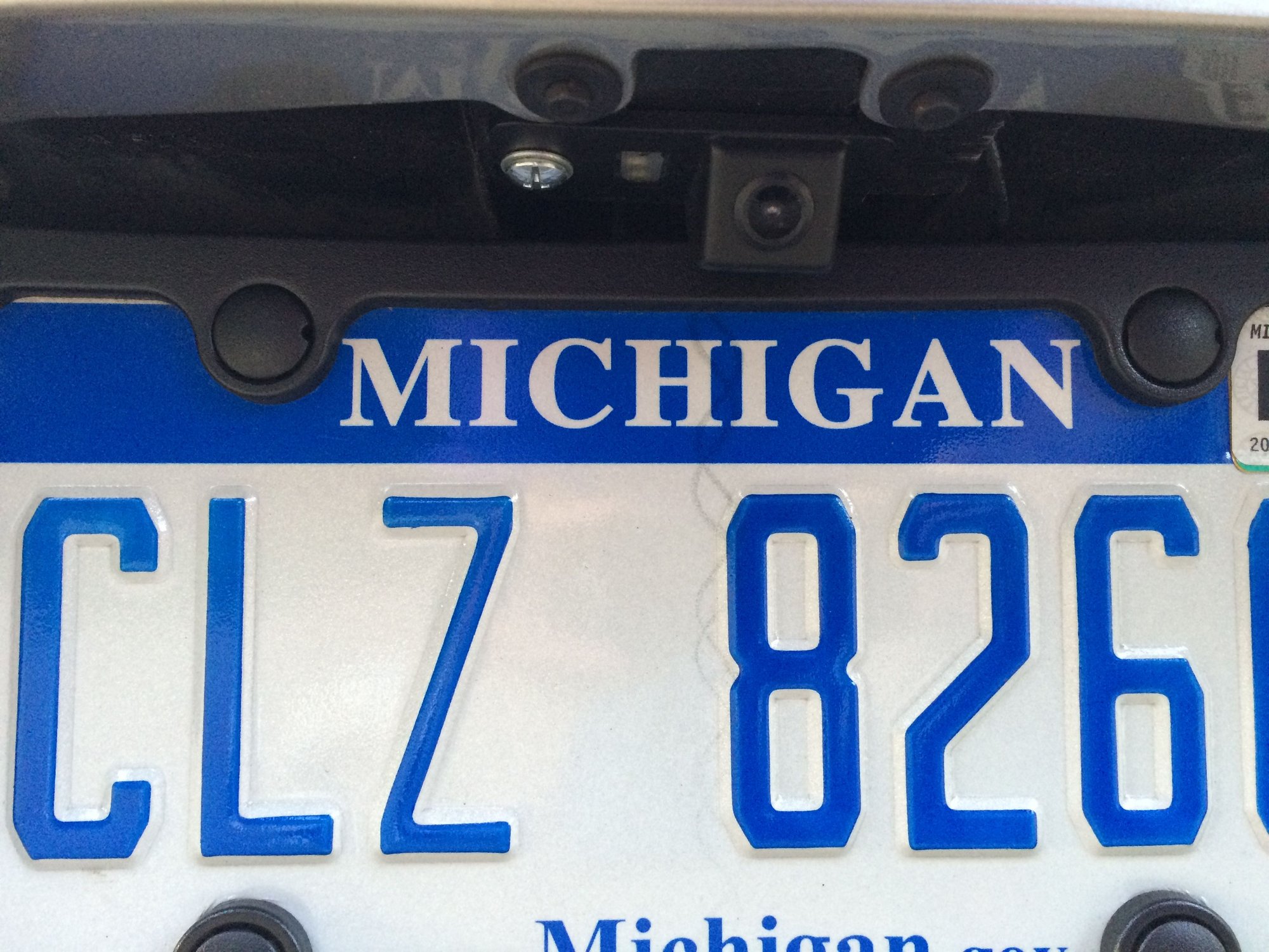

This is the camera I am using. I made a quick adapter out of a piece of thin junk plastic I had laying around - basically cut a slot of the camera to fit into, drilled holes for the mounting screws. I used the mounting points/screw for the standard bulb assembly. I purchased it off Amazon, it's a camera for an Audi. Description is "CAR REAR VIEW CAMERA FOR AUDI A3 S3 A4 S4 A6 A6L S6 A8 S8 RS4 RS6 Q7".
Works well, and really blends in nicely. The pics may seem like it stands out, but in person you don't even notice it - it's much more discrete and OE looking than the one that came with the HU.
It is mounted darn low on my lowered car, so I don't get the huge field of vision like I would in my '14 Sierra, but it's handy (especially in the 'vert with the top up) to see how close I am to a curb and whatnot. Even had a built in LED, but I don't care for the light pattern so I will be fitting an LED strip up there sometime.

I forget how easy us T/A owners have it for stereo installs, lol. That came out damn close to OEM! I really dig it and will be doing mine since it's an easy project. Thanks for the pics and info on it.

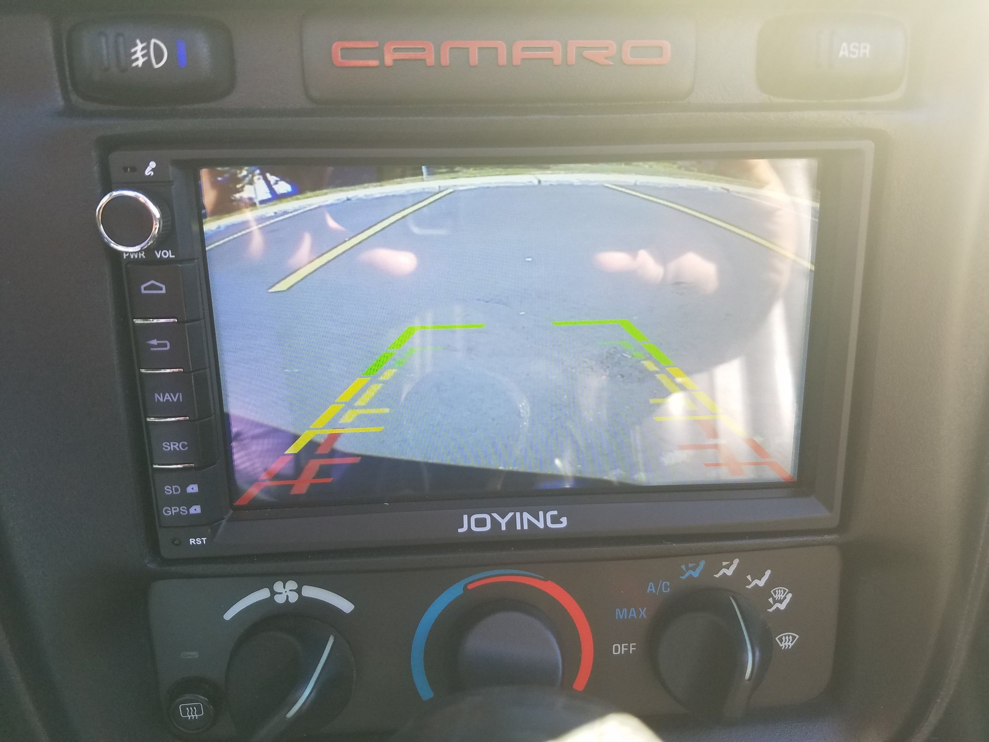

I definitely like that option. Firs thing I thought, where's the license plate light, ha. Happen to have any pictures from the screen of what you can see? Unfortunately for me, I won't be able to use it since I have the the LED board, but I can possibly modify it to use. Worse case it gives me an idea to find something similar and use the the factory plate light screws... Off to amazon/ebay I go! I ran all the required wires for a camera when I put in the amp/sub, I need to get on the ball and find something.
Old Sep 2, 2016 | 08:13 AM
  #145
Atrus_SS's Avatar
Joined: Dec 2012
Posts: 559
From: Metro-Detroit
I can definitely snag a pic of the screen in reverse when I head out on lunch today. I took those this morning at work in the parking lot (at the GM tech center, nonetheless)
Please do, I can't decide if I want one with a camera straight out back or one angled down. Both are good options, but curious to see the difference.

Old Sep 3, 2016 | 11:34 AM
  #148
InfiniteReality's Avatar
Joined: Apr 2004
Posts: 1,458
Likes: 14
From: Vinton, Louisiana
Thanks for that! Now I know an angled camera ia the best bet although both look good and have a good view.
