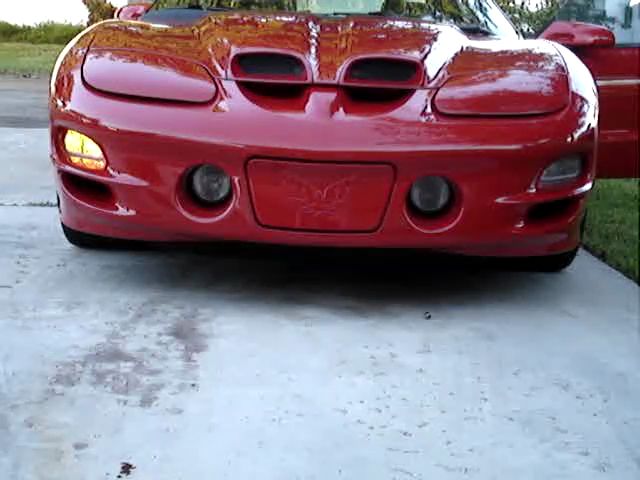

Thats what I did a long time ago. All switchbacks and LEDs still working great.
All the info and parts I bought are in here: Took literally 10-15 minutes to install it all.
https://ls1tech.com/forums/appearanc...led+switchback
Play video: This link.
http://vid263.photobucket.com/albums...lashersvid.mp4

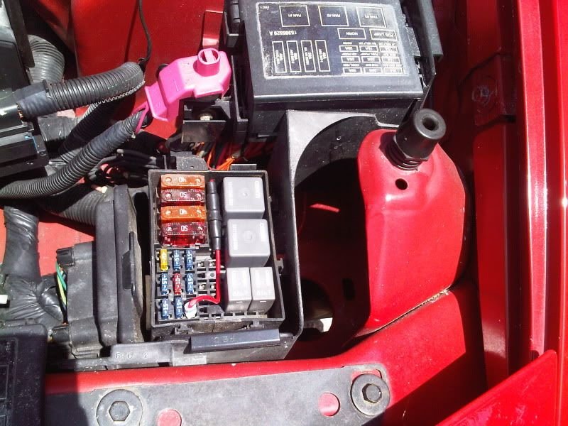

5. Under the hood, find an ignition switched power supply. You can tap into the CRUISE/AC fuse in junction block 2 or there is an empty slot next to the 15A starter fuse:
Thanks to member Danny2tek for this photo.
6. Run a fused wire from that ignition switched source to each of the two front lamps. A 5A fuse would be a good choice if you're running 16 gauge wire.
7. Cut the brown wire near each front lamp. Connect the new wire you just ran to the end of the cut wires that go into the lamp socket. Tape up the other ends of the brown wires so that they won't short out.
You now have white lamps that are on whenever the ignition is on - a close approximation of true daytime running lights. And you still have amber turn signals. The switchbacks will flash amber/off or amber/white depending on which type of switchbacks you bought. You can add a separate switch in your ignition switched power wire if you want to have a way to turn them off. Or you could get fancy and add a relay connected to the parking brake switch that would turn them off whenever the parking brake is applied (more like factory functionality).
