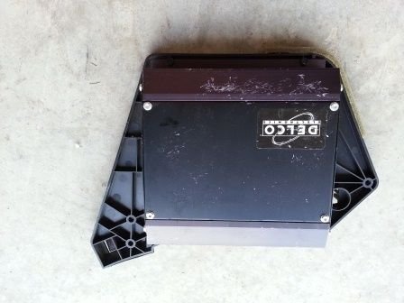

Not sure if you would need it, but if you find that it is the amp, I have one that has been sitting on a shelf in my garage taking up space forever (I sold my last 4th gen 7 years ago). It is one of two parts I've still got from my 4th gen days that after several failed attempts to give away has never found a home (the other is a factory radiator overflow / battery tray). Worked last time I tried it.
It's yours for free if you end up needing it as long as you pay the shipping to get it to you. Let me know (I'm almost never on here so forgive me if I'm slow to respond).

If that amp is from the '99 Camaro in your signature, it would work in the '97 Camaro he just mentioned but not in the Trans Am he started the thread about. Both are 8-channel setups but the channels are wired and filtered quite differently between Camaro and Firebird.

No it was not from my car. It was from a Trans Am. I got it because the Trans Am's were advertised as having a 500 Watt Monsoon system verse the 200 advertised in the Camaro's. I installed it and there was no difference so I took it back out, stuck it on the shelf, and there is still sits. I can get the PN off of it if that helps.

You're right, there is no difference between the so-called 500W Monsoon amp and the 200W version. The 200W rating is RMS while the 500W rating is a purely marketing peak or ILS (If Lightning Strikes) rating. They wanted the Firebird system to appear more upscale even though they actually produced the same amount of power. As I mentioned, there are differences in configuration but not in power.

Well if he needs a Trans Am amp, I have one he can have (can get the PN off if needed for verification it is the right application).
