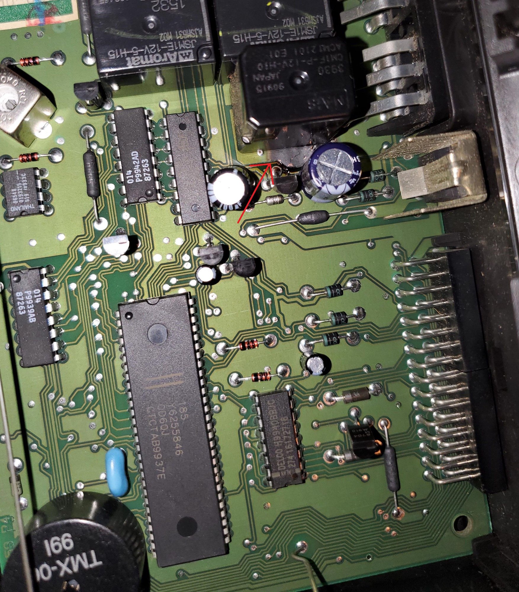

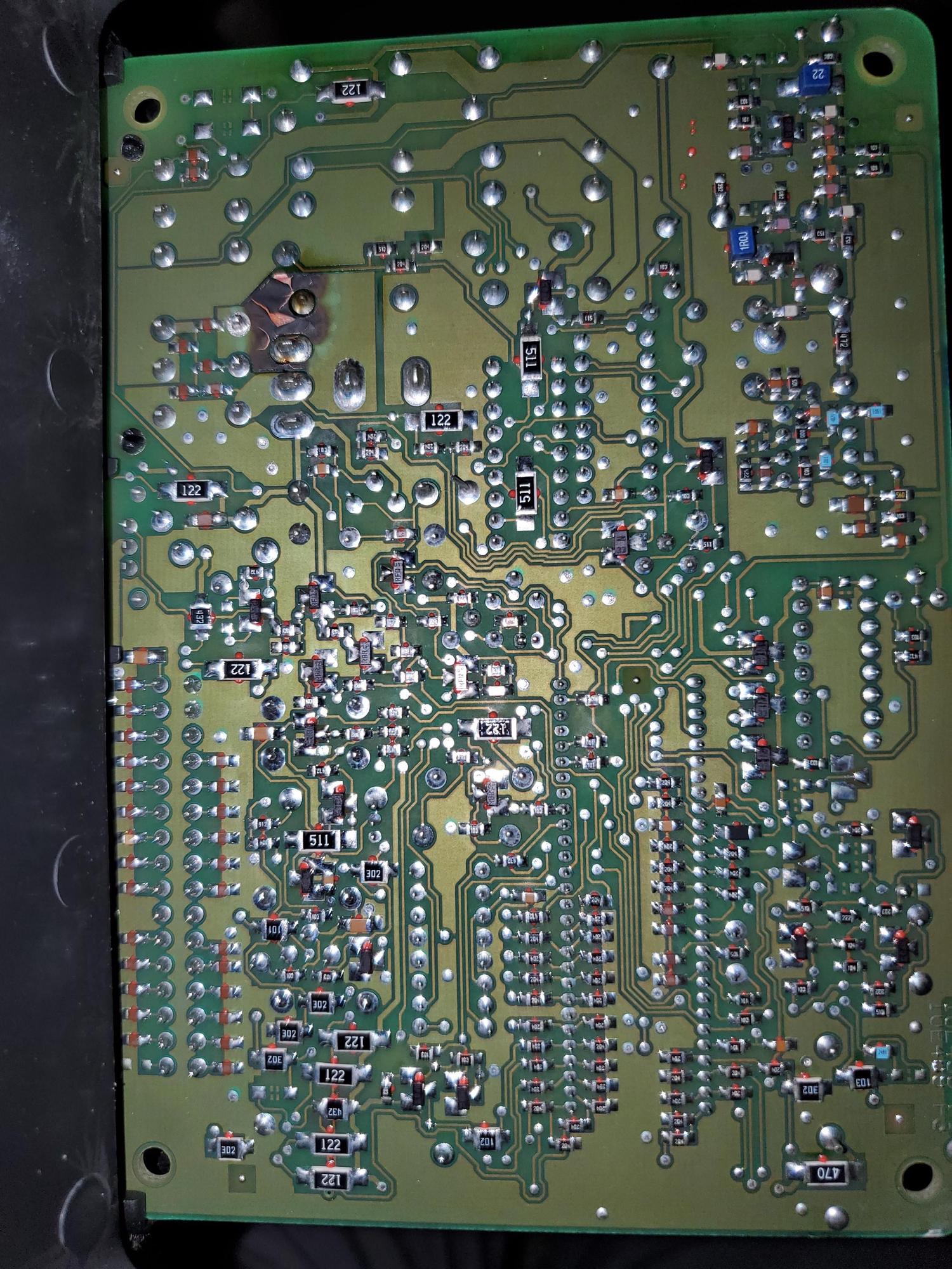

Just had a BCM problem creep up with my car. Was driving and all of a sudden I lost my radio and started to smell something burning. Then noticed my power windows wouldn't go down. (all else seems to work?) Circuits for radio and windows are fine. I pulled the BCM and found the smell. There's a burn mark under one of the relays. It must have somehow shorted out. I could not find any broken solder joints in this area. It's my luck that this happens just after the BCM's are discontinued.
Has anyone had any luck with the BCM repair services? There's an ebay seller named repair job that sells a repair service for these BCM's where you send in your unit for repair and it's sent back to you fixed for $95. Not sure if my unit is too far gone though. Might try it as it looks cheaper than a used BCM and I could maybe avoid the key issues if it works out.

The blackened area on the underside in your second photo is exactly where the bad solder joints cause the RAP circuit failure which affects the radio and windows.
