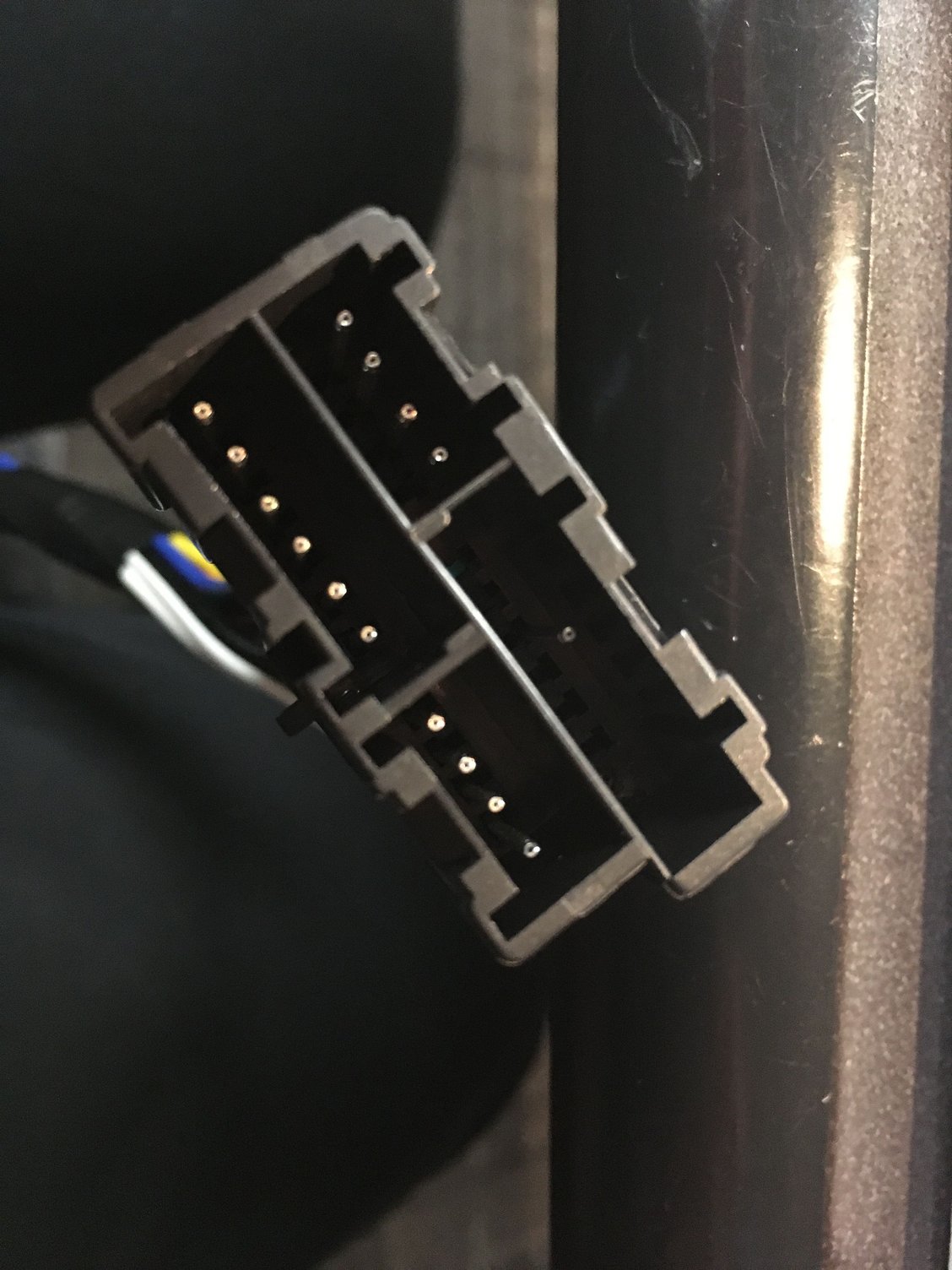

So, using a lot of information Whitebird was awesome enough to supply on the forum, I made an a harness that allows me to plug into the car harness without cutting it so that I can control when the power antenna goes up and does not go up. I was hoping maybe this might help someone else! Why do I want the antenna to go up if I'm using the iPod or CD changer? I had to add two missing wires in the Metra connector. Our monsoon radios use 15 pins, the two missing wires in the factory colors were the brown wire (pin 6 on C1) it tells you when the headlight switch gets turned on, and the dark blue wire for the steering wheel controls (pin 14 on C3). I used two (2) of the Metra 70-1858's because they were missing two wires/pins that are in the factory harness, and one (1) 71-1858-1 reverse wiring harness. On the 71-1858-1 there were 20 wires/pins and I removed the five (5) that are not used in the Trans Ams. I wondered if anybody had any thoughts or questions about this idea?

I'm not following the need for another harness or missing pins/wires. The Metra harness I have had all the needed wires/pins. I cut the pink antenna power wire and extended it to a switch to keep the antenna down. Then again, I have a Firebird and maybe you have something else.

Do you have the factory monsoon radio, or do you have a base Firebird ? And are you using the OEM GM radio or are you using an aftermarket radio? Apparently the two pins/wires that I added you only really need for the factory radio, none of the aftermarket radios use those two wires. And I made this whole harness because I didn't want to cut the pink wire like you did. My way was a lot more work. There's nothing wrong with your way, I just wanted something that was easily reversible if I didn't end up liking the mod.
